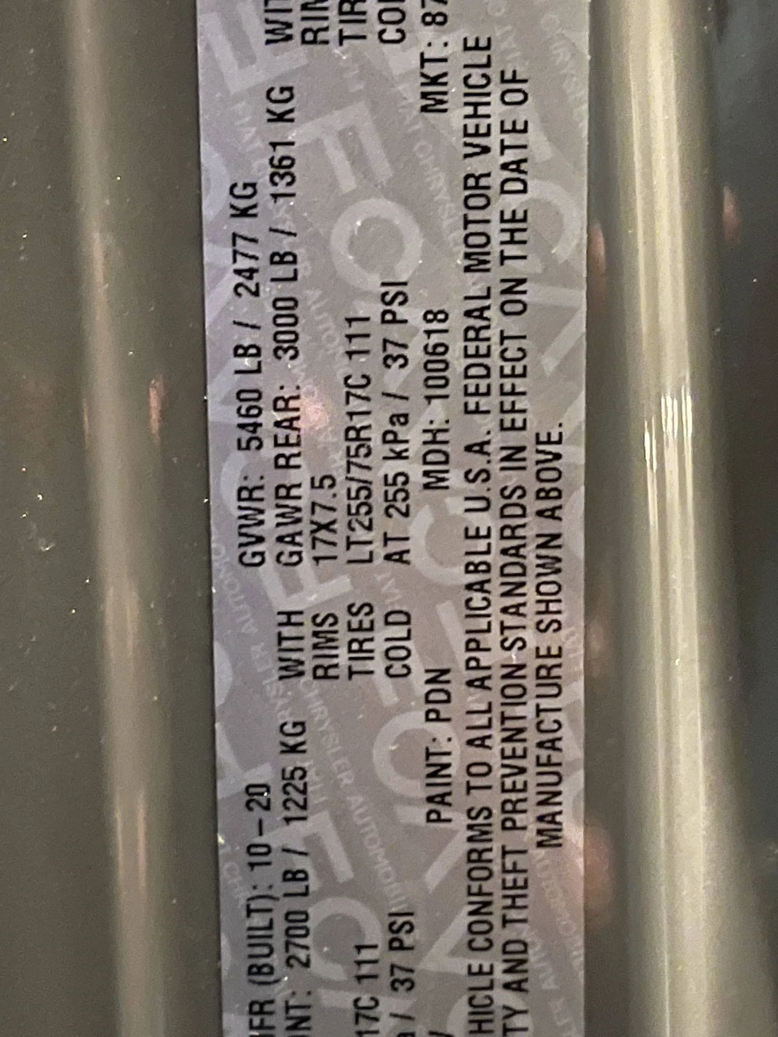

However, I just read a post on here about the sensors being different for anything built after June 2021. I don't know what the build date is on his JT
Look for the MDH info on the door sticker of the JT.
MDH =
Month
Day
Hour
In my example below....my MDH is 100618, meaning it was built October 06 at 18:00 (6:00 pm) Toledo time. My Willys is a 2021 model year, so you can also see that it was built October 2020.

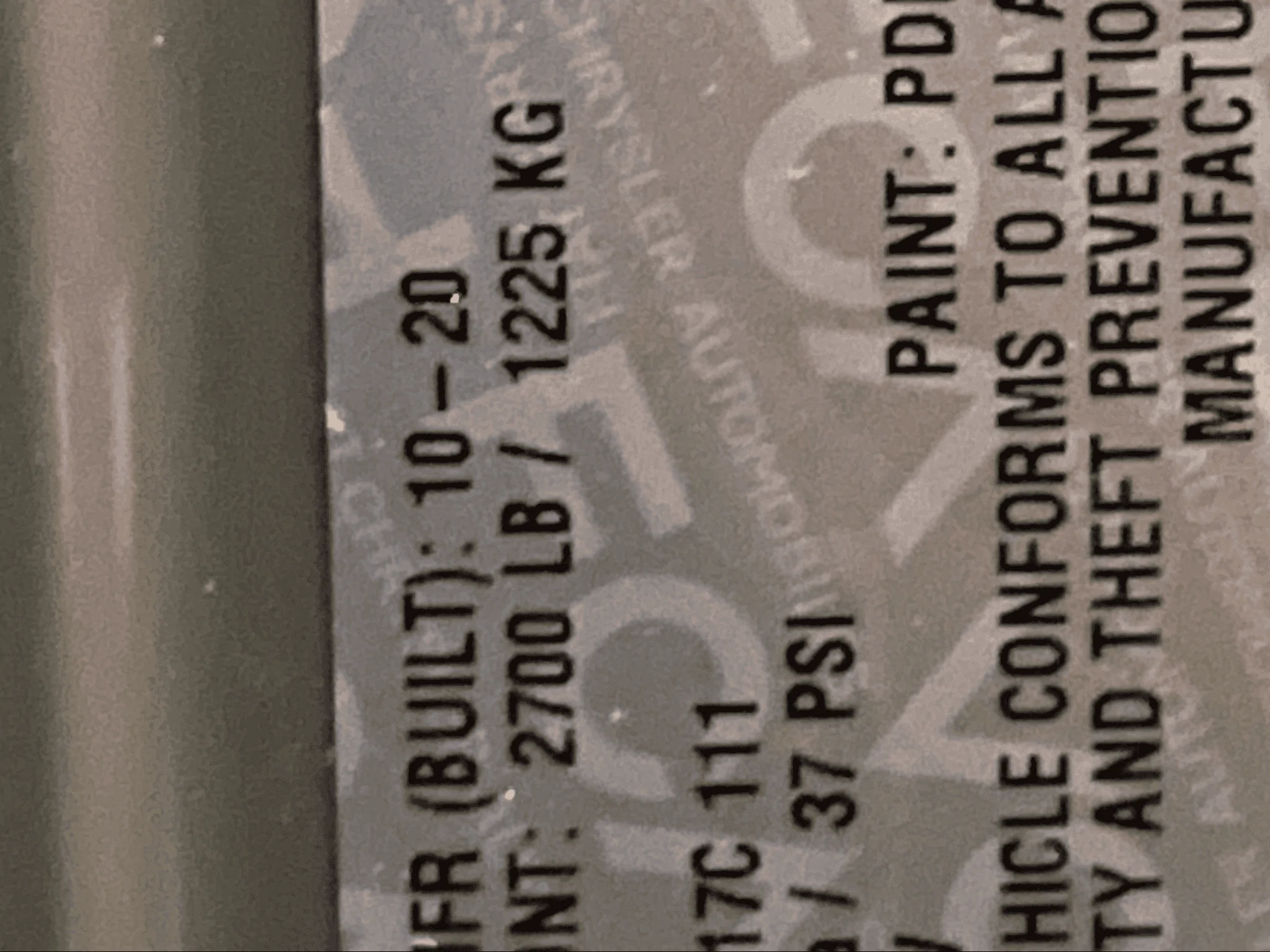

MDH =
Month
Day
Hour
So my JL has 010401 - it's a 2020 so that means Jan 4 2020?
gsbrockman
Greg
Nov 11, 2021
1,464
3,161
Sand Gap, KY
Sounds right; double check this part of the decal where it says “BUILT”
Jeep Wrangler JL TPMS reprogramming with 2021 wheels on a 2020 DBE58F10-6264-4040-9F7B-57145FF88739
to be sure.
