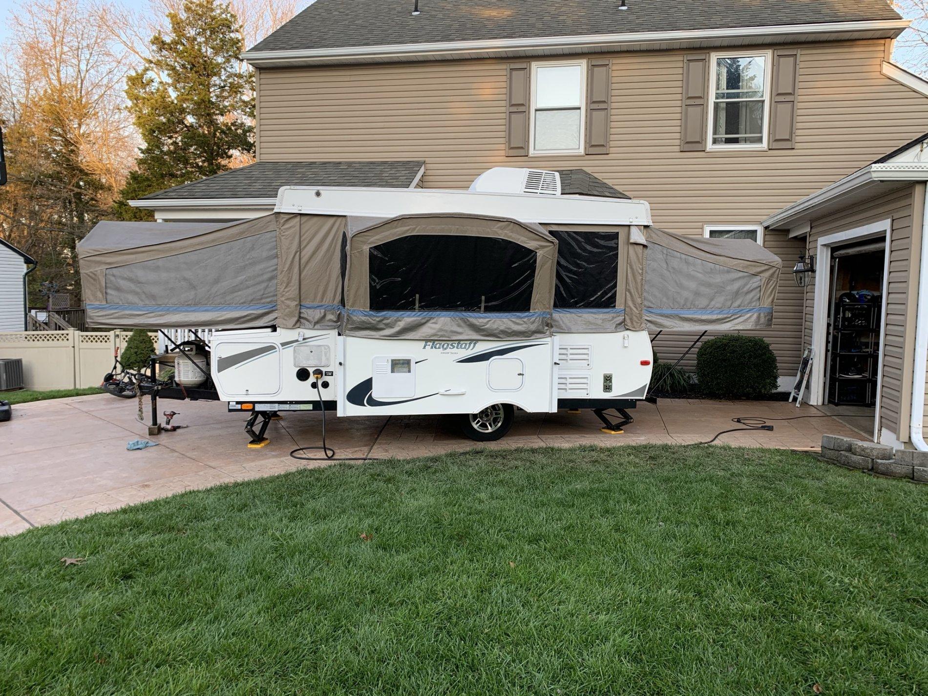

Hi everyone I have a 2020 jlu rubicon without the towing package. I recently purchased a flagstaff 425d pop up trailer that weighs 2500 pounds empty. I was wondering what weight distribution hitches anyone is using to tow something of similar weight, thanks
