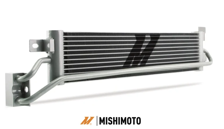

My Sport S equipped with tow package came with an external trans cooler.
I tow My Aliner approx 2800 pounds loaded. I installed a Mishimoto trans cooler to keep temps lower. The Mishimoto has approx 50% more volume, more surface area also.
I'm not affiliated with Mishimoto I was uneasy with the temps I was seeing.
I also installed an RpmExtreme Jeep JL - JT PWM Fan Controller. I,m very pleased with it.
I think it's been the most effective at keeping temps down.

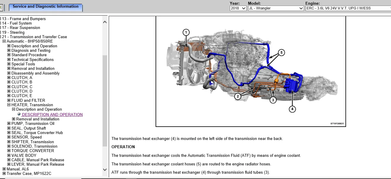

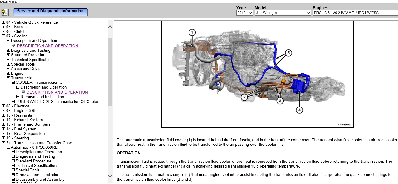

So looking at the service manual, the 'transmission heater' is a heat exchanger that uses coolant to cool it. And then separately there is the trans oil cooler at the front. @Jeep Junkie I just confirmed my 22 has this, it's tucked in there exactly where this diagram shows. It is not 'built in to the radiator.' Mine did not come with tow package.
🤩👍 how do I confirm that mine also has it?
On the same side as the front driveshaft, there is a coolant to ATF heat exchanger. Up in front of the condenser at the top, is a regular air-oil heat exchanger for the ATF.
Will crawl under my Jeep tomorrow 🤩👍
