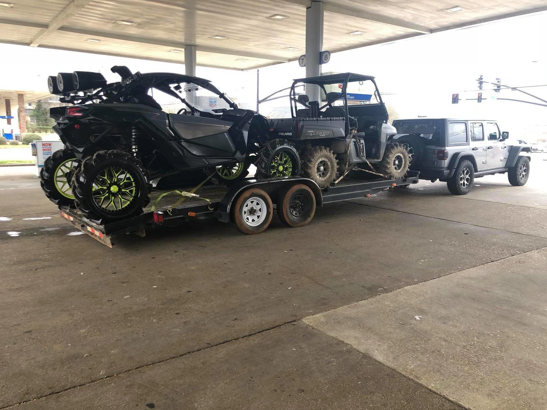

This guy on a Facebook JL group overloaded the shit out of his and stated it towed fine. Despite having a massive buttload of tongue weight. lol

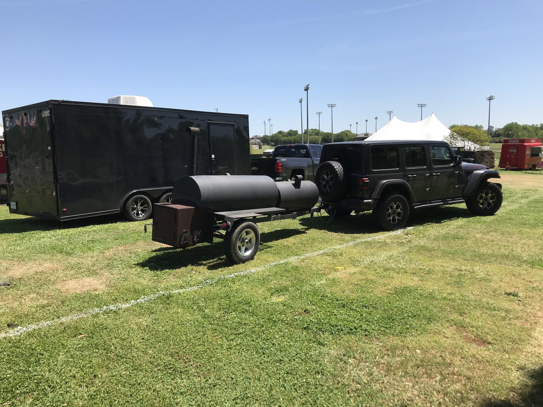

No issues here either. Our smoker weighs around 1800 (1/2 inch steel) but the tongue weight is high. You can tell its back there when doing hills etc but ran just fine
That backend is really squatting! How much weight do you think that is?
