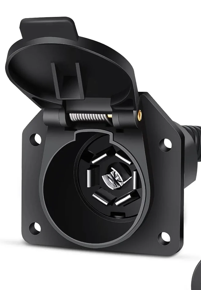

If the trailer plug at the hitch is a 4 pin flat connector, it Cannot have trailer brakes. There simply are not enough pins/wires. To have brakes, the connector will be a 7 pin round (6 pins in a circle and a center pin) as shown below:

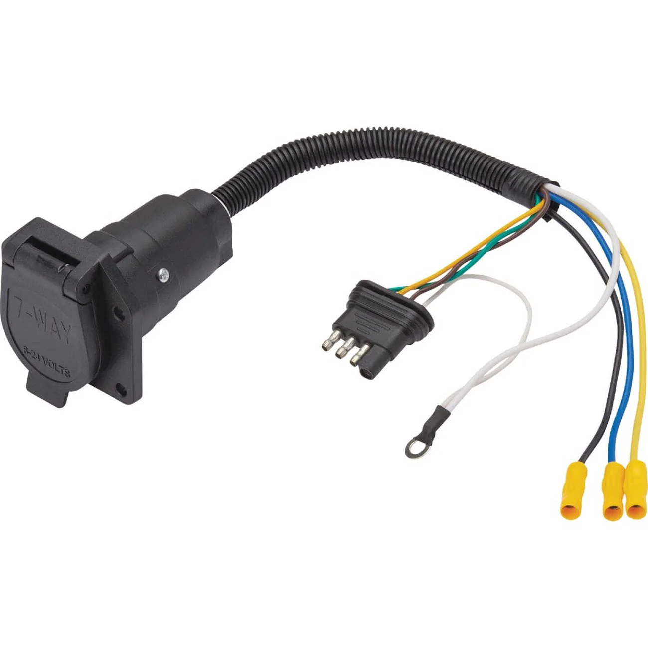

A 4-flat to 7-pin adapter will, when wired to the vehicle correctly, provide the necessary power for trailer brakes and auxiliary power.

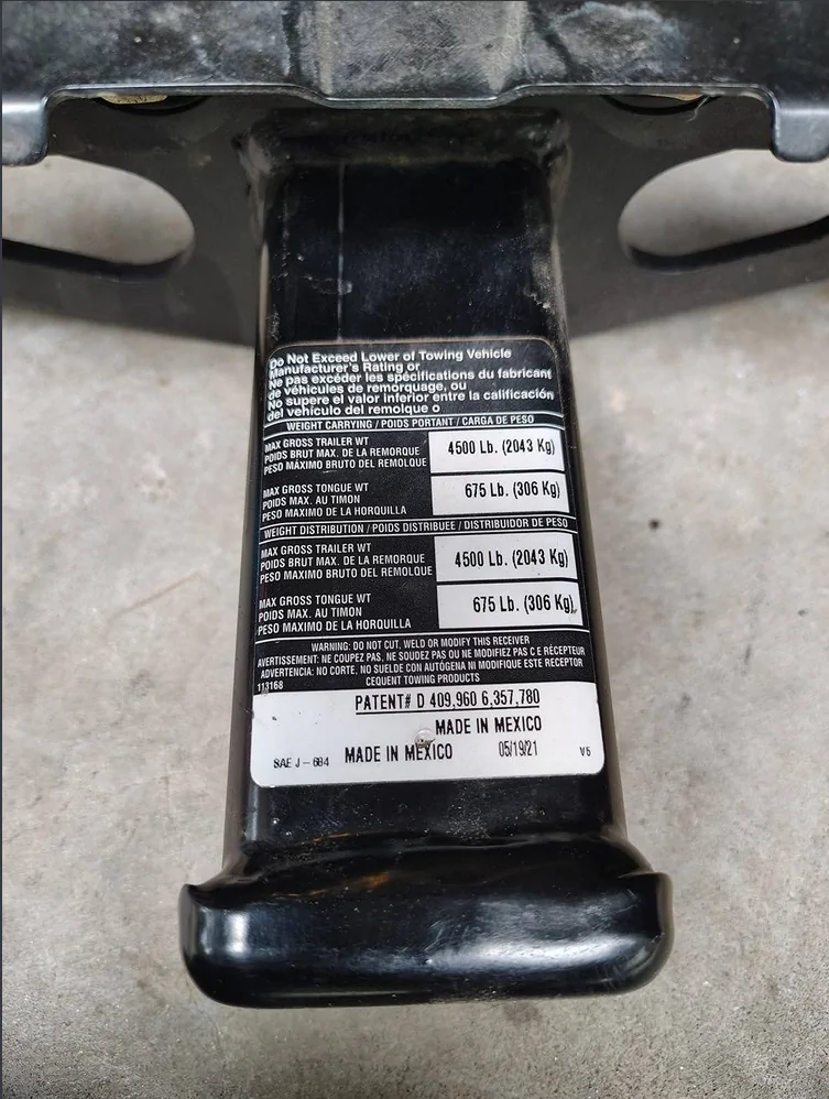

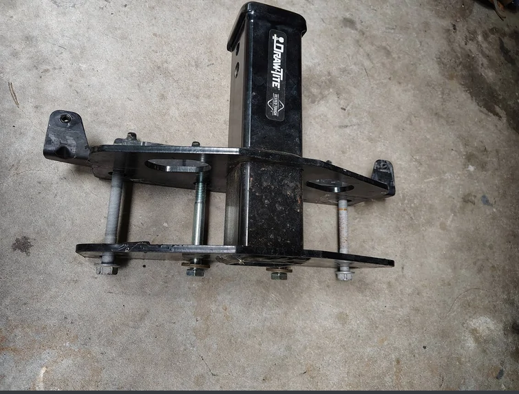

The receiver hitches are Class II on both the two- and four-door Wranglers.
Only the factory hitch. Both Curt and Draw Tite make Class 3 receivers, with 500 and 675 tongue respectively. Great for cargo and bike racks.
@Melly71 if you pay shipping I'll give you the Draw Tite I have sitting in the garage, would be a big step up from whatever you have on there.
