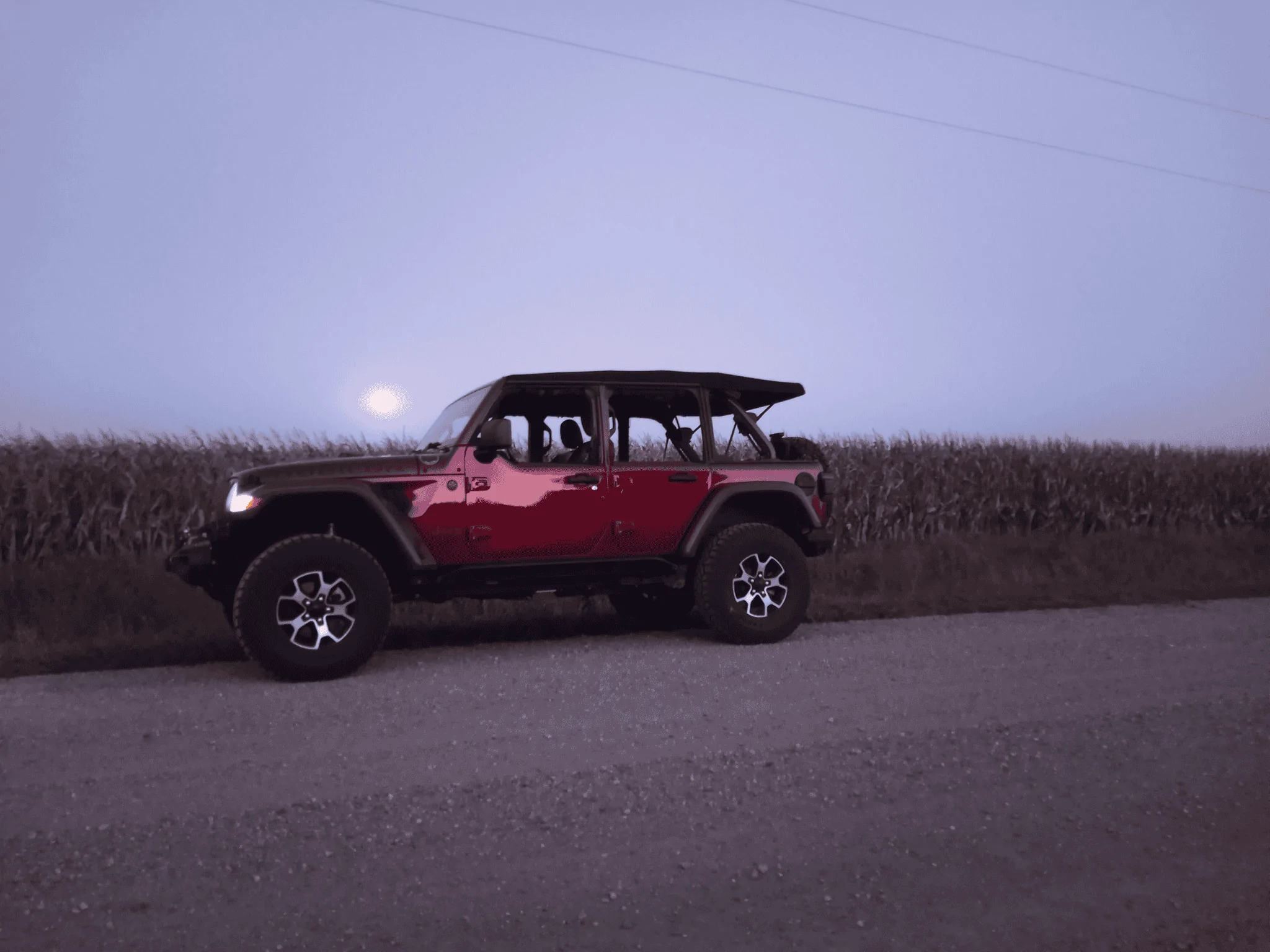

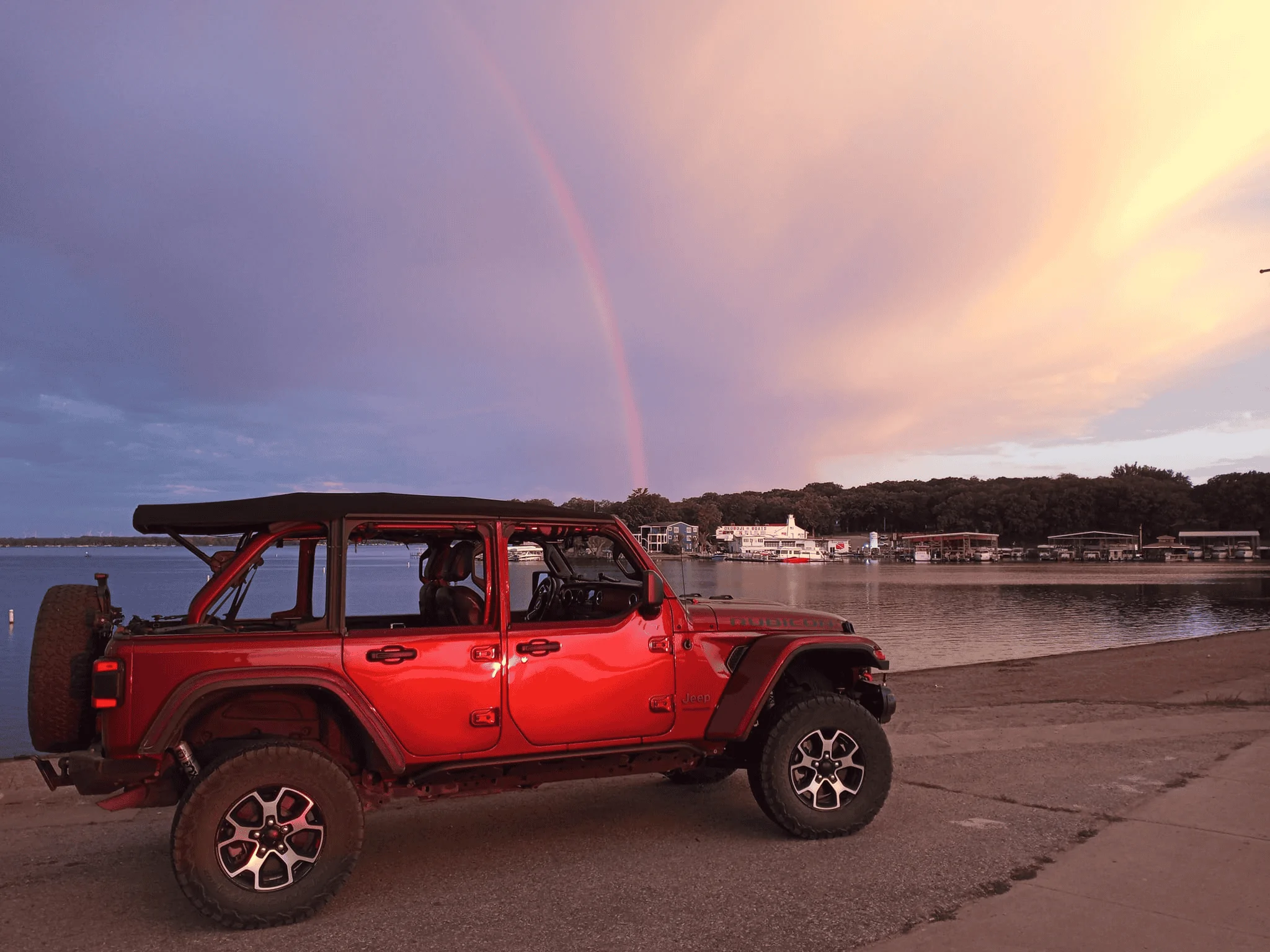

Keep in mind, actual sprung size/height vs what the companies state. Go 35, you might see 34 once on the ground. My stock spare carrier handles a 35X10.5 just fine. The last pic is with "stated" 33 vs 35 & about 2.5" of lift. Adding 2 pics for you to compare. The rainbow pic is w/ the stock 33's and the moon pic is with the new 35's. BOTH are w/ the approx 2.5" lift.

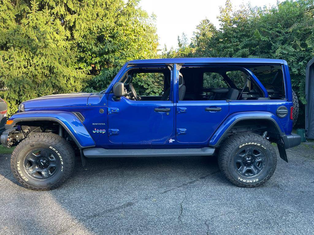

I'm running 285/70 r17s (stock rubi size, so close to 33s) on my Sahara with a 2.5 lift - in case the visual helps:

Yup - stock sizes with 2.5in lift look funky and you have to be comfortable with the looks. Hence my posting my pic to make sure OP is ok with the appearance before committing $$$ ;)
