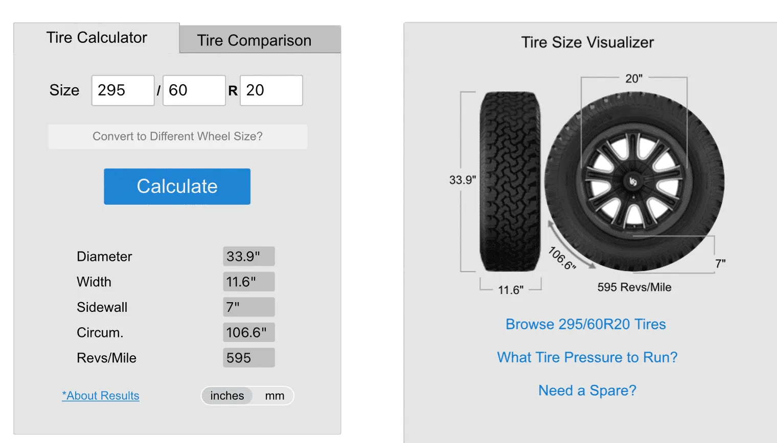

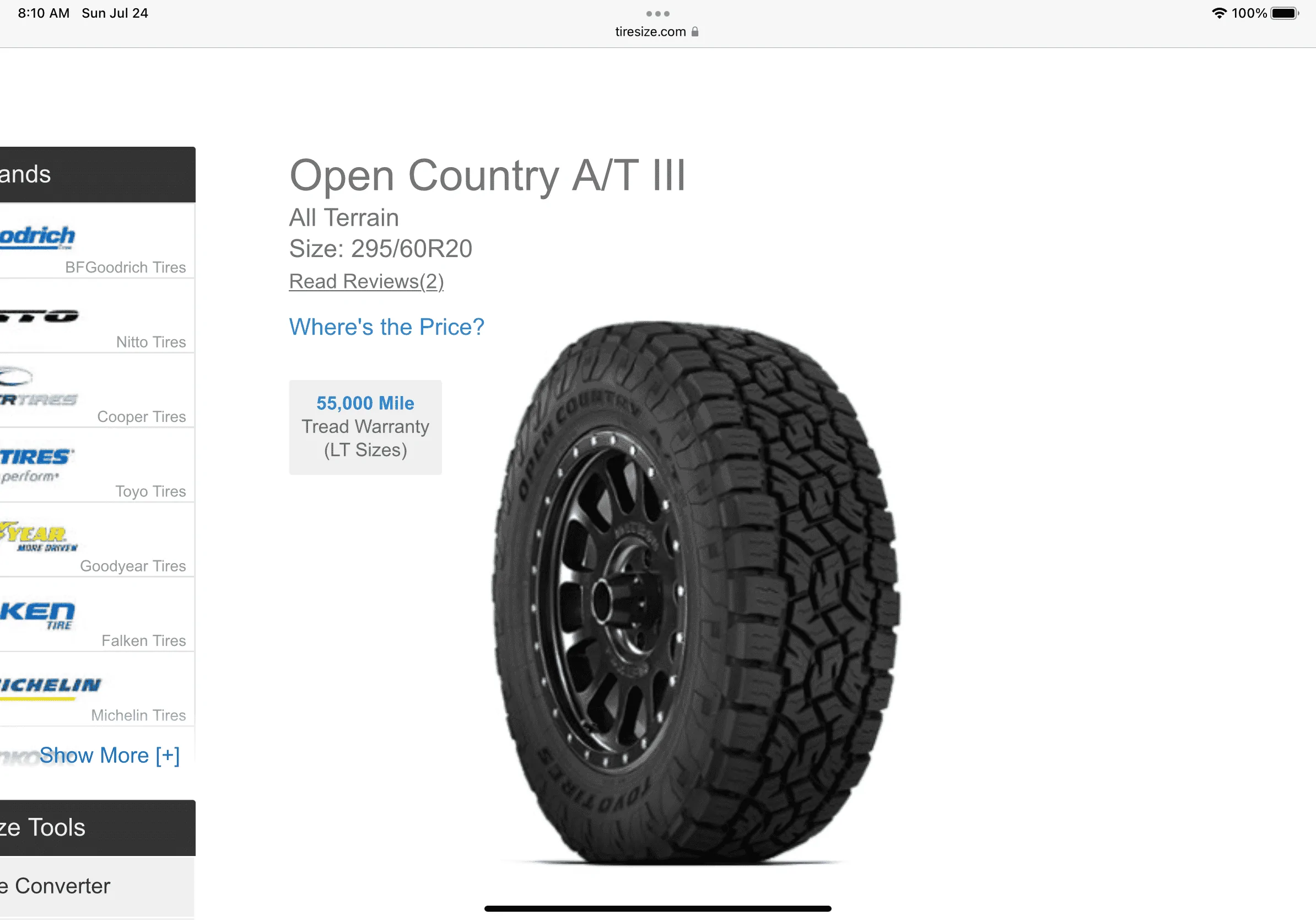

In the exact same position and Looking at these for my 4xe Sahara HA….I have read some really good reviews on road noise, wear and drive-ability.
Jeep Wrangler JL Tire replacement advice - 4xe Sahara 1658668565923
Jeep Wrangler JL Tire replacement advice - 4xe Sahara 1658668612236
Jeep Wrangler JL Tire replacement advice - 4xe Sahara 1658668426158

I swapped from BFG KO2 to the Toyo AT III. I’m happy with the switch, good on the rain, snow rated, quiet, etc. Most happy that they don’t throw rocks like the KO2. The KO2 does have a slightly more aggressive look though.
