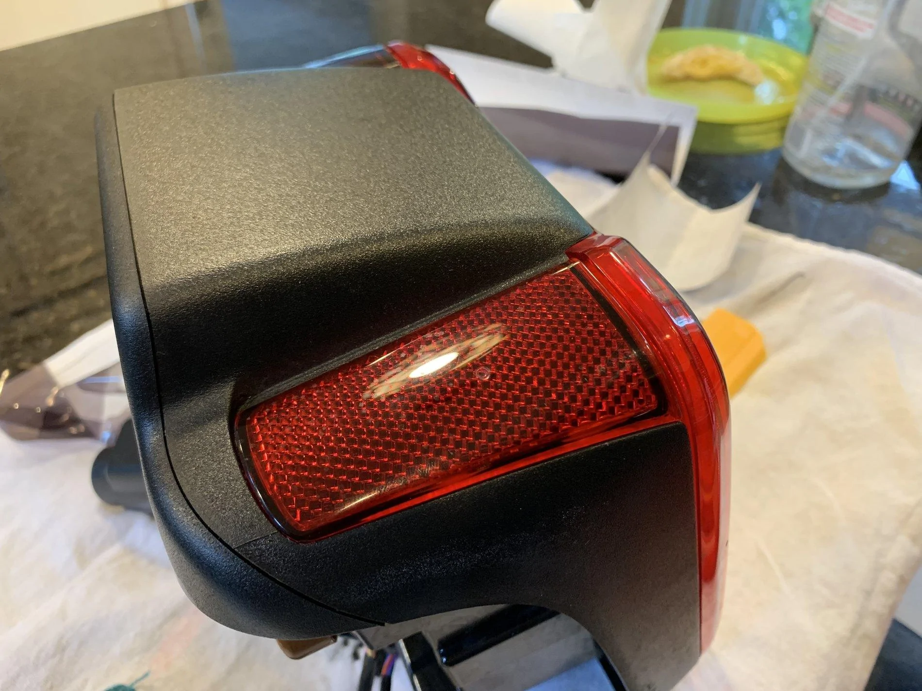

I started by removing the tail lights from the fenders and really cleaning the lenses:

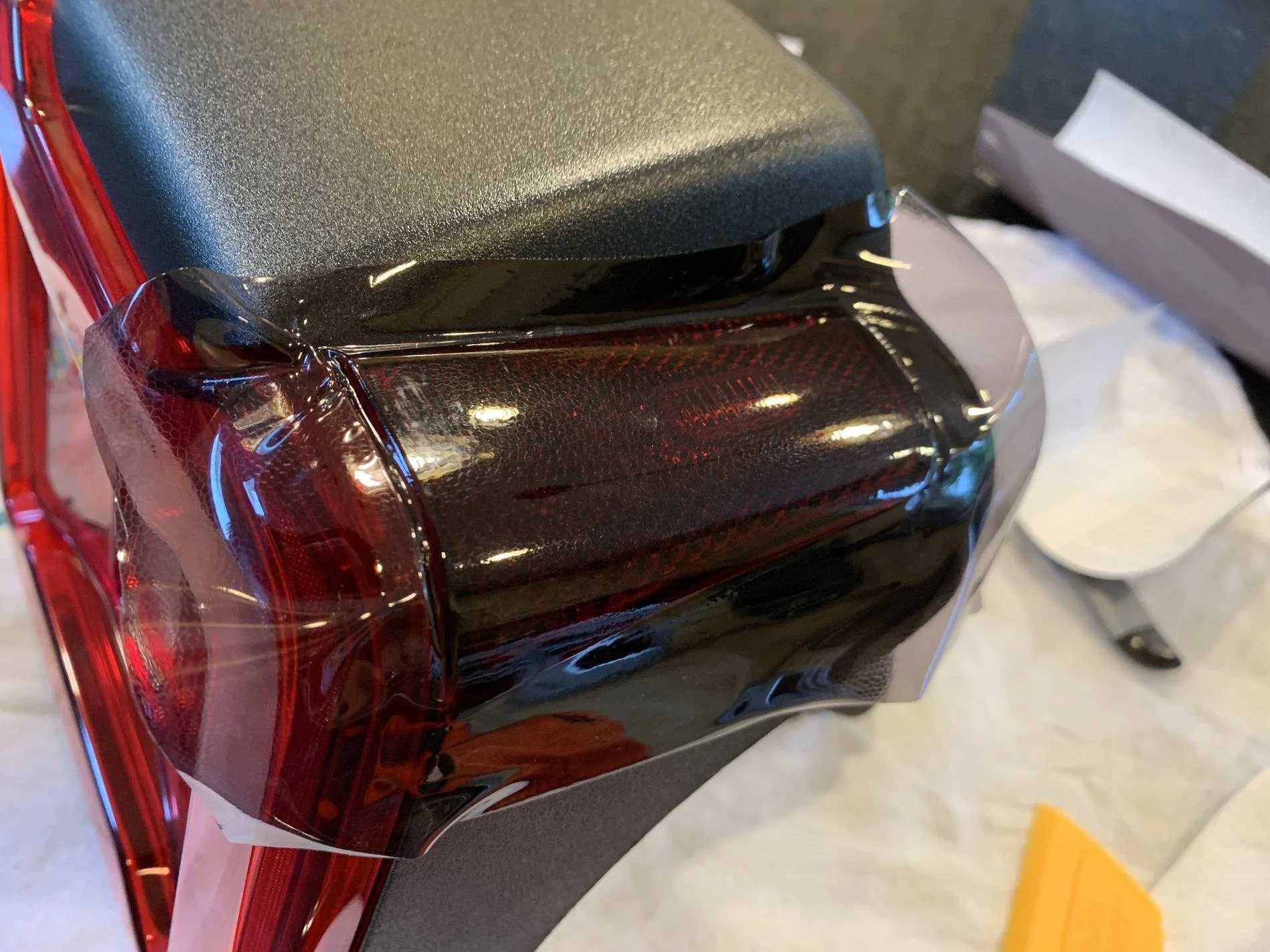

I cut enough off the tint roll to cover the lens with some to spare, placed it on the lens and used a heat gun to shrink the tint to fit.
Jeep Wrangler JL Tinting Rear Marker Lights 20190602_121302791_iOS
A little exacto knife magic and I removed any excess.
