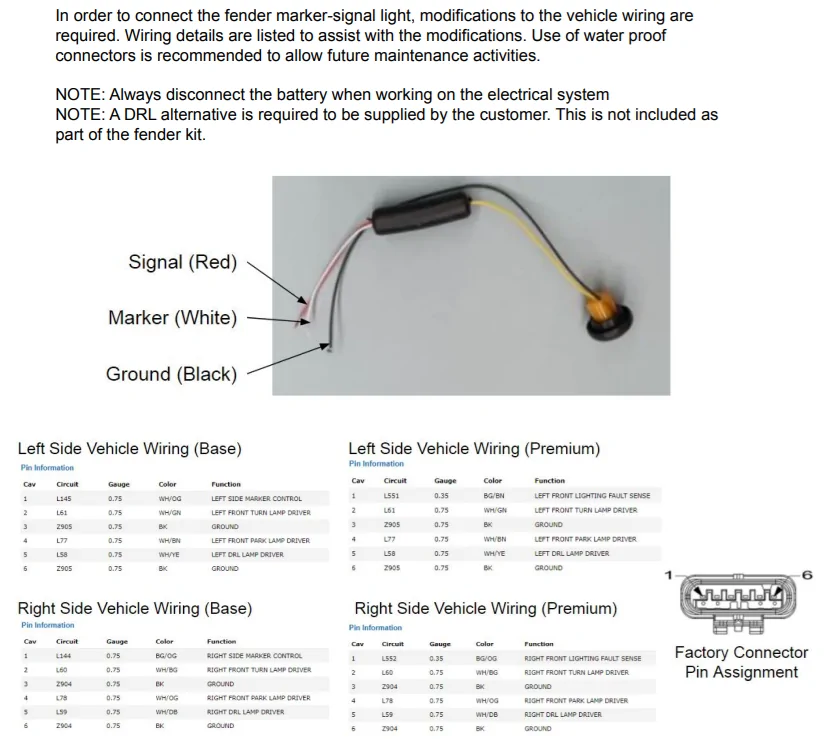

Electrical has always been a dark science to me, so before I start hacking and cutting things up, I figured I'd come here.
I just picked up the Combat-Offroad aluminum front fenders. They include a small round LED to function as the marker/turn signal. I can't for the life of me figure out how to wire these in though! I have a 2021 Willys with halogen lights in the fenders.
https://combat-offroad.com/collections/2018-jeep-wrangler-jl-jlu/products/combat-fenders-jeep-jl
From this, you can see I have 3 wires off the new light (Red, White, Black). I have the base wiring. How do I connect 3 wires with the 6 on the harness?
