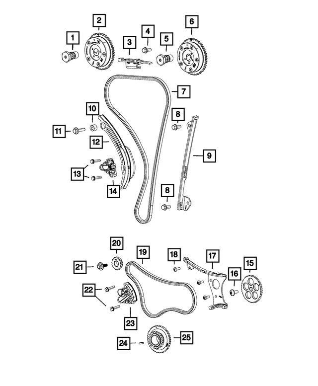

Its a timing chain (part number 7 below). In fact there's 2 chains in the cover, the main timing chain and another one to drive the oil pump (part 19). If you are replacing one, its probably a good idea to do both.

I agree with @longfiredragon on this one. Typically timing belts have to be replaced every 100-120k miles but steel timing chains usually lasts much longer than that. 250k+ easily. The chain does stretch over time but its very small and the tensioners make up for that stretch. Usually the factory service manual should spell out a spec for them (e.g. if it stretched beyond XX mm or if the tensioner is maxed out ), then you'll have to replace them. However this is usually far beyond 80k.
I'm not aware of how hard the replacement is since there is a lot of crap bolted on this engine. In inline-4 cars i've worked on in the past, you can usually remove the cam cover and do the chain replacement without pulling the engine assembly from the car. Usually when replacing the chain, you replace the tensioners, guides and idlers as well since you are already in there.
