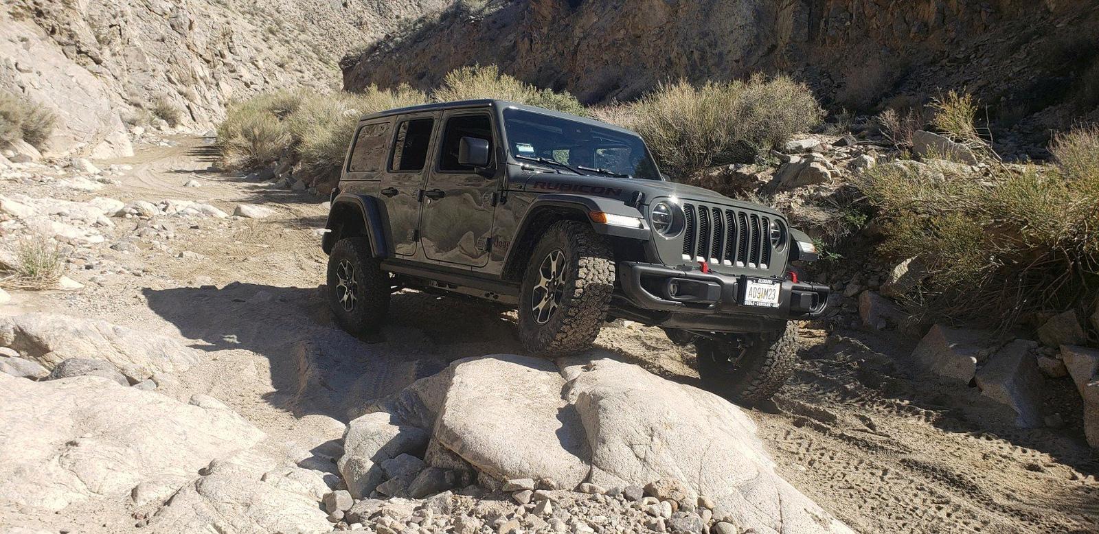

Our first trip with the Stock Jeep
Jeep Wrangler JL The "Toy" JL Build 32471810977_98dda17fcf_h

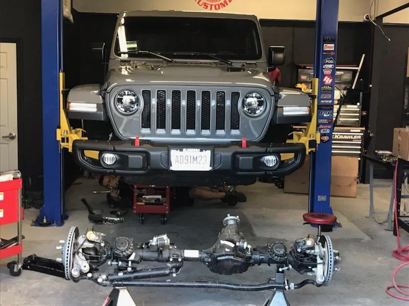

Work Begins.
Jeep Wrangler JL The "Toy" JL Build 33544959688_f801e08abb_c

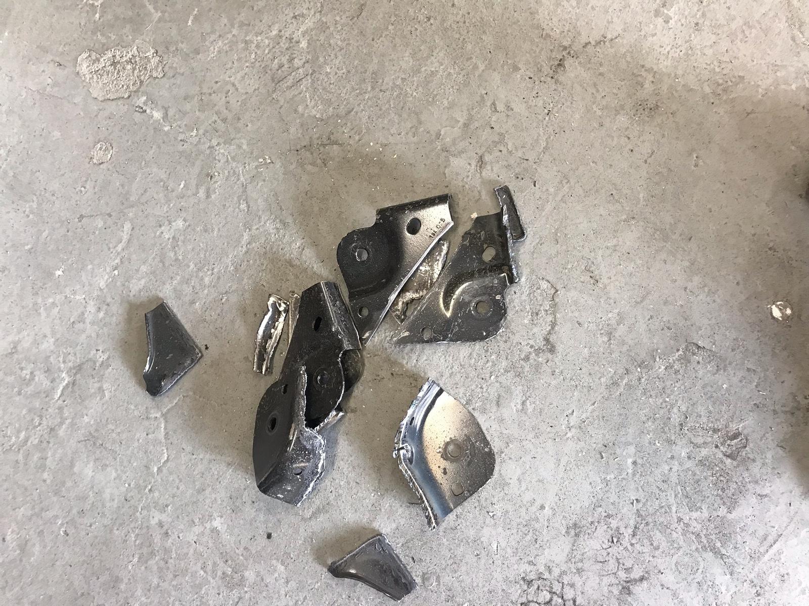

Cutting off Stock Brackets.
Jeep Wrangler JL The "Toy" JL Build 46515427675_7b44011e35_h

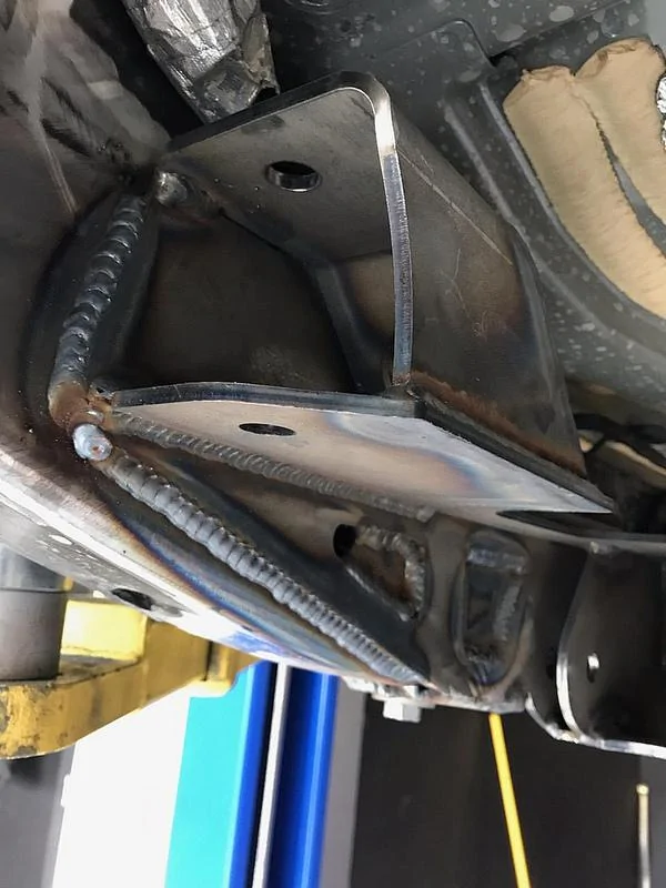

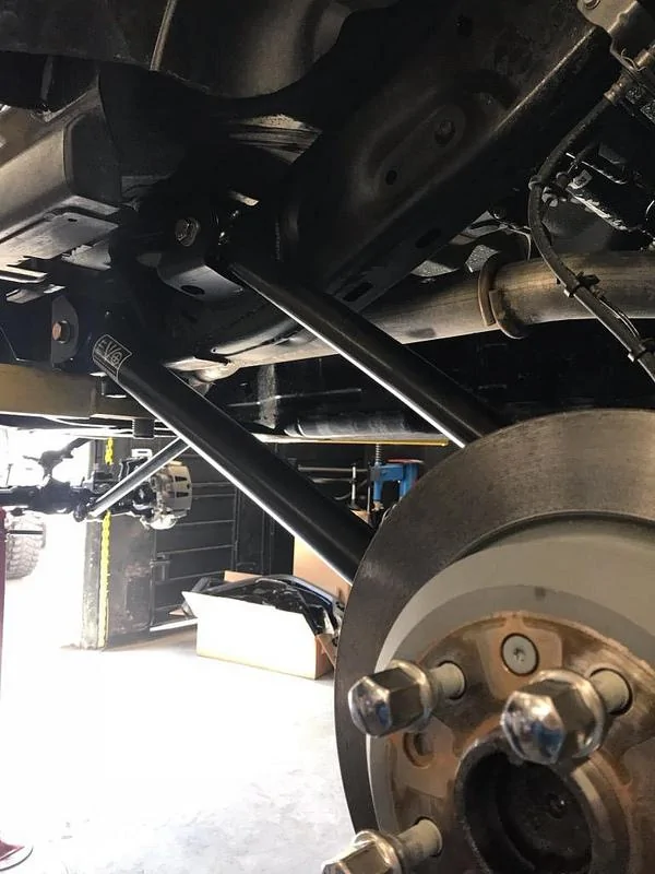

Burning on the New EVO Brackets
Jeep Wrangler JL The "Toy" JL Build 32488766317_0284ef8066_c
Jeep Wrangler JL The "Toy" JL Build 46720367094_1024d6d06c_c

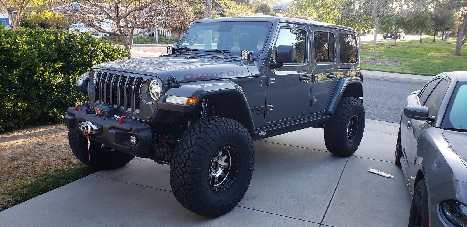

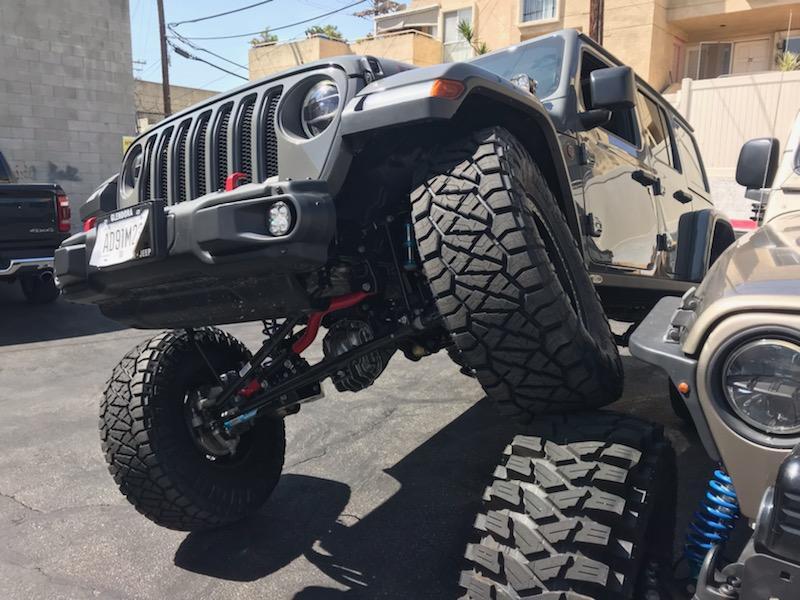

and the Finished Product
Jeep Wrangler JL The "Toy" JL Build 46578681065_3c8cce05d5_b
Jeep Wrangler JL The "Toy" JL Build 40528022813_05277b572c_c
At Home in the Driveway
Jeep Wrangler JL The "Toy" JL Build 46770514794_8d84b3c9f2_h
Jeep Wrangler JL The "Toy" JL Build 46770514944_134b65c668_c
Jeep Wrangler JL The "Toy" JL Build 46580186435_70b27b2ce2_b
