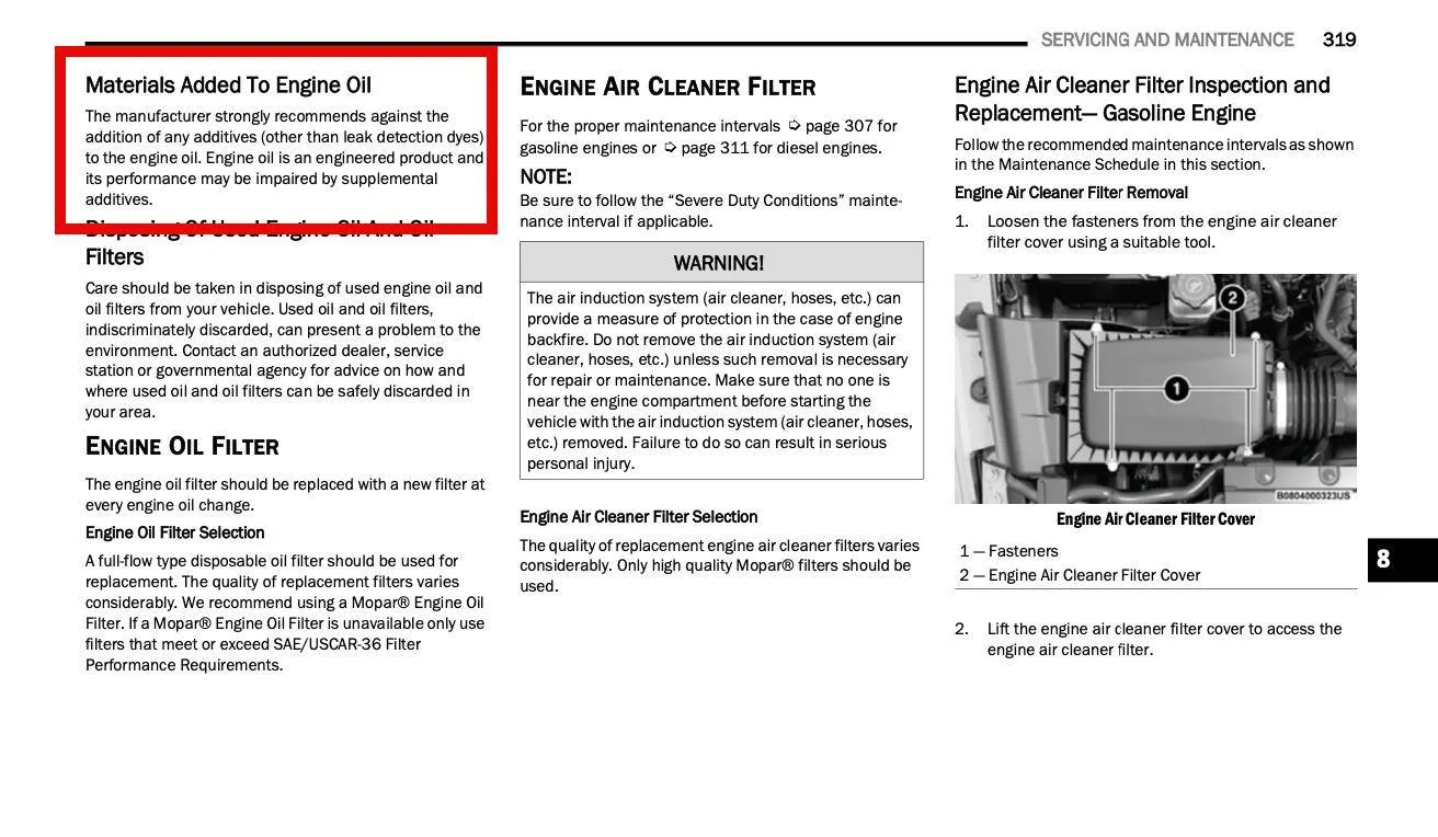

Is there any evidence that suggests the initial fill is anything other than regular motor oil? It's unusual for a vehicle to come with break-in oil and there are typically strong recommendations to change it at a very early interval. I'm not seeing that anywhere in Stellantis' literature.
As far as oil additives are concerned, I'm sure you are aware of the manufacturer's recommendations against using additives:
