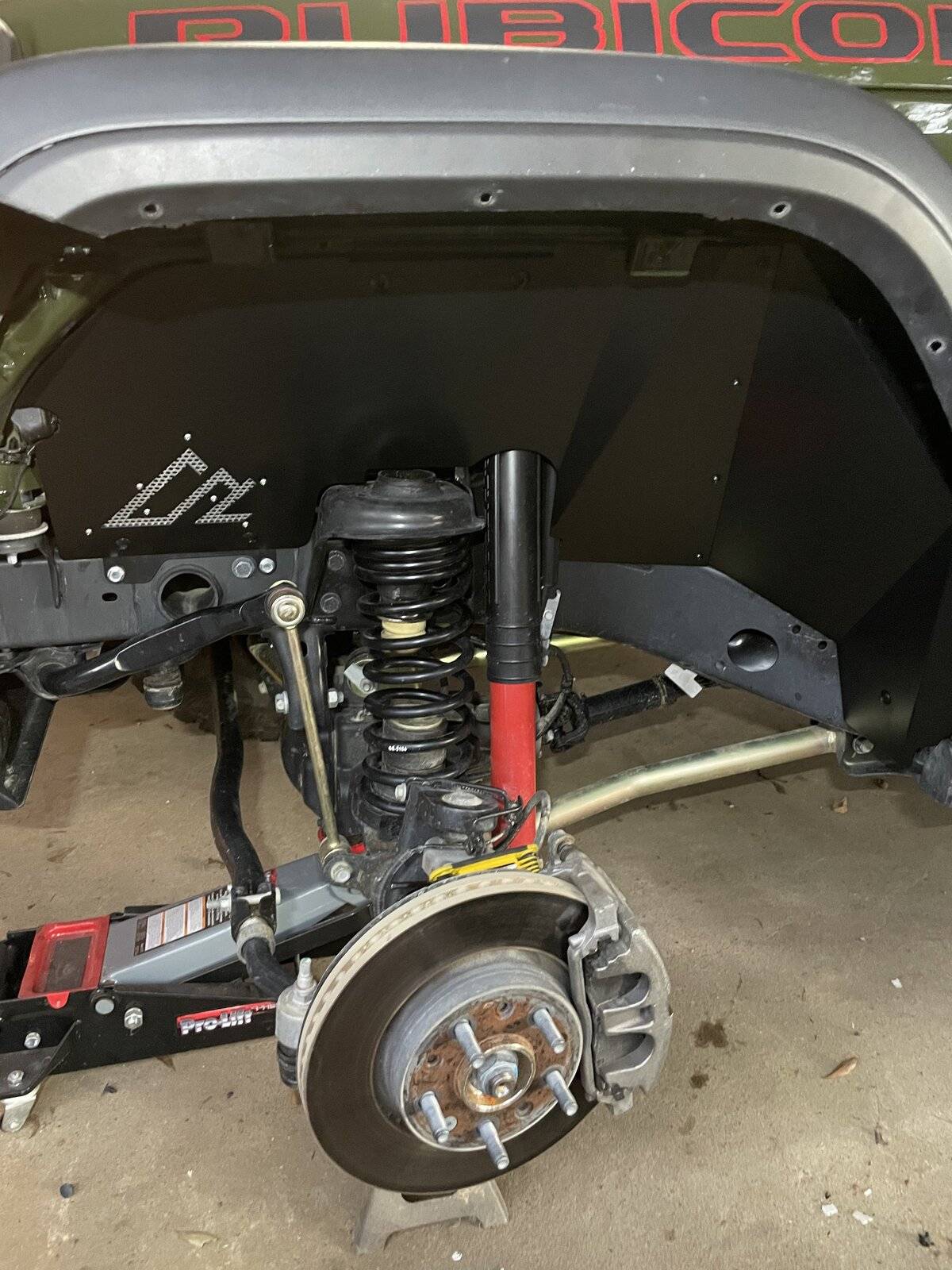

Are those the the Rock Sport shocks from Metalcloak?
How would you compare the ride quality to the stock Rubicon ride? Is it firmer, softer, similar?
I am considering Metalcloak, but I don't want a ride firmer than a stock Rubicon. Do you get spring squeak like I have heard on some youtube videos? (unknown brand).
Thanks,
no spring noises at all. Even Offroad. I would get the Metalcloak spring correction pad (or rock krawler) to prevent possible spring bowing. Not all do it and it’s common with any brand spring on the JL. (Front springs). The correction pads might be why I don’t have spring noise.
Yes they are rock sports. ride feels better. I’m running around 30psi in the tires. The springs are dual rate. So it’s softer when it comes to the ride but more firm for body roll in cornering. I think it’s an improvement in ride considering how much taller the Jeep is.

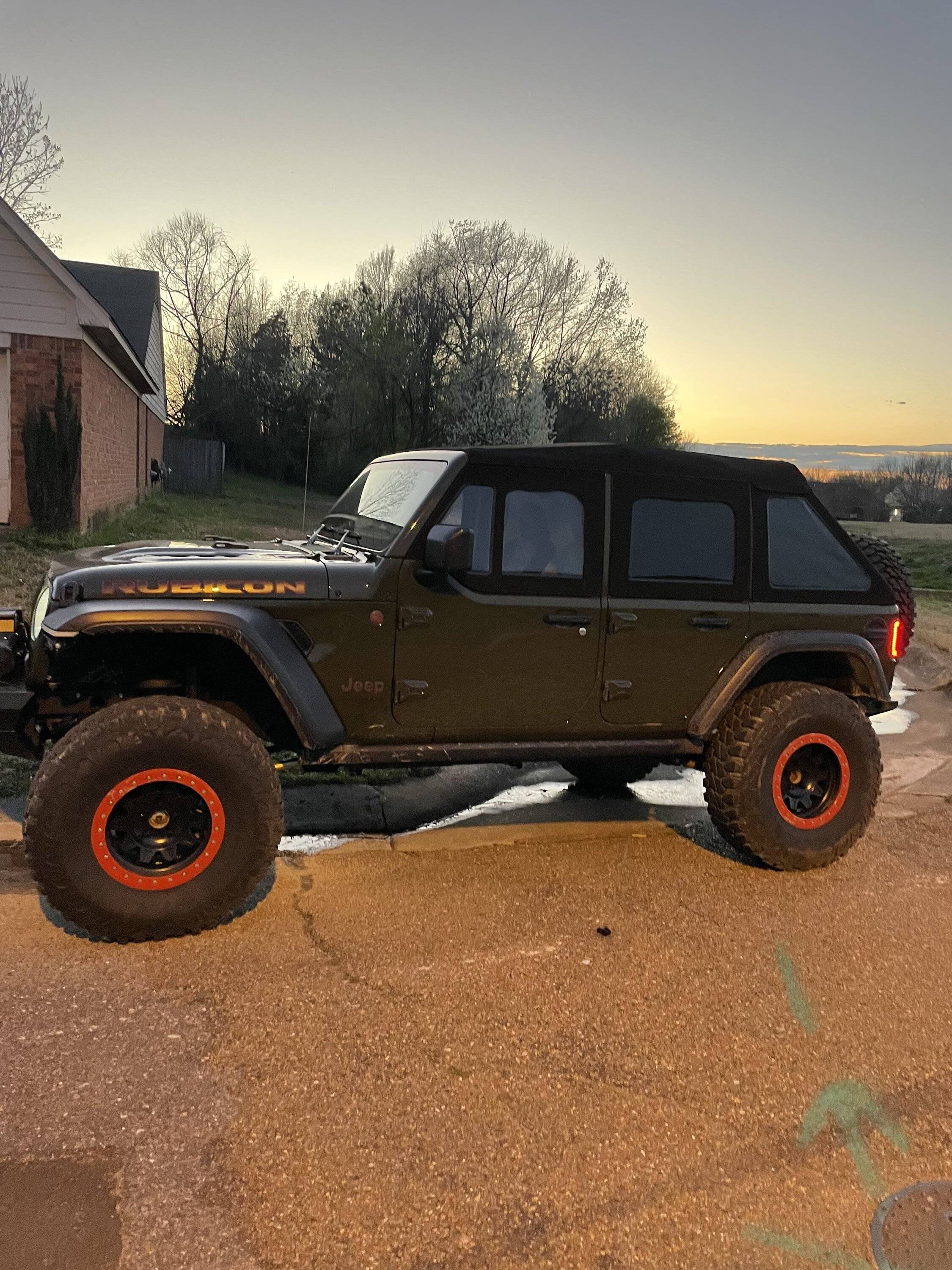

I think I’m definitely leaning towards a spare tire delete now that I have the slant back top. But that’s based on this pic of the Jeep on the lift lol. I’ll wait until I see it in person Friday to seriously consider it. Lol.
