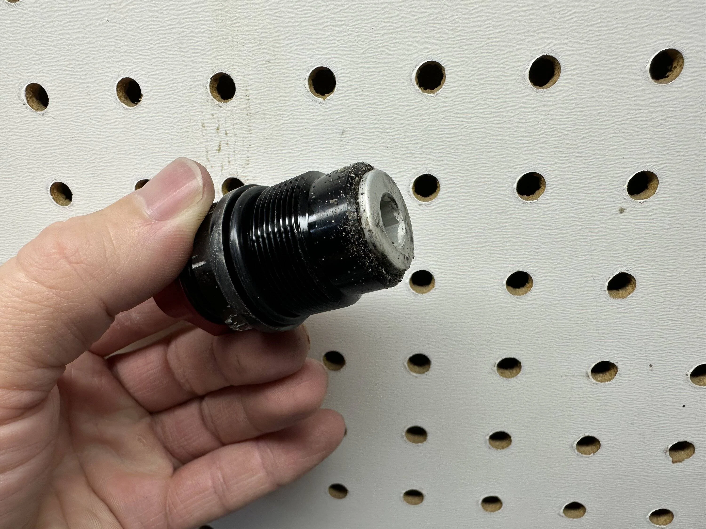

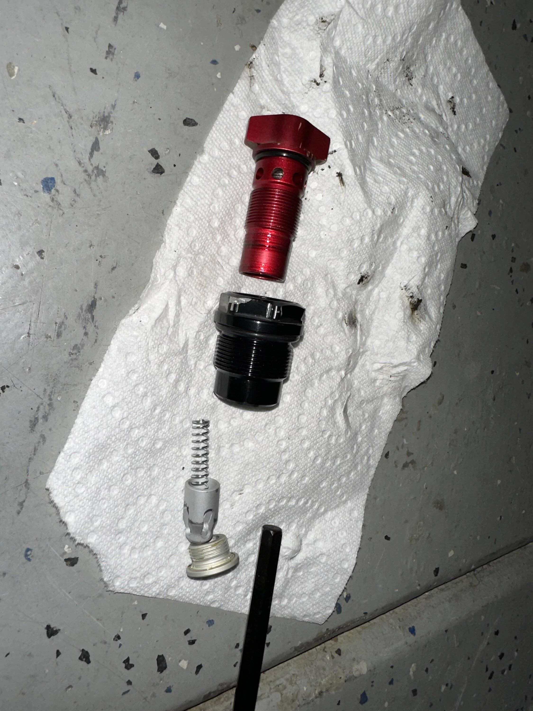

So I took out the two bad valves and took them apart. Not overly dirty, but both had some grit on the surface inside the tire. I wiped and blew everything off, and both valves worked to 18 psi.. so, not a terrible fix, since you can unscrew the valves from outside the wheel and you don’t have to break a bead or anything crazy like that.
I just hope this isn’t a recurring theme, maybe just some leftover crap inside the tires I bought used.
what stops the air is that silver plunger at the bottom, mating to the silver screw/plug on the inside. It’s just metal to metal surface, no seal, so I’m not surprised these don’t completely stop air coming out when they’ve reached their set pressure.
