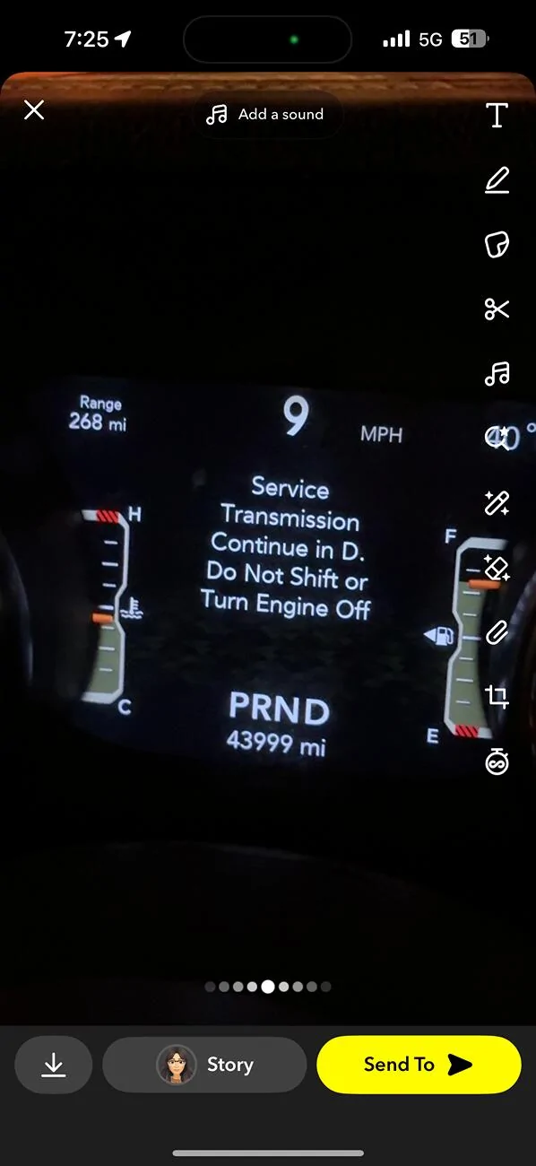

My wrangler broke down and was found to have a bad TCM. That is built into the valve body. Replaced valve body/TCM. Immediately upon starting jeep, part broke again before even driving. Dealers stumped. 2 inch mopar lift, 35” tires, z automotive tazer that now can’t be unmarried because no access to dash. No other aftermarket parts. Tazer set to change tire size, TPMS, hood alarm, and backup cam with turn signal. Been installed for 2.5 years. 44k miles. Any leads?

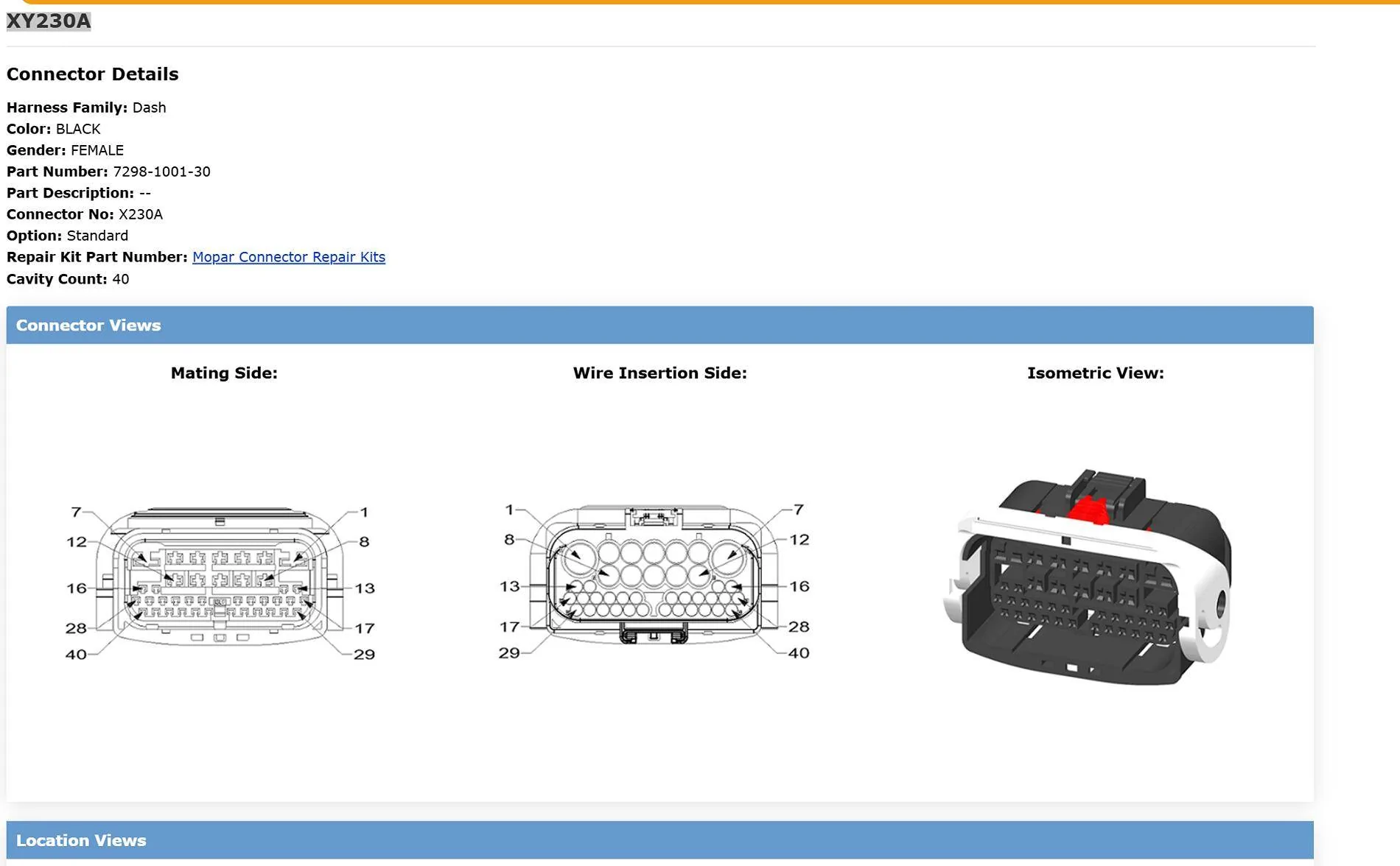

Known issue. Behind the right front fender liner there is a connector along the firewall. Inside this connector there are two can-bus wires in addition to the power and ground for the TCM. You need to just bypass this connector and wire it directly around it. This connector is only disconnected for cab-off service, so hard wiring it isn't a real issue.
One or more of the pins have a bad crimp/connection. Usually it's either the power or ground wire, but I do all 4 when I get one in for repair. There is a thread on these forums with the wiring diagrams if you'd like to attempt the repair yourself, it's very easy.
As this is a electrical wiring repair, it isn't covered outside of the 3 year/36k warranty. Your dealer however might cover it due to the improper diagnosis.
The connector number is:
XY230A
