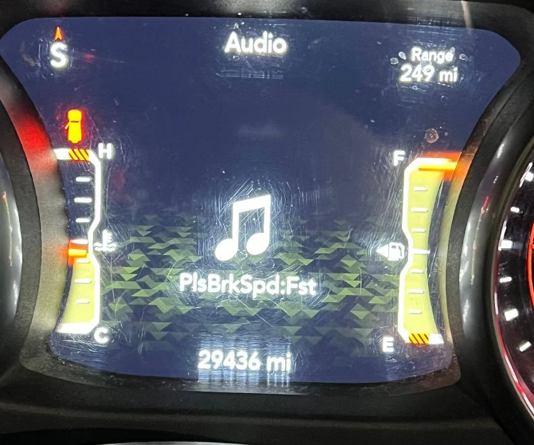

I got my (2018/3.6) JL back yesterday from a dealer visit; unmarried prior to. Vehicle settings are back to where I originally set them & I did the sleep cycles after marrying yesterday, but nothing I've done will get the PlsBrk live setting to work. In the past this would always work after I had to unmarry, or even if I randomly changed the slow/med/fast pulse settings.
This is the current setting, but it ain't pulsing. It won't seem to change from 'off.'
What could I be missing.............?

You can unmarry the tazer and do a restore through the zautomotive software. That will bring you back to stock and start you over, but should resolve the issue.

Hey, Dan.... I didn't realize that was an option. Found it the 'fix my tazer' on the site.
Problem sorted.... thank you.................
