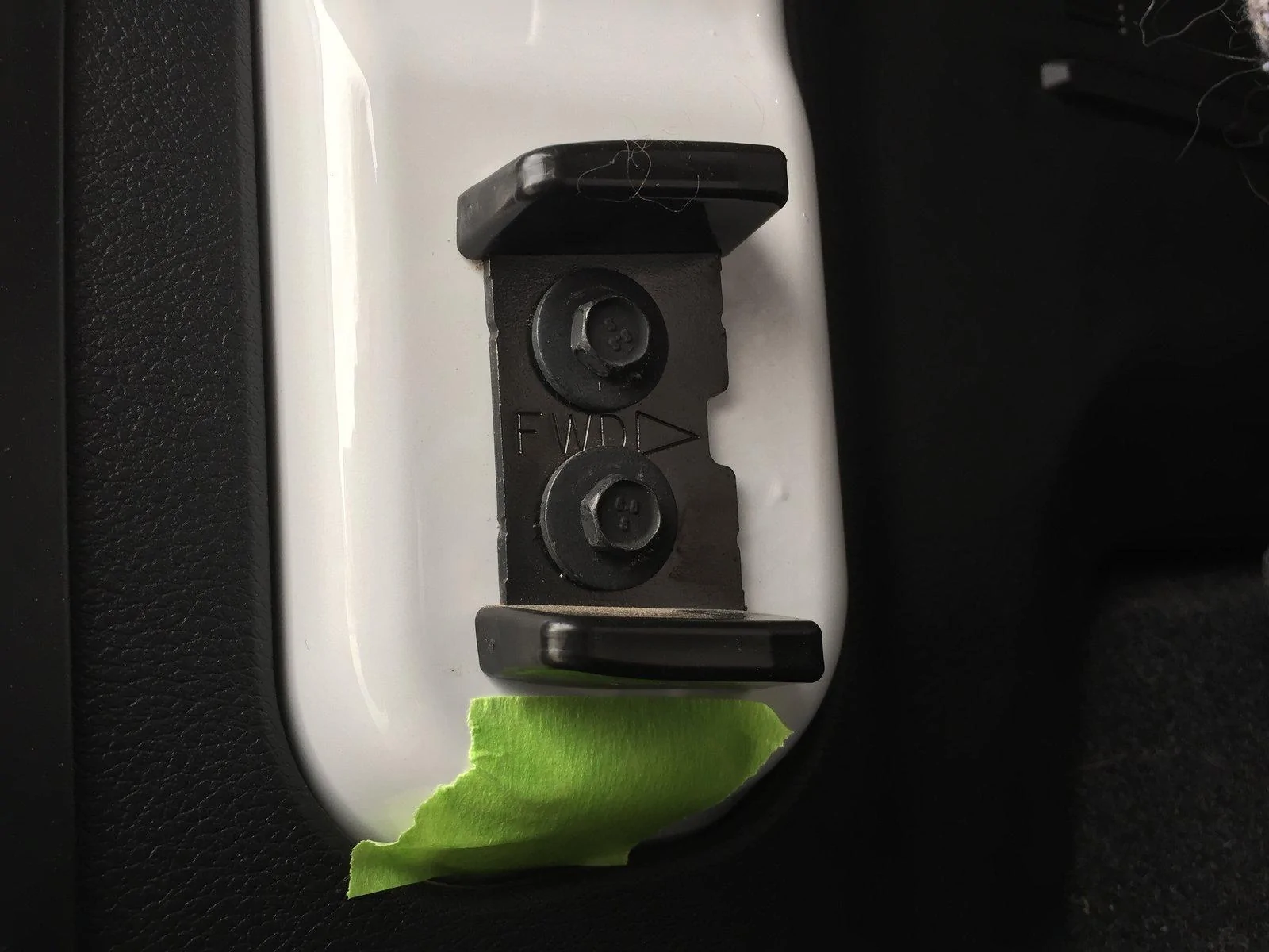

Ok I finally took the time to tweak the plastic guide that secures the rear door. I was having problems with the rear door sticking and a creaking sound coming from that area. Like others suggested I put some grease on the bottom of the latch and the rear door sticking issue went away for awhile. But the creaking sound kept coming back. it would go away when I added some paint protection film on the edge of the door but came back as the film got worn. So thanks to Rhinebecks motivation I used a 10mm socket and raised the plastic catch about an 1/8 of an inch up. I immediately noticed that my rear door opened easier and the creaking noise disappeared while driving. The photo shows some tape I used to mark the original location in case I need to put it back.
Hope this helps others with similar issues.
