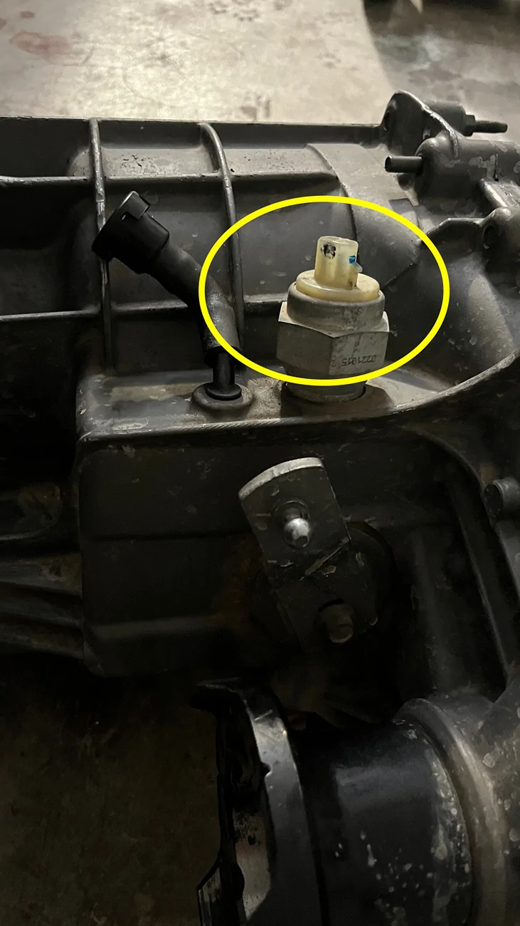

There is a position sensor on top of the t-case that tells the Jeep what gear it is in. It could be possible that connection is loose.
Here is a pic on my recently un-installed t-case. I've circled the sensor where the wiring harness connector goes into.
Jeep Wrangler JL T-Case Wrangler JL Electrical problem IMG_0890
My guess is either the connector needs some contact cleaner on it or the sensor has gone bad.
I recently had a discussion about this and the consensus was that on a Sport wrangler this is just for dashboard purposes so you would be able to run in 4lo without this sensor connector. With a Rubi it gets other info for the lockers/swaybar which is why when you go into 4LO it is having problems.
disclaimer: I'm no expert so someone else may have a better idea and I could be totally wrong.

Tomorrow I’ll try to disconnect it, clean the contact and I let you know if it solves the problem!
Is there a replacement piece for this sensor does anyone have the oem code?
