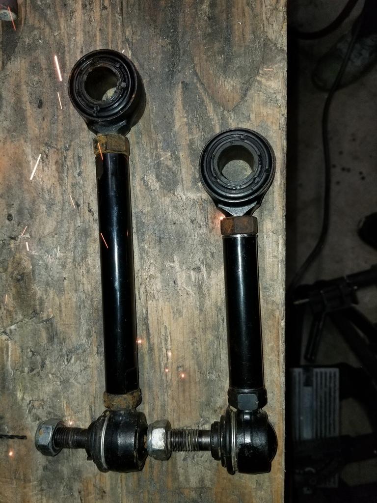

I have the Rancho Kit.. link is way too long for a 2.5 inch lift kit ( I have a Rough Country 2.5 inch lift kit on a Unlimited Sport) ... Rancho promised to make a shorter version.. I have yet to call and ask if there is a new version of the link.. however I doubt it will ever be produced.. see... The Rancho kit has these bracket where the quick disconnect link attaches... that bracket raises the connecting point by a couple inches.. I even cut the link by two inches.. even then the angle on the Sway Bar is about 13 degrees.. their documentation states that the angle should be less than - / + 5 degrees.. I will publish a photo when I get a chance.. I liked the idea of the Rancho kit because I didn't have to cut anything.. but the design as I bought it is way too long for a 2.5 lift kit.. I imagine it works fine for a much higher lift kit.. perhaps 4.5+ inches

Hey Arterius... yes.. it is indeed adjustable.. but even in the shortest adjustable length it still positions my Sway Bar at 22 Degrees.. way off the recommended + / - 5 Degrees.. please look at the last page on that link I posted where I detail the issues with the kit.. Rancho is aware of it and promised to manufacture a new.. shorter adjustable version.. but I sincerely doubt this is possible.. I cut 2 inches from the original Rancho Link.. and the Sway Bar still sits off the recommended values at 12 Degrees..
Here is a pic of my "re-engineered" Rancho link... 2 inches shorter... still not good enough for my 2.5 inch Rough Country lift kit

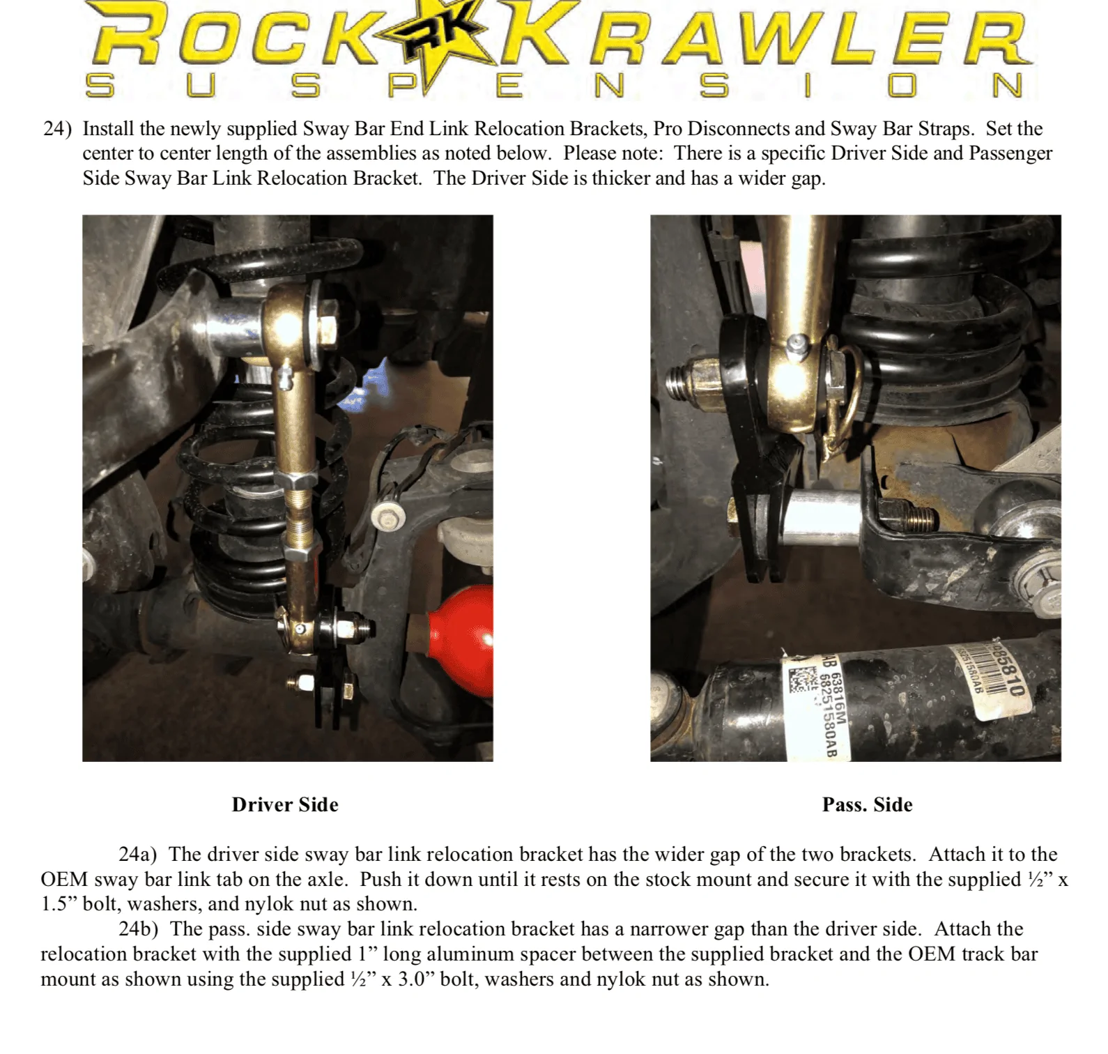

Hey Word.. I wonder if you can post a picture of the front links.. I am curious about the front passenger side.. how do you install the Rock Krawler links without cutting the mount.. Thanks!
I'm out of town for a couple more days, but the links come with mounting brackets that slide over the originals and are side specific. The passenger side comes with a spacer and bolts through the track bar mount.

cool.. thanks.. it is a similar idea to the Rancho kit.. Word.. I wonder how many degrees your sway bar deviates from level ? Thanks again!
They have a huge amount of adjustability. Probably in the neighborhood of 6".
