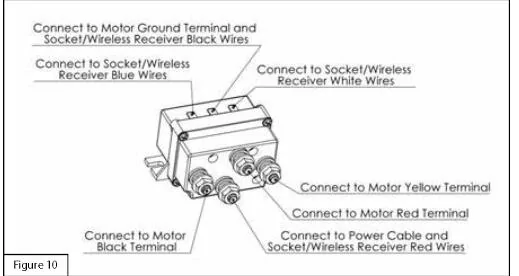

I assume @D00KEY has the SX series I have. Out BT remotes are preprogrammed.
On ours, the wired remote socket and wireless modules are wired to the winch controller with the same connections. There is a jumper from the power cable terminal to provide power to the socket/wireless.
I wonder then if it's as simple as running power to his wireless module.

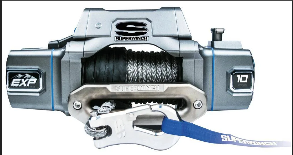

That is why I am hoping for a schematic mine is integrated in the winch with lots of wires and no idea which wire goes where.

I mean... I'm game to tear into it if you are. 😁
From the reviews, it looks like the thing is fully potted. Nice for waterproofing, WTF for service.
