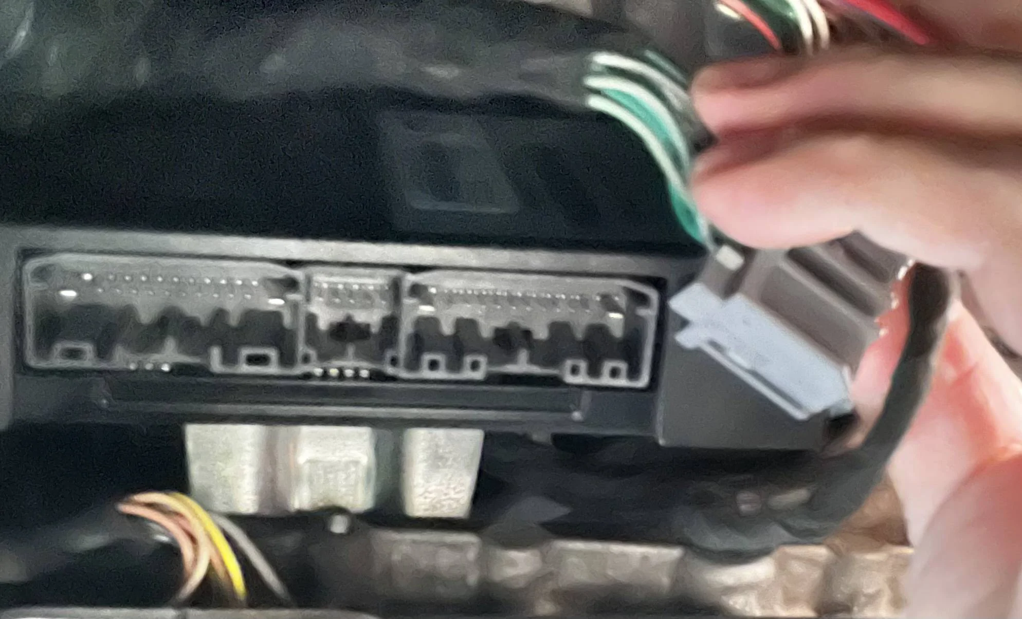

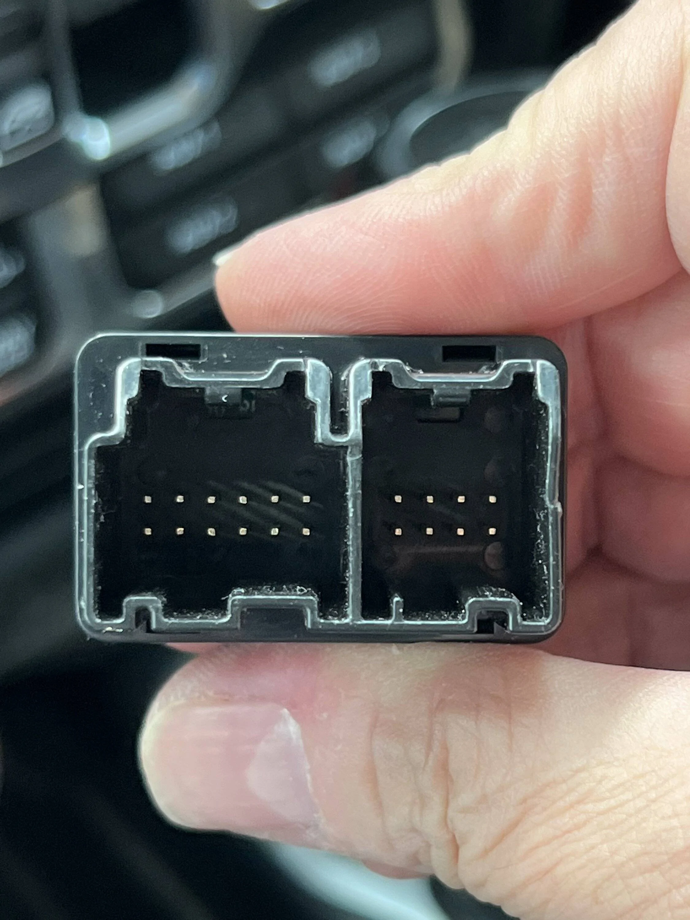

Is the ‘21 3.6 with eTorque supported?
I have the same question.
FlashCal F5 SKU 3571.
2021 JLUR 3.6L with eTorque.
Connectors don’t match.

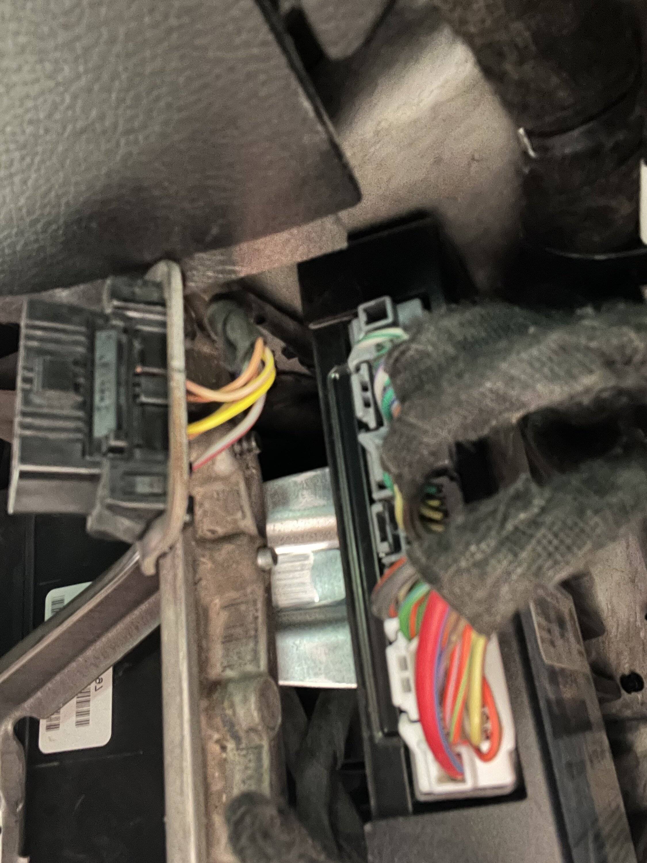

Trying to view your pics on a smart phone... Looks to me like you are fooling with the connectors in regard to the amplifier when you need to be back up there at the security gateway connectors(2).
See the red circled SGW connectors in this pic.
OH DUH!!! Checking again...

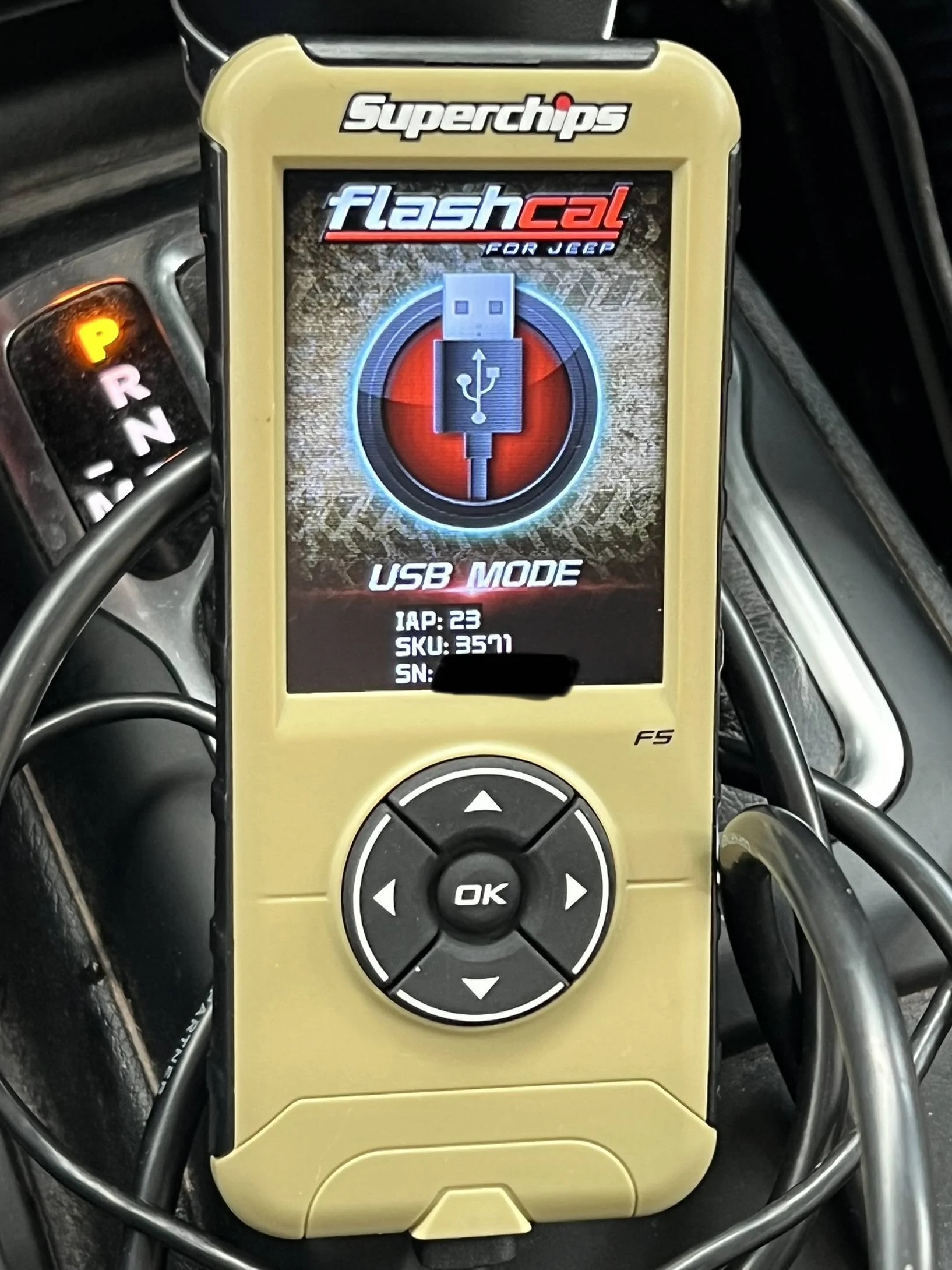

Mission accomplished. Heading to CVS for some contortionism pain medicine.
