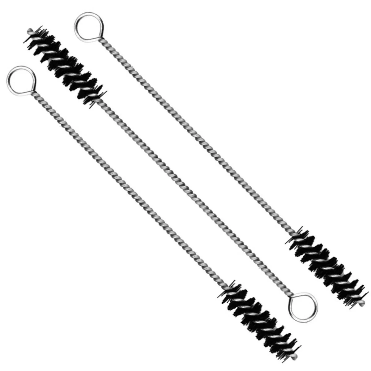

Just a random idea, but maybe spray it down and then try a looped nylon pistol bore brush to quickly poke in and out of each hole and then spray it again?
Still might take some time, but should work better than using a rag and your finger or trying to rotate a toothbrush in each one. Not really sure what caliber would work best, but you'd probably want something just a bit larger than the hole diameter itself, since they're more hex-sized than circle.
These ones go up to 45-cal, but that still might be a bit too small. Or maybe a similar style bottle brush might fit better?
https://www.amazon.com/dp/B078HCSBB2/
