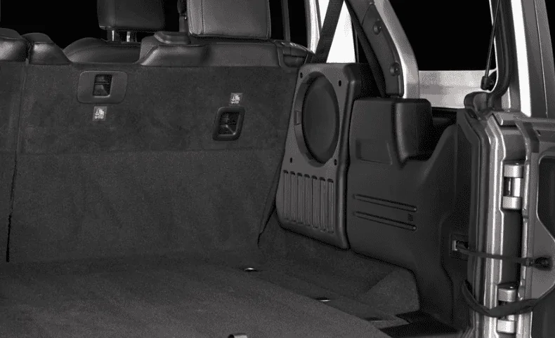

Is there a benefit to adding the sub under the seat vs putting it in the back besides space? And where does that amp go? I would've liked the sub to go under the passenger seat in the back, but im pretty sure there's an EV battery under there so it'd have to go in the front
GATORB8
May 30, 2021
8,896
11,833
CLT NC
21 JLURe, 06 LJ, 25 HDZR2
The JL Stealthbox Jeff mentioned goes on the rear side, similar to stock Alpine:
Jeep Wrangler JL Subwoofer Recommendations 1712699644951-by
Yeah that one seems super nice.... but it's also like $1k ?‍? this is a lease, so I'm not trying to spend that much money unfortunately
Realistically, I'd expect it to hold it's value pretty well.
There are some similar options, like the unloaded enclosure from SSV.
