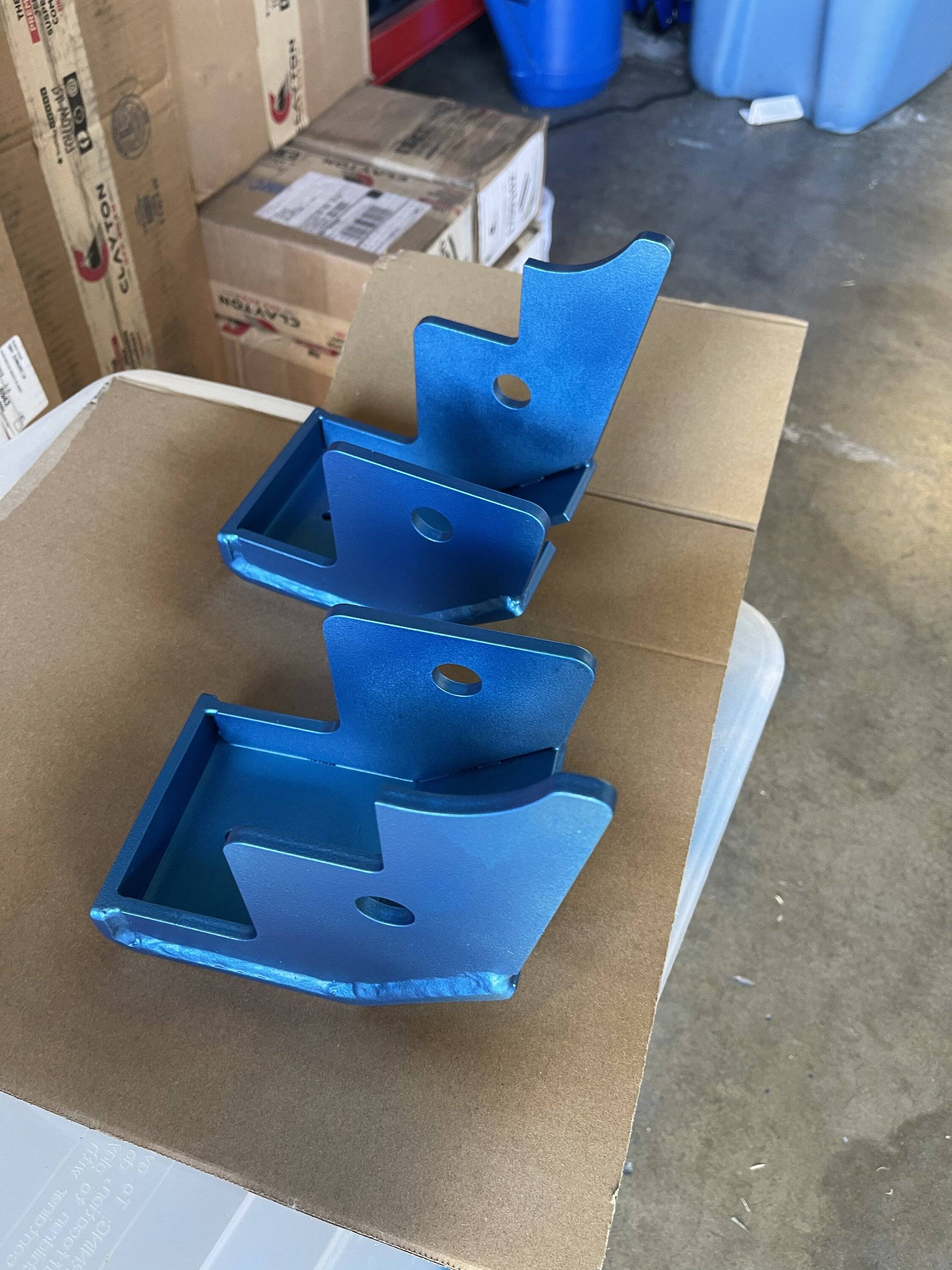

I wanted some rear LCA skid plates to protect that low hanging fruit and did the same to it. I have a FAD skid on order as well, and that will get painted before installing also.
Jeep Wrangler JL Storm Cloud - 2023 4xe Rubicon Build F1A98ED3-D666-47CB-B034-06308F378BE4

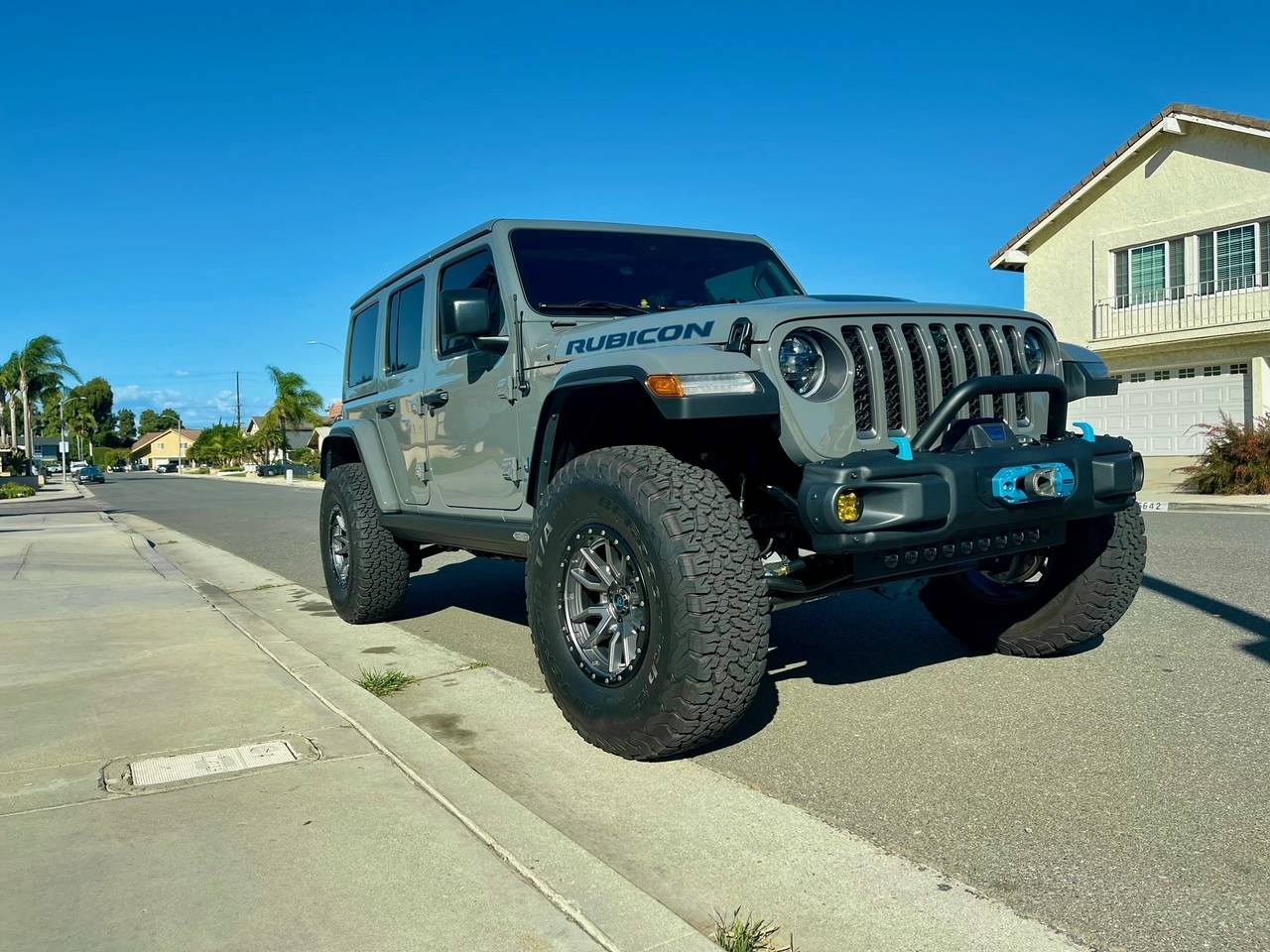

So it's finally done. The lift is on and the winch is installed. It's been a long time coming and I'm sorry that I don't have great pictures, but I haven't been able to get the rig out in the wild for some good shots in action.
I added on the Rockslide Engineering Gen 3 Step Sliders and I absolutely love them. I have to wear a suit for work and I can only imagine how many pants I'd tear, getting in and out of this.
Jeep Wrangler JL Storm Cloud - 2023 4xe Rubicon Build image26

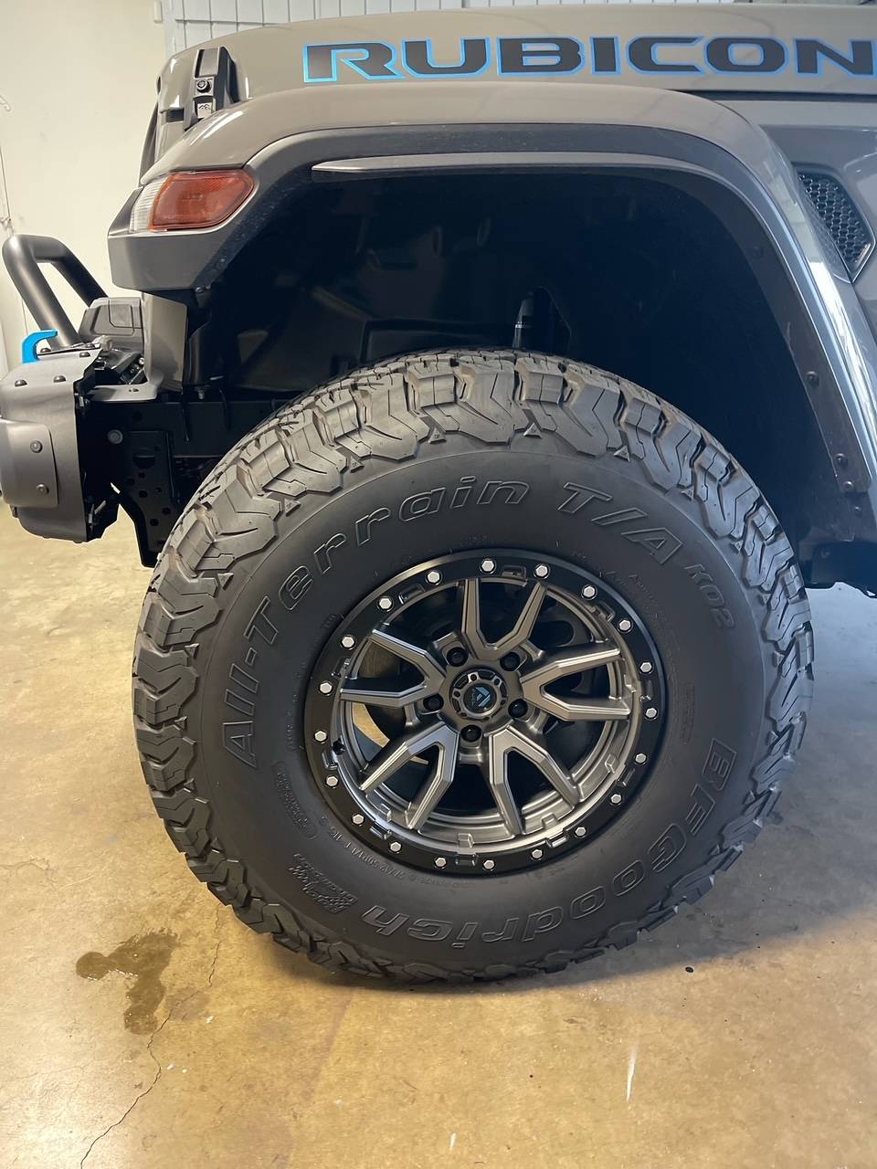

I put in the Clayton Offroad Overland Plus 2.5" lift. I love it because it isn't a huge lift. It barely comes in at 2.5", actual lift, maybe even slightly under, but that's with all the added weight. I was debating the Metal Cloak lift, which I hear is awesome, but I have heard that the 2.5" nets more like 3.5" and the wife would have killed me if I had gotten it any higher. I barely got her to agree to my getting 37's and they are KO2's, which run small.
Jeep Wrangler JL Storm Cloud - 2023 4xe Rubicon Build image13
The height of the jeep now runs at 43 1/2" from the wheel center line to the underside of the fender flares. Not too high, but just right.
Jeep Wrangler JL Storm Cloud - 2023 4xe Rubicon Build image0

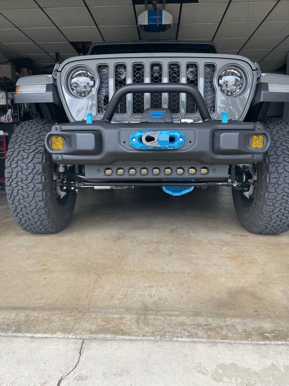

Along with the lift, I added in a Warn Evo 10s along with a Factor 55 Flatlink E with rope guard. I had the fairlead and the rope guard powder coated to match the 4xe blue. For those that want the correct formula, it's Tropical Blue (PMB6792) with Tropical Blue Step 2 (PMB6793) over coat. It isn't metallic, but it matches the color spot on. The 4xe Blue Warn stickers were courtesy of Pixel Decals. I may have a new set made, though, with a grey trim, instead of black, to give it separation from the black plastic on the winch.
Jeep Wrangler JL Storm Cloud - 2023 4xe Rubicon Build image22

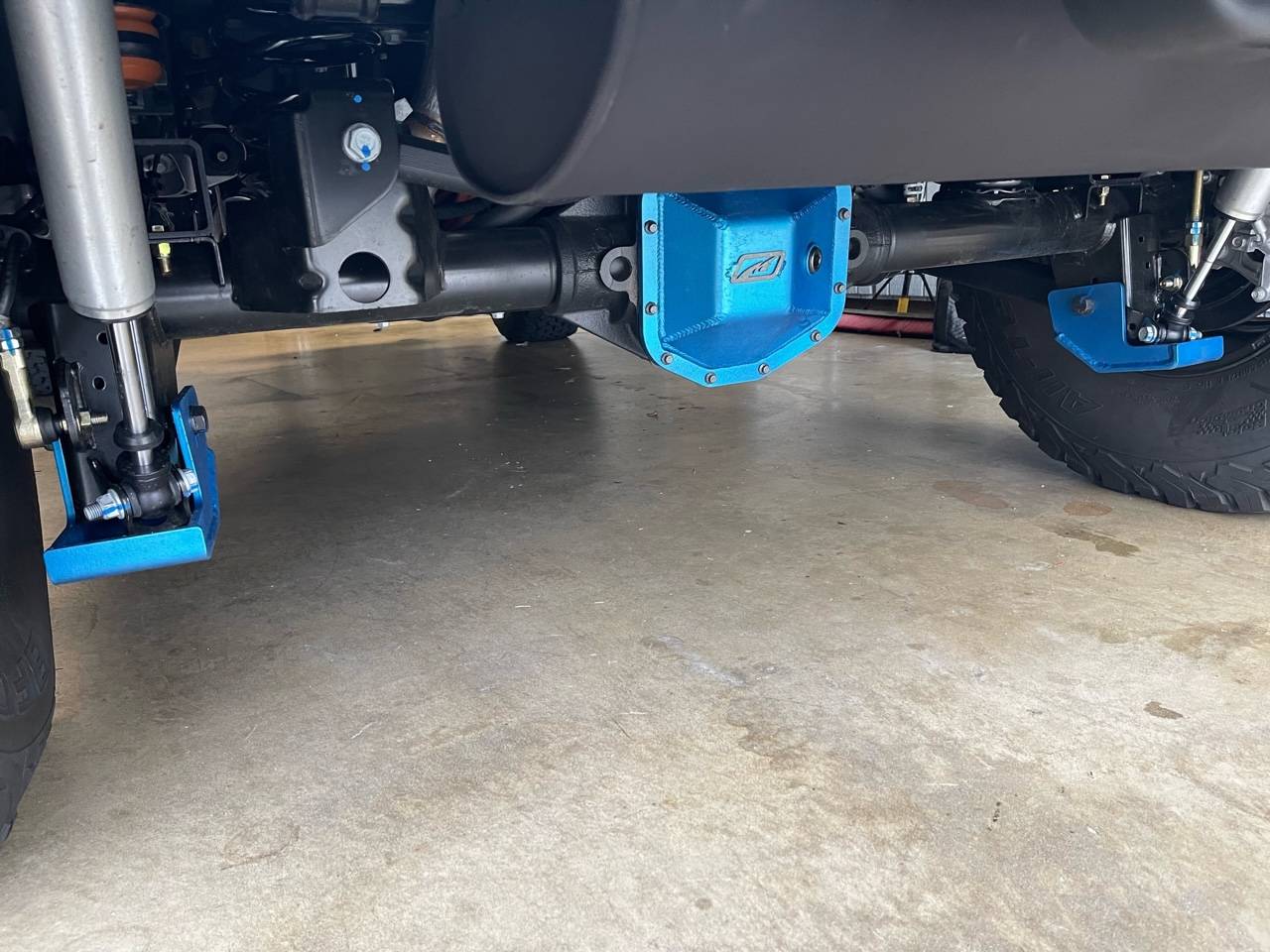

In my last post, I had prepared my skid plates and Motobilt Differential Covers for install. Here they are in place.
From the rear
Jeep Wrangler JL Storm Cloud - 2023 4xe Rubicon Build image4

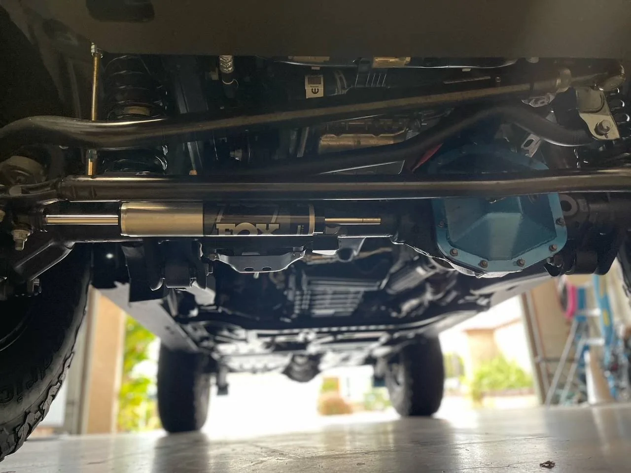

And the front
Jeep Wrangler JL Storm Cloud - 2023 4xe Rubicon Build image21
I also added in the Fox TS Steering Stabilizer. I honestly think that the Jeep handled very well before I installed this, but I can definitely notice that the steering tightened up just a bit afterwards and made it feel more connected. I almost went with the Fox ATS, but in the end, it was more money, I didn't like the red color accents, and I know myself well enough to know that I'd never use the adjustability. Rather than crawl under the jeep, I'd set it in the middle and leave it there forever. I accidentally bought the wrong size Steering Stabilizer relocation bracket, so that's going to be coming soon.

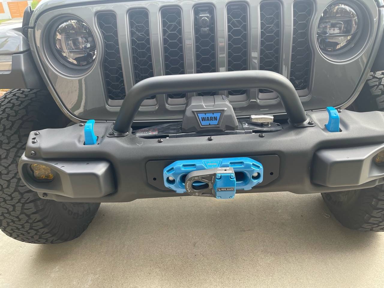

So I had the fairlead and the rope guard powder coated to match the 4xe blue. For those that want the correct formula, it's Tropical Blue (PMB6792) with Tropical Blue Step 2 (PMB6793) over coat. It isn't metallic, but it matches the color spot on.
Do yourself a favor and skip out on the Mopar paint and use Dupli Color Bahama Blue, available at Autozone. The can is much larger so you won’t run out midway through the project, it’s cheaper, and it’s a perfect match.
I love the blue accents that you added!
Are both of the quotes above the same color? The difference is that the Tropical Blue is powder coated and the Bahama Blue is paint?
Thank you very much! You are correct, the Tropical Blue step 1 and 2 are the PMB codes are for the powder coating formula to get the closest match. The Bahama Blue is Dupli-Color's name for the Mopar Surf Blue paint.
Thanks! When I look at my 4xe, the hooks appear to be a lighter blue than the decals and other accents. Is that really the case, or are they all the same blue?
It's a different blue. I believe that's Mopar Chief Blue. I have no idea why Jeep went with multiple blues but I couldn't get myself to paint the hooks to match. It just didn't seem necessary and gave me a false sense of control over my OCD.

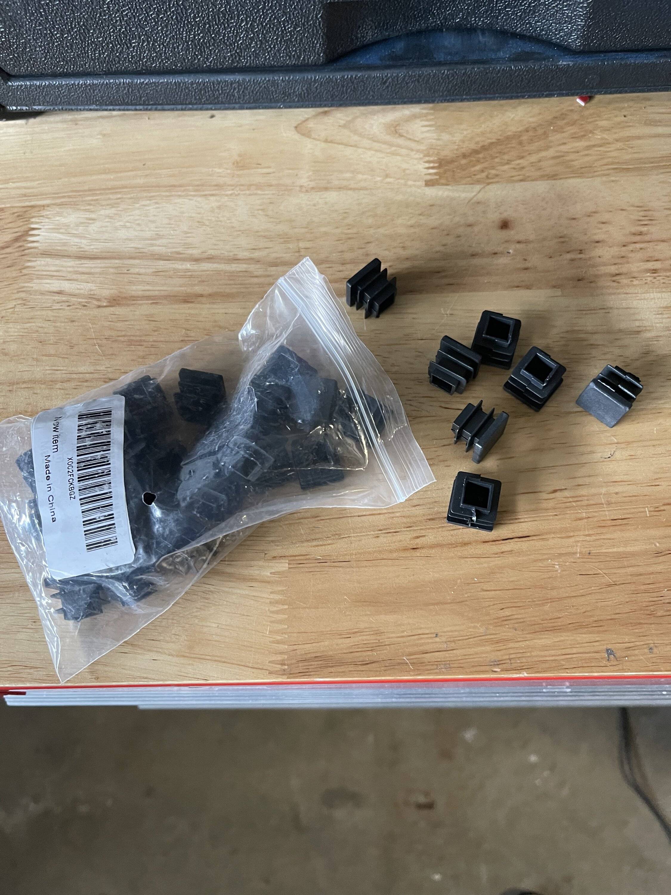

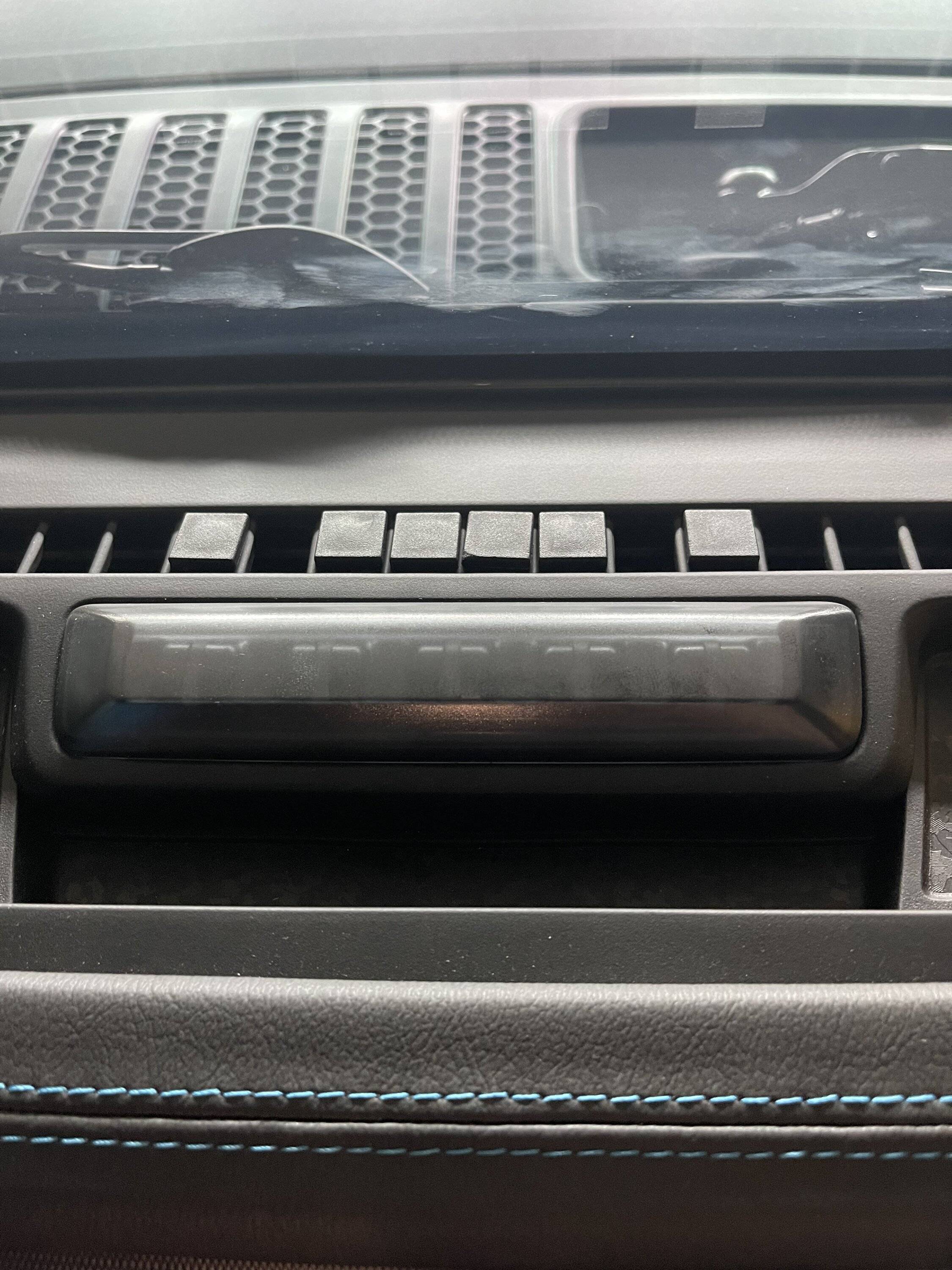

Damn it’s cold. By Southern California standards, at least. I woke up and actually had a thin layer of ice on my windshield so I decided to warm up my car with the defroster before I went to work. By the time I was ready to go, the inside of the Jeep was steaming, but the windshield was only defrosted in the middle.
I’m not sure how many people have read about the defroster distributing heat unevenly, but if you look at the vents, they go all across the top of the dash, but the air only seems to blow out of the middle and the outsides barely blow at all.
I read about a clever workaround on these forums and decided to give it a try.
I ordered 5/8” square tubing plug caps off of amazon.
Jeep Wrangler JL Storm Cloud - 2023 4xe Rubicon Build 5C1D03C8-E241-4601-A8D8-29319A3C0E44
I inserted them into some of the vent holes in the middle to block the airflow, while leaving the outsides open.
Jeep Wrangler JL Storm Cloud - 2023 4xe Rubicon Build 211BE3AC-E792-435E-9198-1FE1E79AA6DB
I got to use the heater this morning again and they did a pretty good job at redirecting the flow from the center and forcing more to the outskirts. I will probably add about 3-4 more on each side to improve the performance, but it actually turned out to be a pretty good hack.

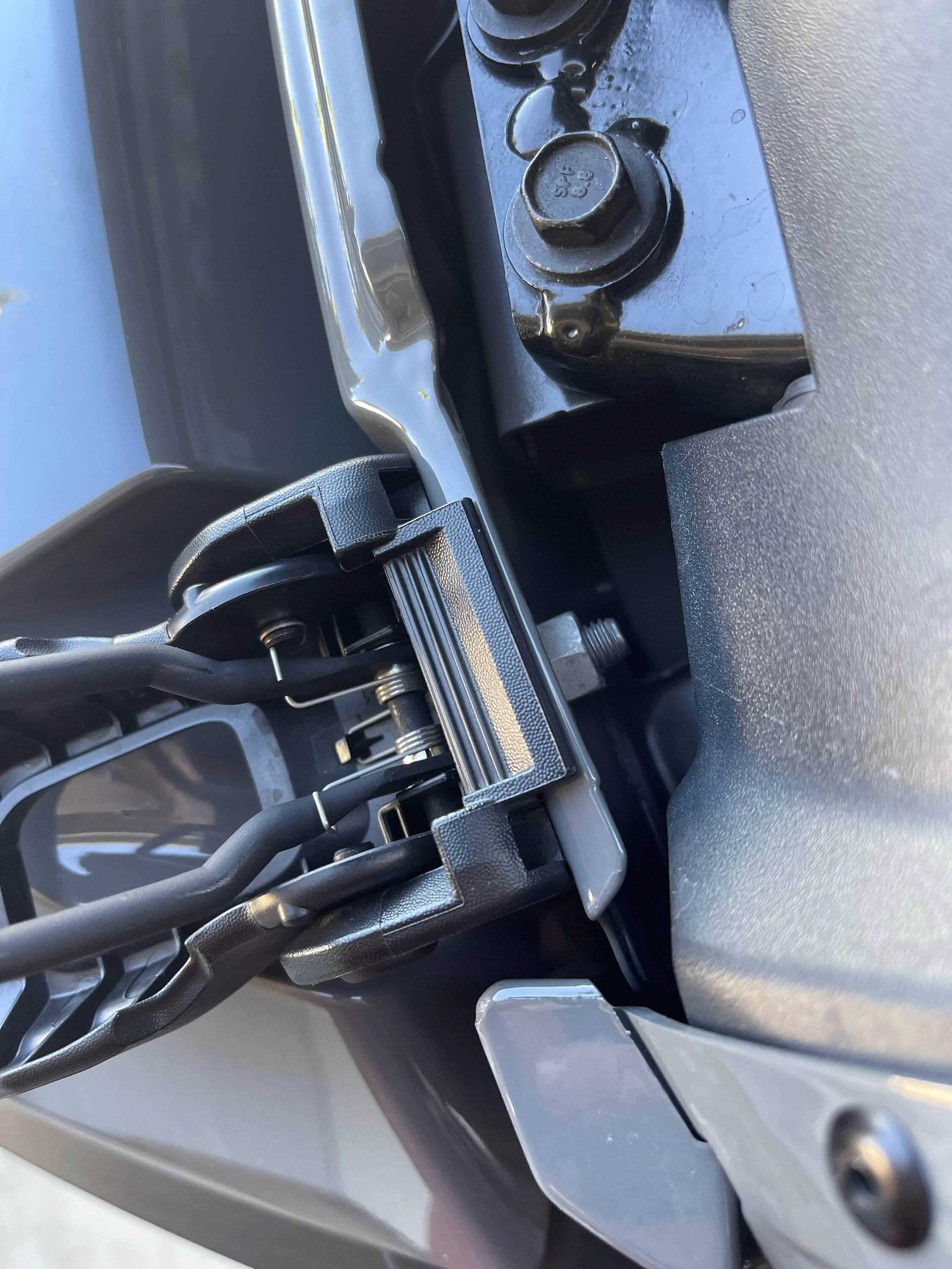

After reading so many posts on these forums and Facebook about Jeeps getting stolen, I decided to change out my hood latches for the Rugged Ridge locking latches. Ideally, I would have gone with the Bold hood lock. It’s perfect for what I would want and it minimizes extra keys by using the vehicle key, but with the trail cam, it just wan’t an option.
Jeep Wrangler JL Storm Cloud - 2023 4xe Rubicon Build 3BBC24BF-5F4B-424F-9D40-680F4CD879DD

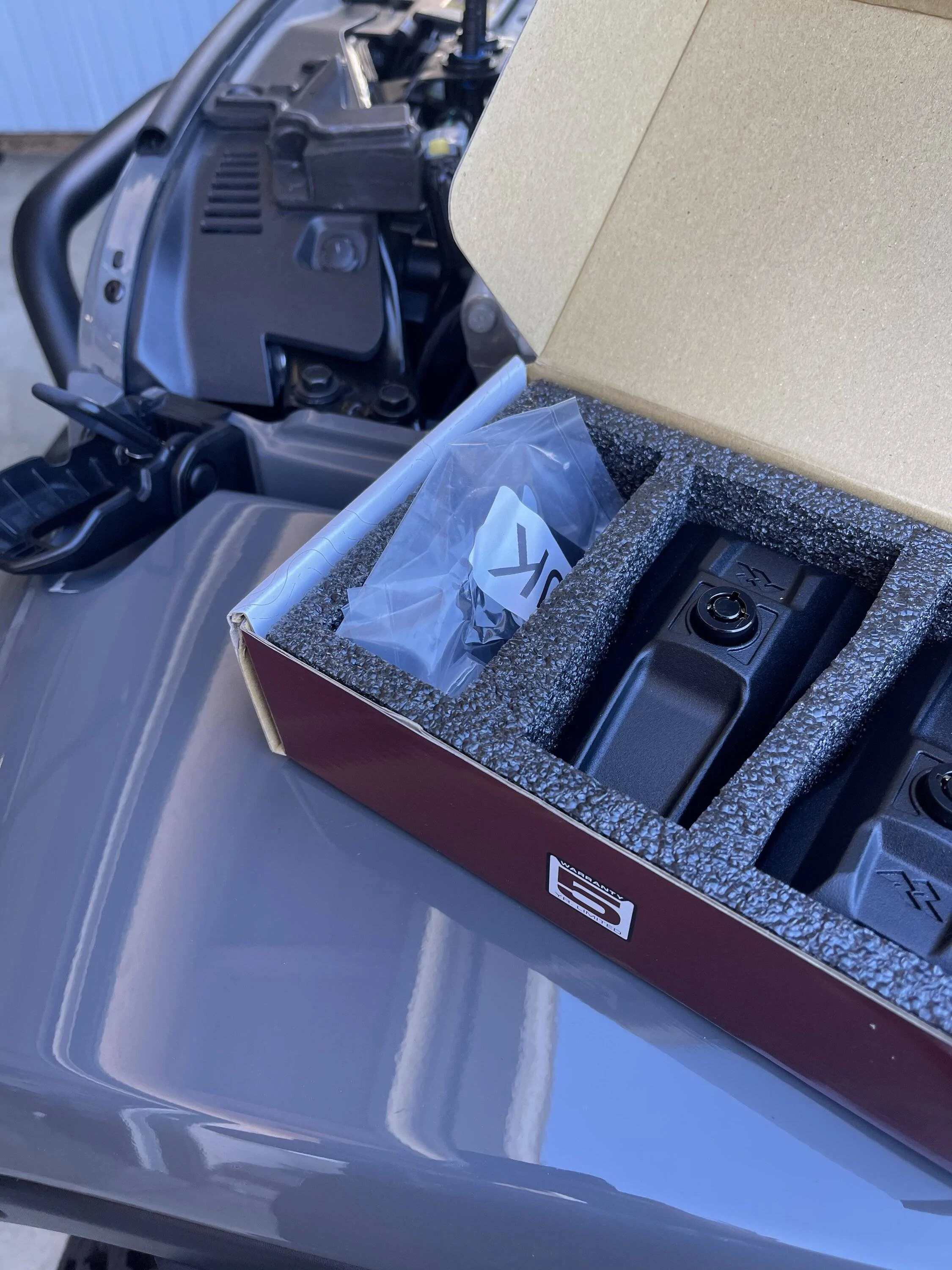

It came with everything you need, whether you have a JK or a JL. I read through the directions and they seemed a bit confusing, but once you open up the box and look at the pieces, it’s very simple and intuitive. You really don’t need the instructions once you look it over.
Jeep Wrangler JL Storm Cloud - 2023 4xe Rubicon Build 4E70C0E5-305B-4BDC-BC43-6030F771CE79
You just remove the bolts holding the latches in place and put the new latches on. Be very careful when removing and installing the bolts, unless you want them getting stuck in the abyss.
Jeep Wrangler JL Storm Cloud - 2023 4xe Rubicon Build BAC67A64-3DFF-43B8-8E1F-18ED702E5775
Once it’s on, it’s just a matter of adjusting the latch hook on the hood up or down to ensure that it’s a very tight fit. I wanted to remove any possibility of hood rattle, so I made mine very tight. You have to really press down on the hood to allow the latches to release, but I’d rather it be extra tight than loose.

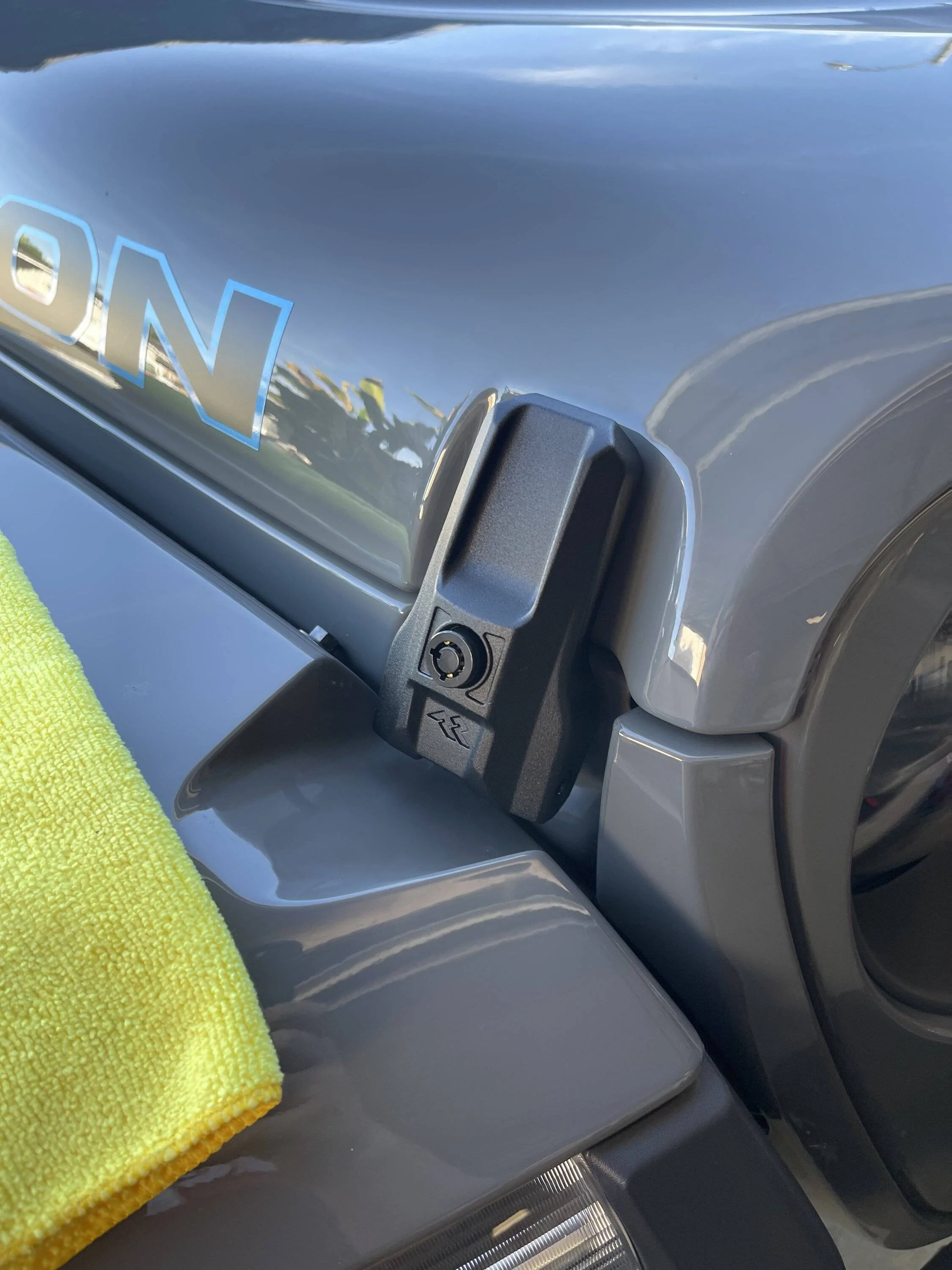

I have to say that they look really clean. I’ve seen a lot of different latches on the market and these are the ones that have the cleanest look in my opinion. The only drawback is having to carry the keys with you, but it’s a small price to pay. It came with 4 keys so you can stash them in different places and not have to worry about losing it.
Jeep Wrangler JL Storm Cloud - 2023 4xe Rubicon Build 9A1956FD-D1FE-47DB-A649-E777BE44CEAC
