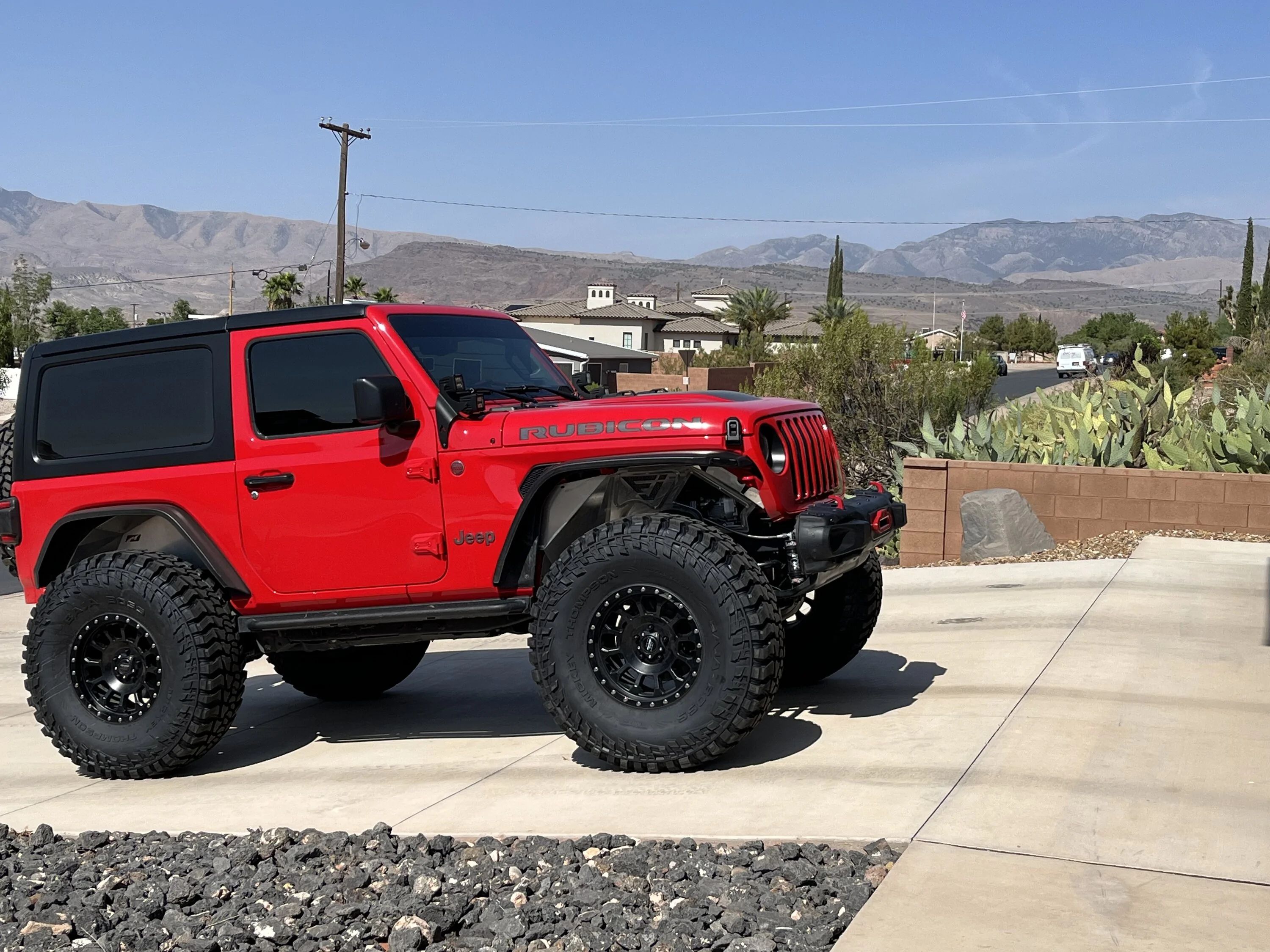

I have opportunity to get a set of 2025 xr beadlockable rims. I have BajaBoss MT in 40 13.5 17. I already run the tires on my rig with no issues but i am unclear on the fitment with the xr rims. Anyone have xr rims and 40’s or advice
Jeep Wrangler JL Stock xr rims IMG_5934

With the backspacing of the XR wheels, your tires may rub on aftermarket front lower control arms at full lock.

with 40x13.5 tires I would want wider than 8" wheels.....those wheels with those tires looks bad ass for sure.....

depends on why you want them.
do they come with the actual beadlock rings?
beware that the standard rings on those wheels are Beauty Rings, and you would not be able to run beadlocked without the actual bead lock rings (and bolts).
otherwise, compare the offset/backspacing with your current wheels to determine if you might have any rubbing on the inner side when turning and/or stuffed..
