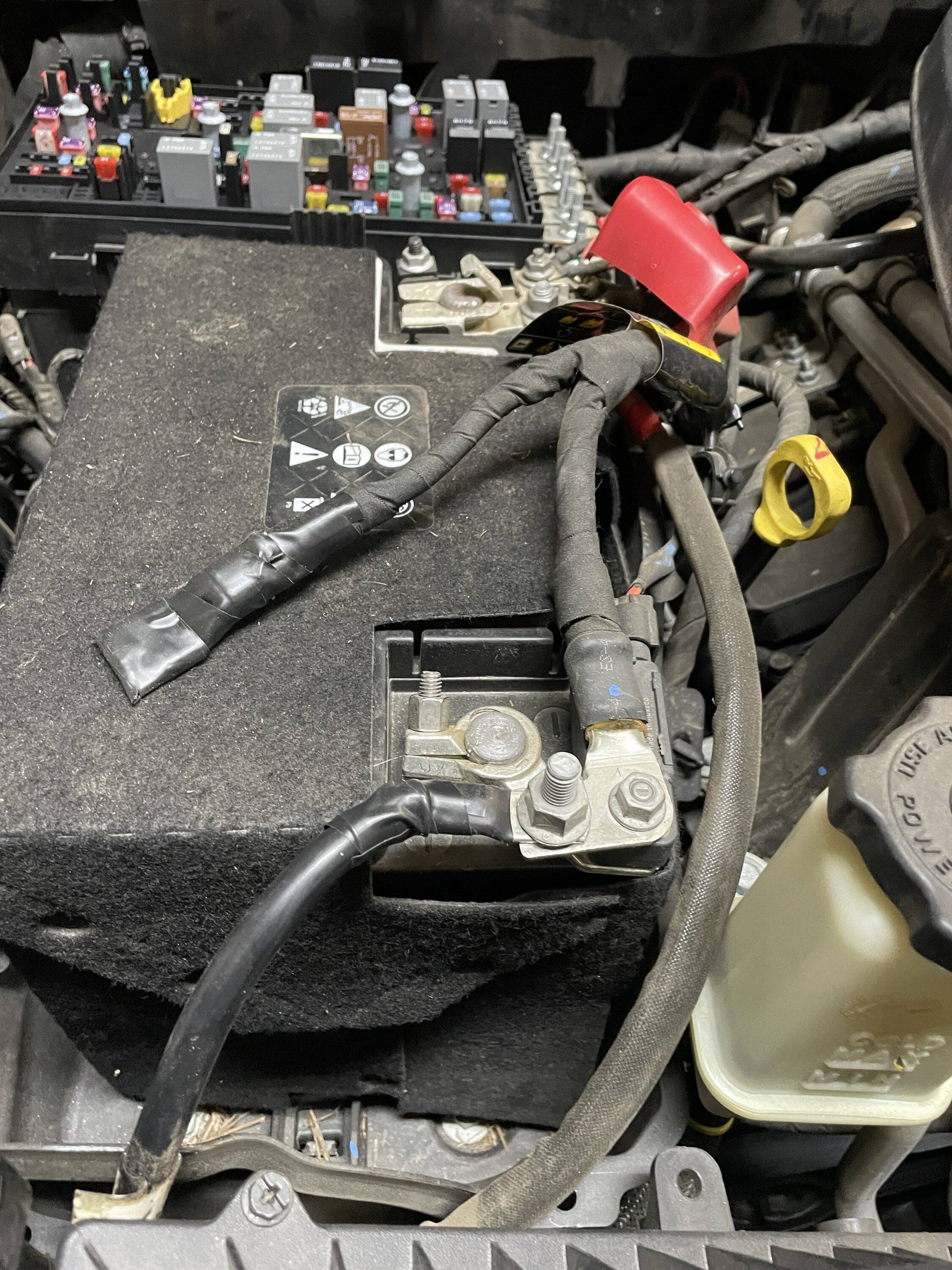

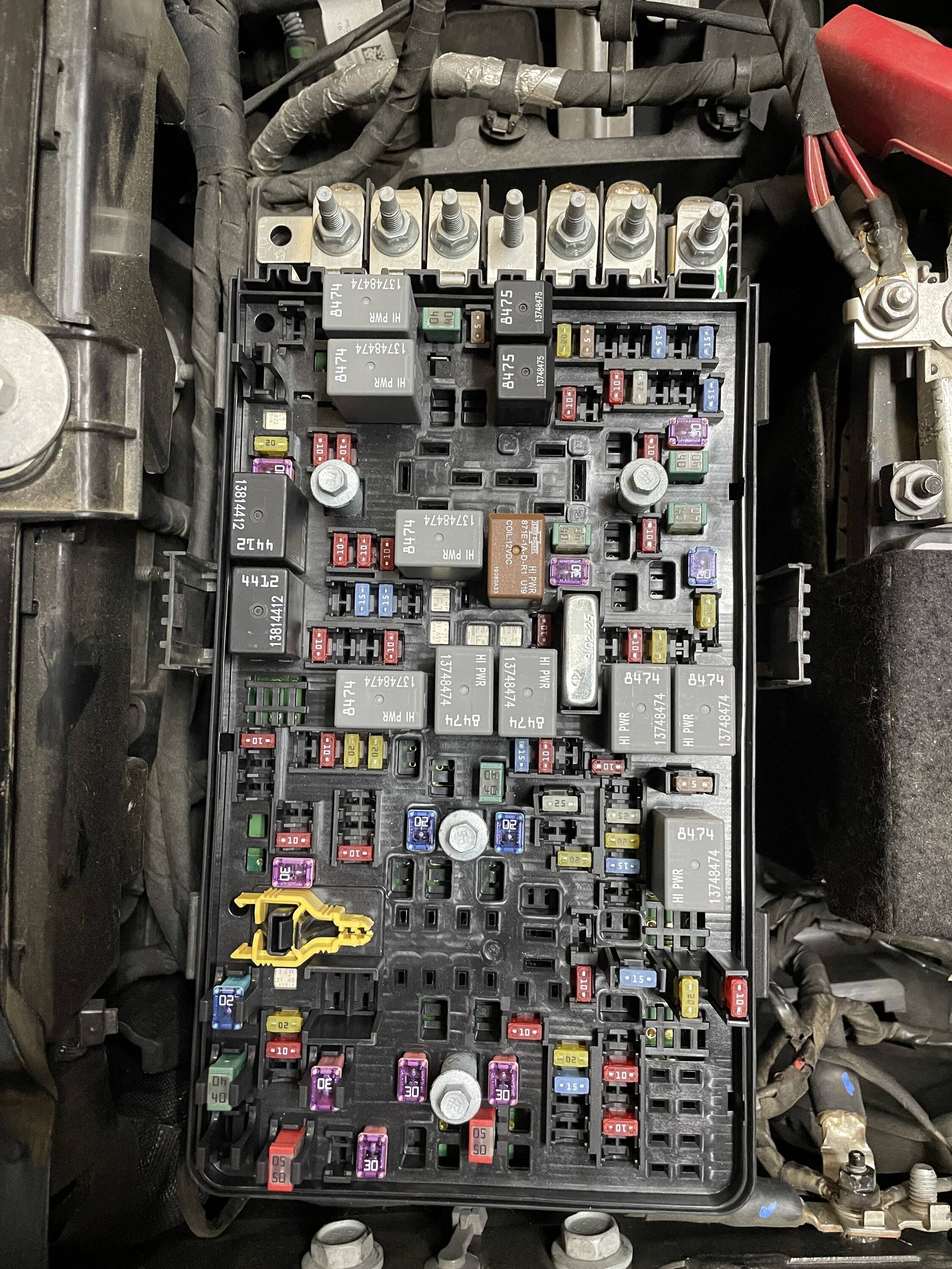

My Aux battery has failed on my 2020 JLU. I decided to do the Aux bypass by pulling fuse 42, then the Aux battery negative terminal (see attach). I trickle charged the battery overnight, it would not start until I jumped it then it started. The engine stopped running after a minute resulting in the amber engine icon, jumped it again with the same results. After resorting the Aux battery neg terminal and fuse 42, the engine would start (after a jump) and would not stall. The service engine icon is still on. Voltage is 14.5.
Would changing the main battery then do the Aux delete prevent stalling? Does a mechanic have to clear the service engine light or will it go out after replacing the battery? Did I isolate the correct terminal?
TIA

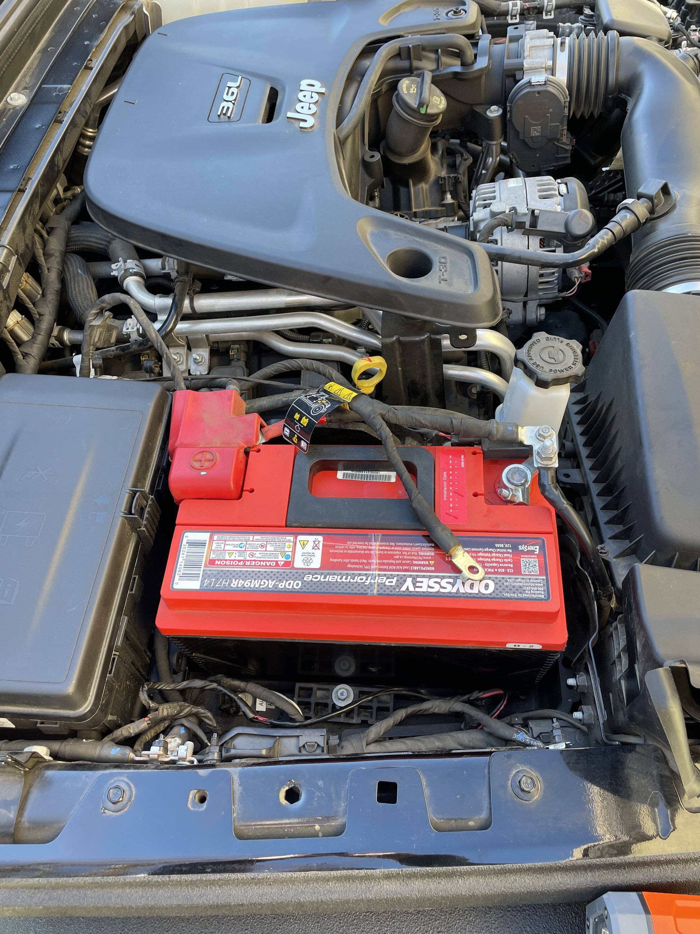

nice! I kept my aux connector taped up for about a year until I saw it had melted through. Then I just cut it off. When I replace my main I'll take the aux battery out.
What's your voltage reading now with the engine running?
