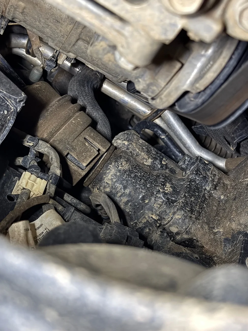

Hi everyone. 2021 Wrangler Runi that is making a squeaking noise when I turn left. Even with the car off if I giggle the steering wheel to the left it makes the noise. Thoughts? Thank you.

Good question. I had death wobble so most everything is aftermarket. Shocks and springs still stock.

If it does it with the Jeep off, I’d look at front end components, not the power steering.
Common culprits are track bar bushings, ball joints, or the drag link/tie rod ends. Sometimes even the steering shaft at the firewall will squeak.
Have someone turn the wheel while you watch underneath and you’ll usually spot it quick.
