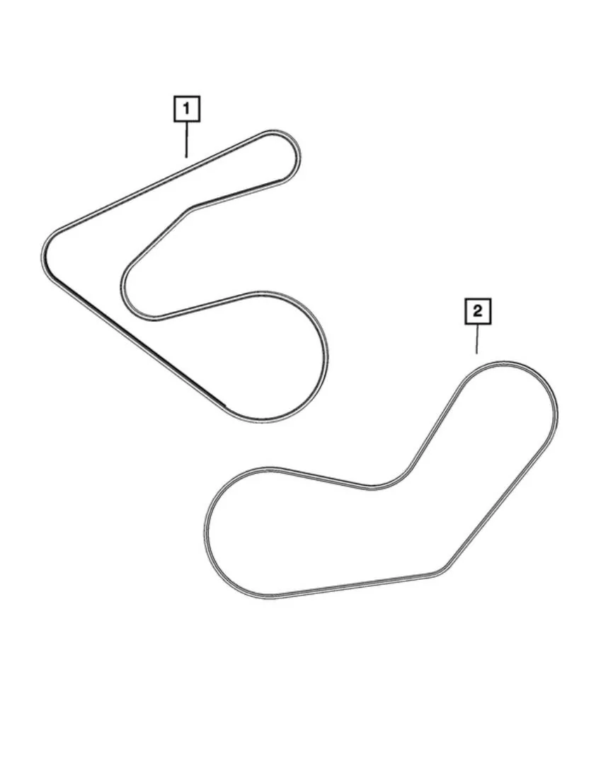

Is this diagram supposed to be illustrated looking from the front of the engine ? If so it's the #2 belt. I searched my vin on a few websites and found that this belt does fit.
No?

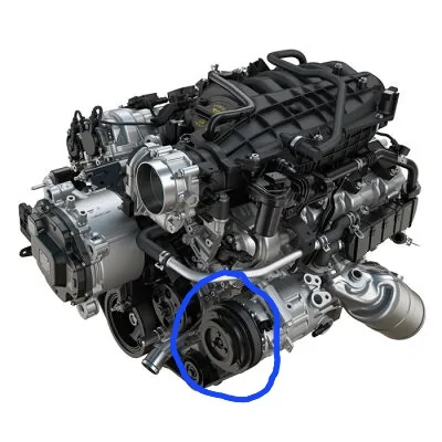

This is my squeeky belt which looks like the #2 belt in that diagram unless I'm reading it wrong.
Yeah, that’s the a/c compressor. You should take your Jeep to the dealership.
Belt noise is very unusual on modern vehicles, unless you have a fluid leak directly into the belt or bearing failure is imminent.
