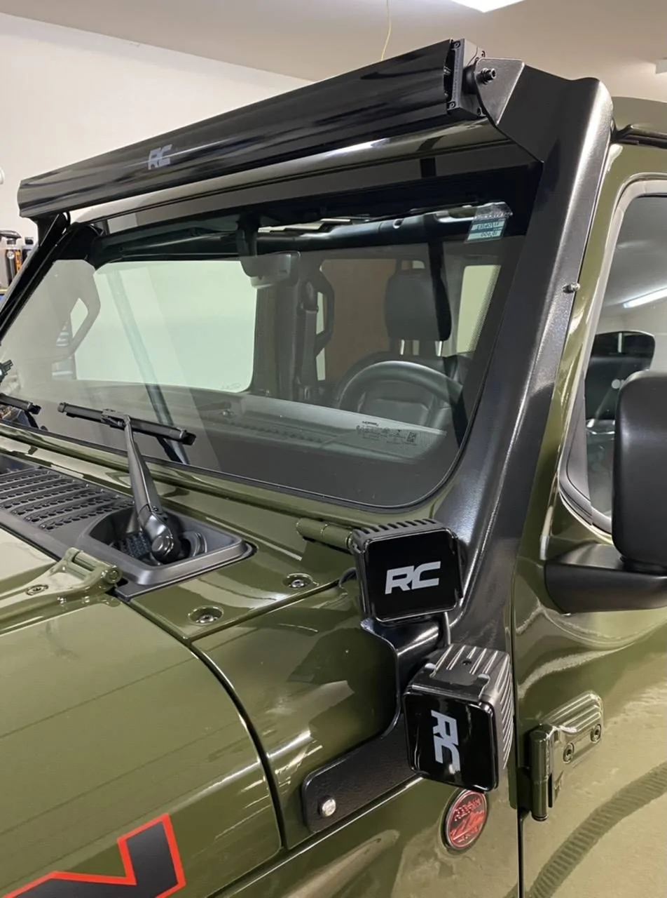

I’m just going through installation of Rough Country 2” cubes (spot) and R.C. Light Bar (combo flood and spot). I’ve tried my combo flood and spot light bar once in the driveway and didn’t notice any hood glare (although I was mesmerized by the amount of light and may have simply been distracted).
Here’s my setup:
Jeep Wrangler JL spot and flood positions 7580AA44-FE6A-4BD2-BD24-32B84349D54A
