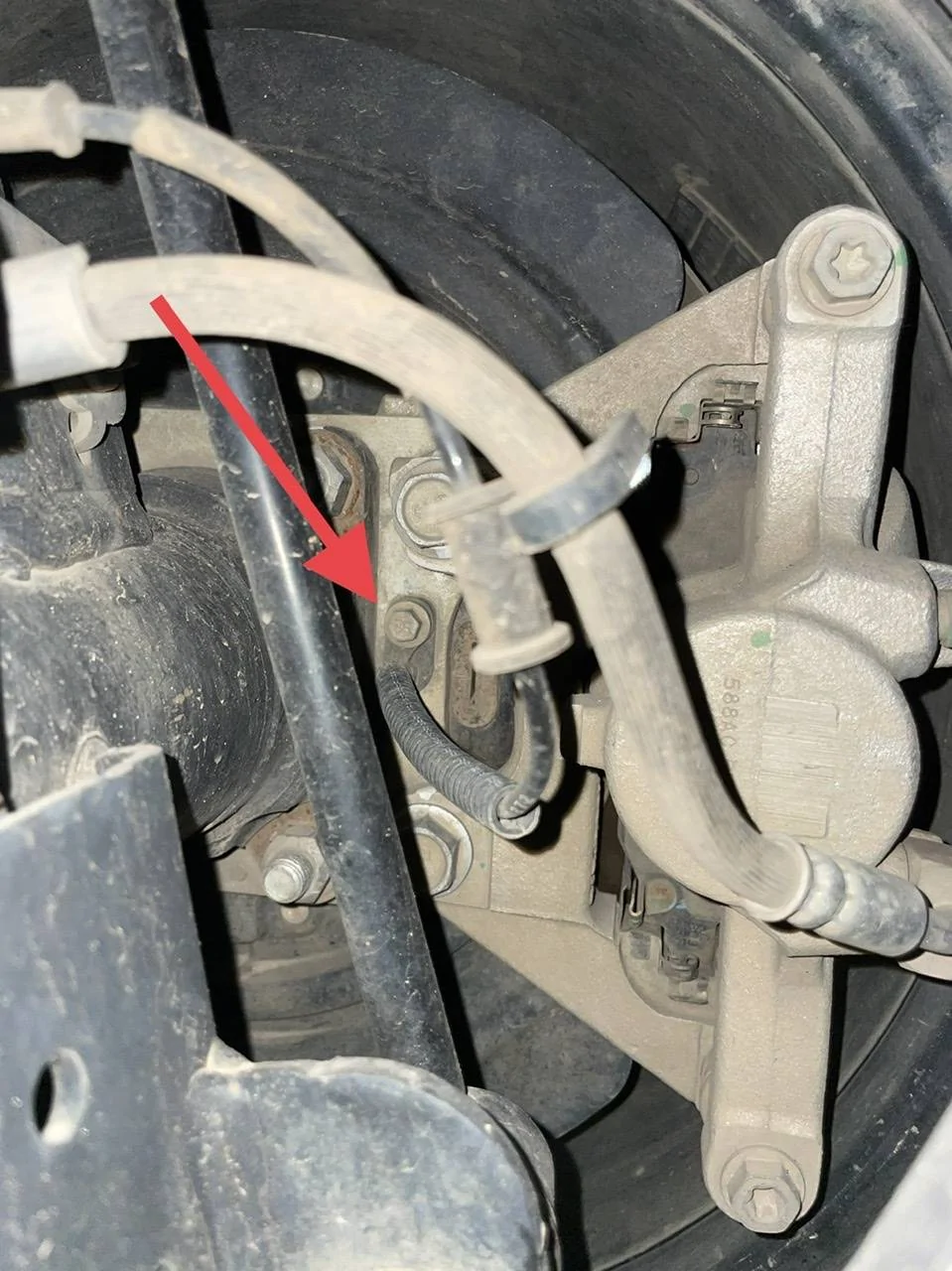

I've got a CEL for my speed sensors and I'm dreading going to the dealer. It started when I installed my lift, I thought getting an alignment would fix it but they continue and I'm missing almost all of my computer controlled stuff (ABS, tc, 4wd).
Clearing the codes with my Tazer didn't fix it..
Does anyone have any docs or can point me to exactly where the speed sensors are? https://www.quadratec.com/p/mopar/rear-wheel-speed-sensor-jl-68293133AB

Isn’t that the deal that runs right alongside your brake line? If you don’t remove the bracket holding them from your LCA and you droop the axle to pull springs out it can pull them too tight and damage them.

The rear speed sensor is located between the 2 brake caliper bracket bolts.
Jeep Wrangler JL Speed Sensor locations 6906E99A-84E9-4C01-B52C-A7AC39555ABB
