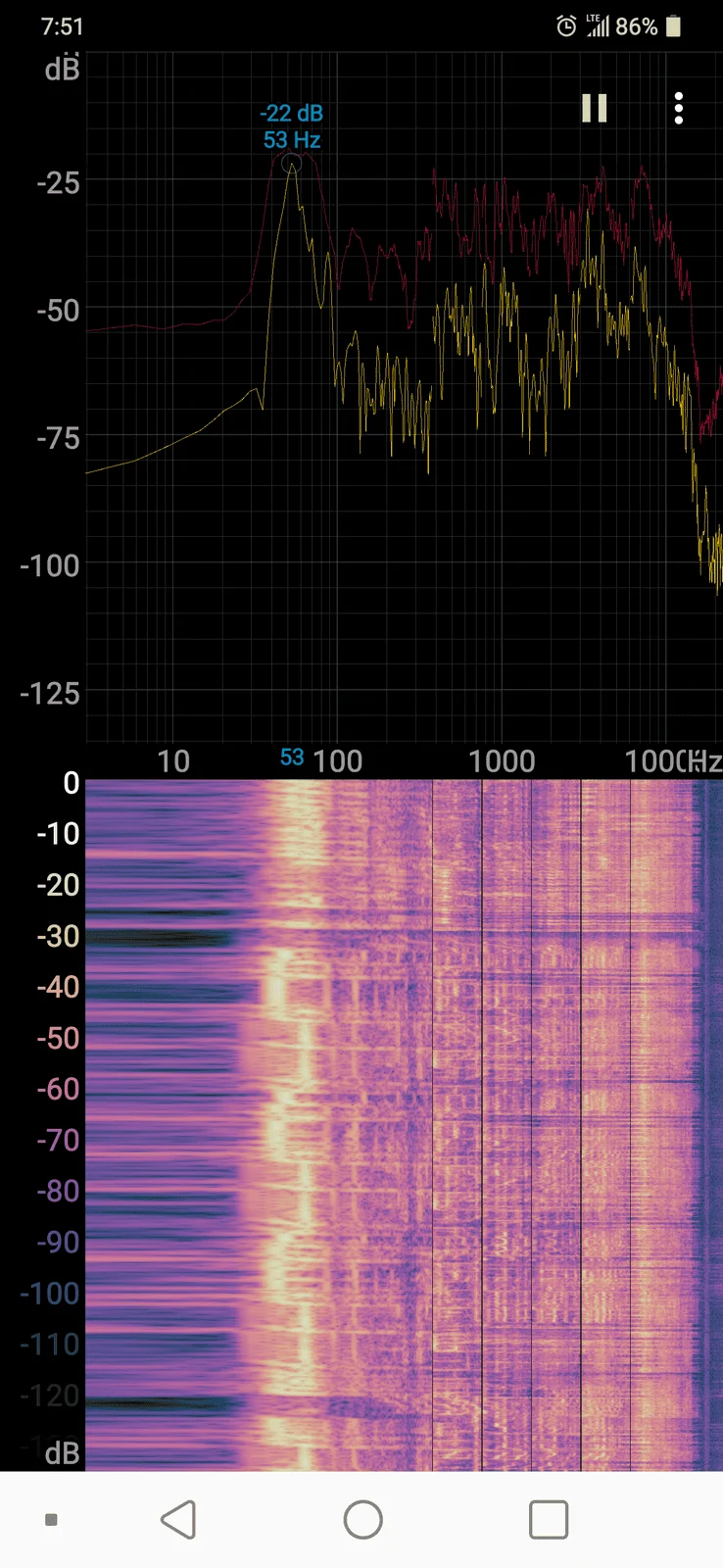

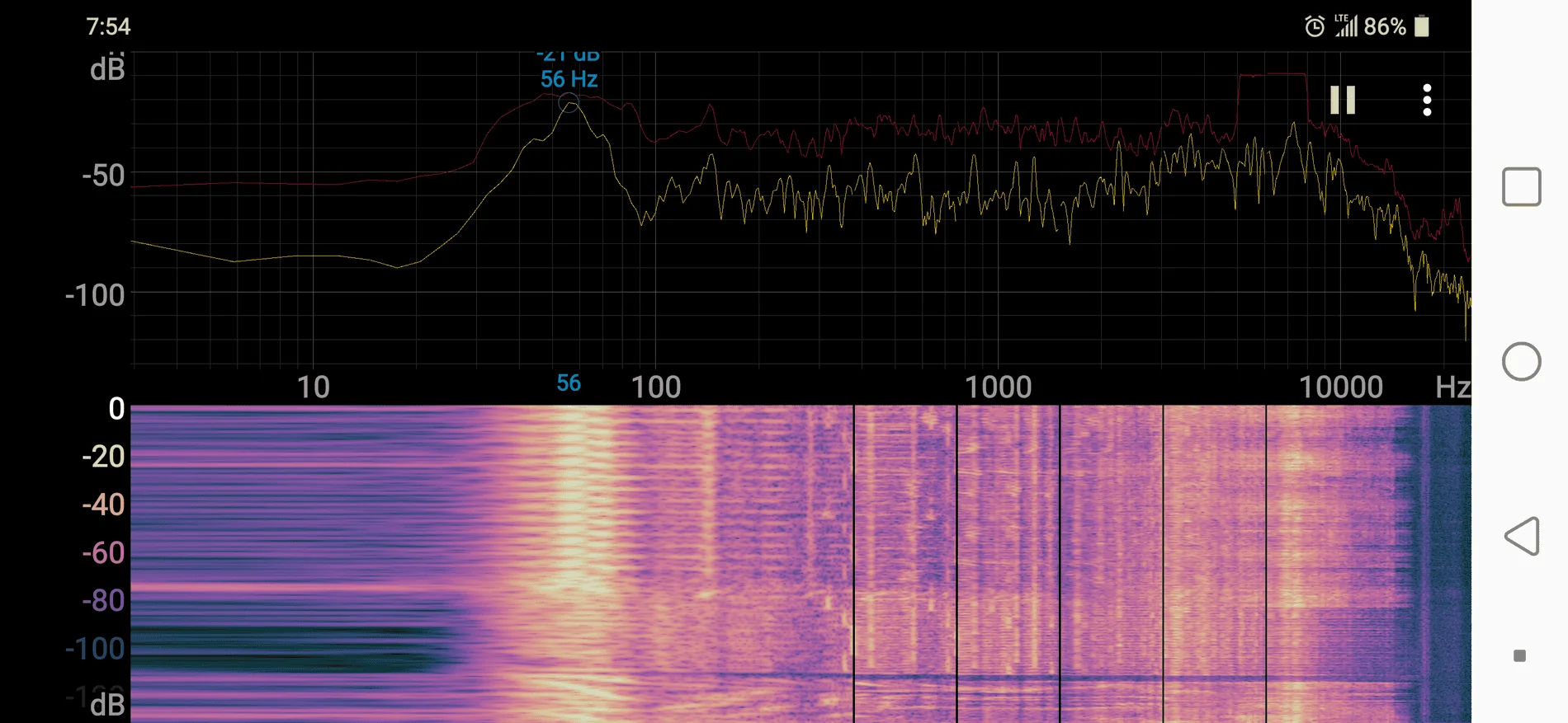

I also use that RTA App on my Android Phone. With the Volume at "21"..this is the RTA readings I got. I have no clue what this means. Any good?
Hey there - were you playing pink noise or an audio track when using the RTA? They used to make a 4-channel version the PDXF4 (100 watts x 4) and the PDXF6 (150 x 4), but they have been replaced by the X series amps which have decent power, but do not have the same signal to noise ratio or total harmonic distortion. On specs alone the PDX series had better sound quality, not sure why they changed it up.
If it were my vehicle, I would do a combination. The JL Audio Fix-86 and their 6 channel amp with their Twk processor built in, the VX600/4i and the DRC-205 control knob which will act as your master volume level control (can still use stock controls too), bass knob and preset selector. The reason I recommend the Fix-86 in addition to the Vxi amp is the Fix-86 will do a lot of the heavy lifting for you. It will analyze the stock audio signal and flatten it out and correct it so you have a nice clean pre-amp to work with. From there you can use the Vxi amp to do your fine tuning and time alignment controls. It's much easier to fine tune an EQ when you're working with a clean signal. If you're not, you can spend hours trying to accomplish what the Fix-86 can do with the press of a button. That amp also allows you to tie in the amp you already have for your sub. And there is an optional bluetooth interface so rather than using a lap top you can use an app. Just did this amp in a VW GTI last week, it's awesome. I have the 5 channel version we plan on putting in my 2013 135i m sport eventually.

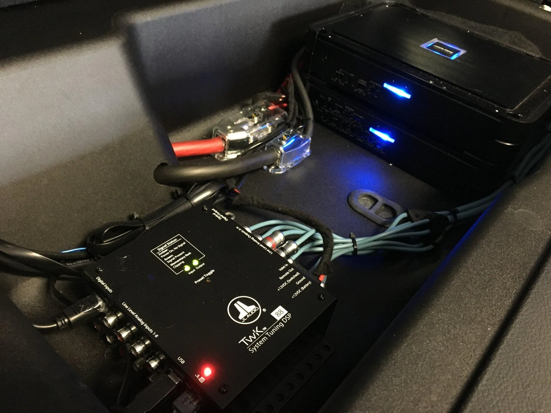

I highly recommend the Fix-86 along with that. You can call JL Audio tech support and they can explain in further detail. I had to do that recently to figure out if it was really necessary in the VW GTI system we did last week.
There are certain things the Fix-86 can do that the Twk-88/Vxi amps can't do. I forget off the top of my head, but I'm pretty sure it has to do with reversing factory time alignment. You can eq with with the Twk-88/Vxi amps, but you can't really "de-equalize" the factory set up, that's really what the Fix-86 does. Gives you a flat, clean signal to start with and that is key to any good audio system. Ideally, you want to use the EQ in your DSP to fine tune.
Yes, the 10 TW1 does a great job in the Wrangler's in the JL Audio stealth boxes. I haven't had one customer disappointed or one customer blow theirs up (although a lot of that has to do with tuning and set up on the amp so no distortion). The box shown with the two 10" TW3 is just a basic down firing enclosure. To keep costs reasonable, the customer chose this type of enclosure versus two custom fiberglass enclosures in the rear quarter panels.
If memory serves me correctly, we used a PDXV9 to power the interior speakers and stock sub (just in case he needed to remove his custom enclosure, he could still have some bass) and a PDXM12 to power the two JL Audio 10" TW3. The TW3 needs slightly more cubic air space than the TW1, but I do think it sounds more like a traditional sized woofer, sounds more like a regular W3. It's like the slimmed down version.
Jeep Wrangler JL Speaker replacement upgrade IMG_1604

That looks great. I would’ve thought the box would’ve been bigger. I could get away with losing that much room. I do like the TW3’s. I had 2 12” TW3’s in my BMW 5 series. I’m kind of leaning this direction now I’m going to tens in the TW3. Thank you very much
