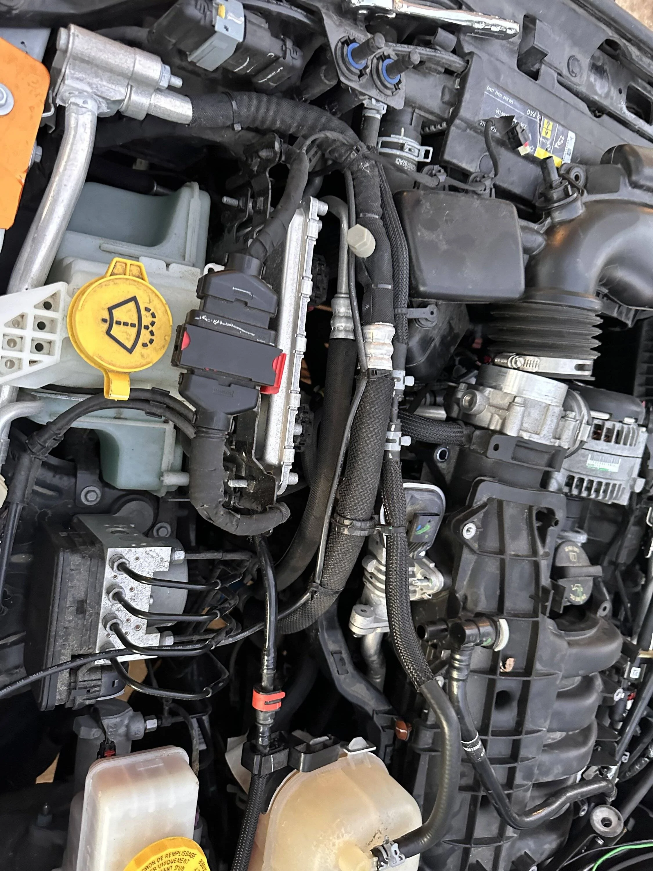

In the photo below you have to slide the white clip away from the yellow marks. Once it clicks, then take a very small flat blade screwdriver and insert it at the base of the clip and GENTLY work the connector away from the coil.
Take your time and work very slowly or you will break the connectors.
The aluminum clamps have to be removed to gain clearance by moving the hoses out of the way.
While you are there check the VVT sensor o-rings to see if they are leaking and replace them at the same time.
Thank you!! It’s kind of hard. I unscrewed the 10mm bolts holding on these metal tubes, but they didn’t budge much, the tubes have to actually be removed. I tried on the driver side on the tubes which are unobstructed and still couldn’t disconnect them.
You should not have to remove the tubes, just push them to the side. On the passenger side, remove all of the nuts/bolts holding the aluminum brackets, there are 3 sets of them if memory serves. It will give you enough slack.
On the driver's side, you have to disconnect the EGR tubing and move the EGR cooler tubing out of the way.
I changed mine when I replaced the oil filter housing/cooler. It is a royal PITA to do this work.
