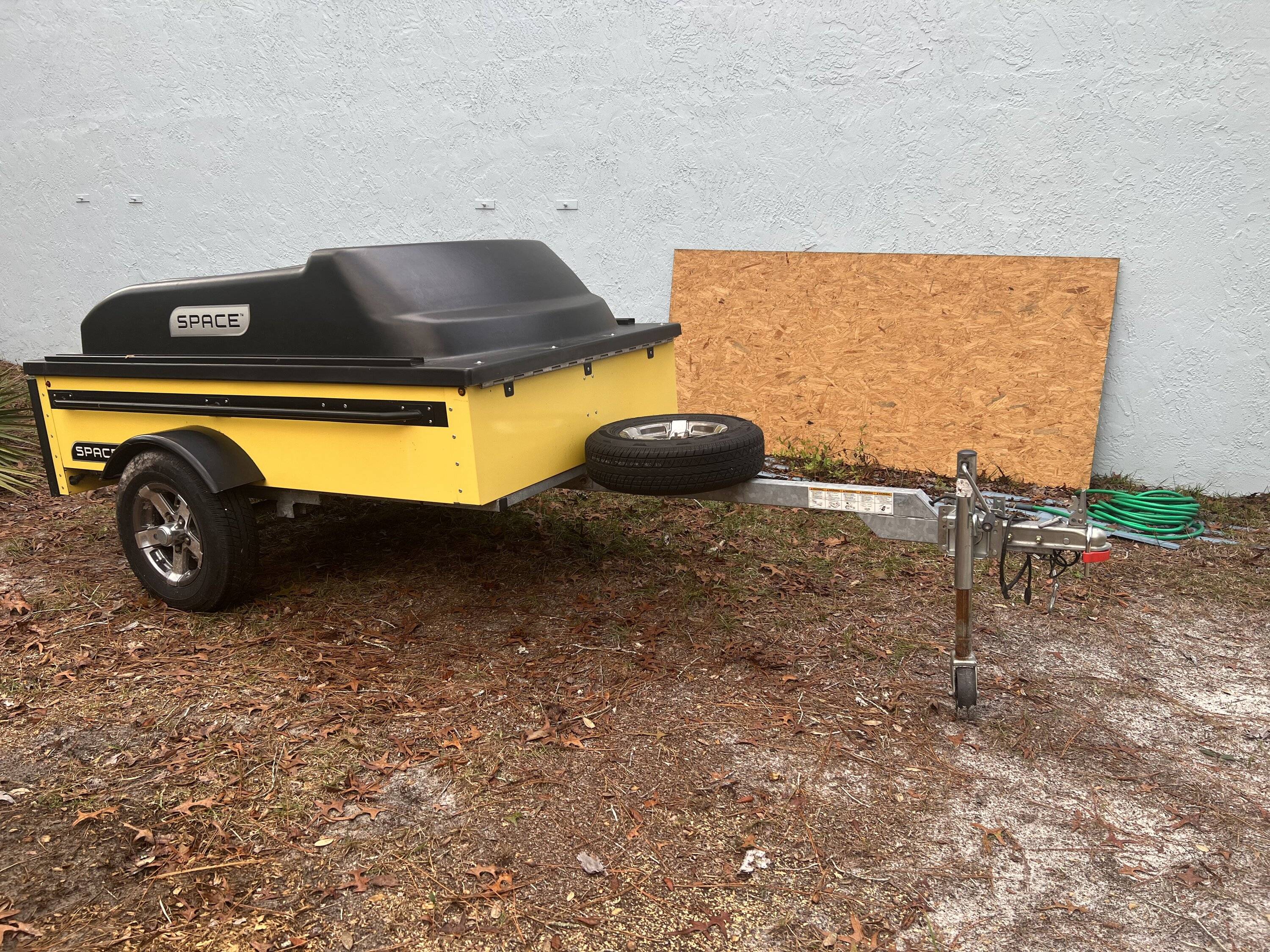

Got mine secondhand at an auction, great little trailer!

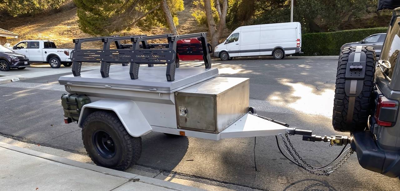

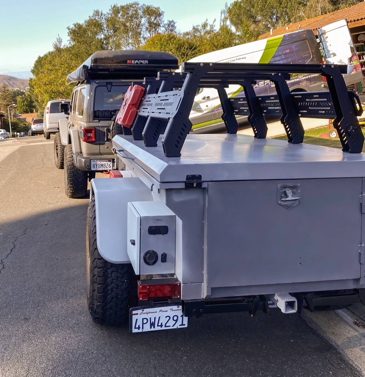

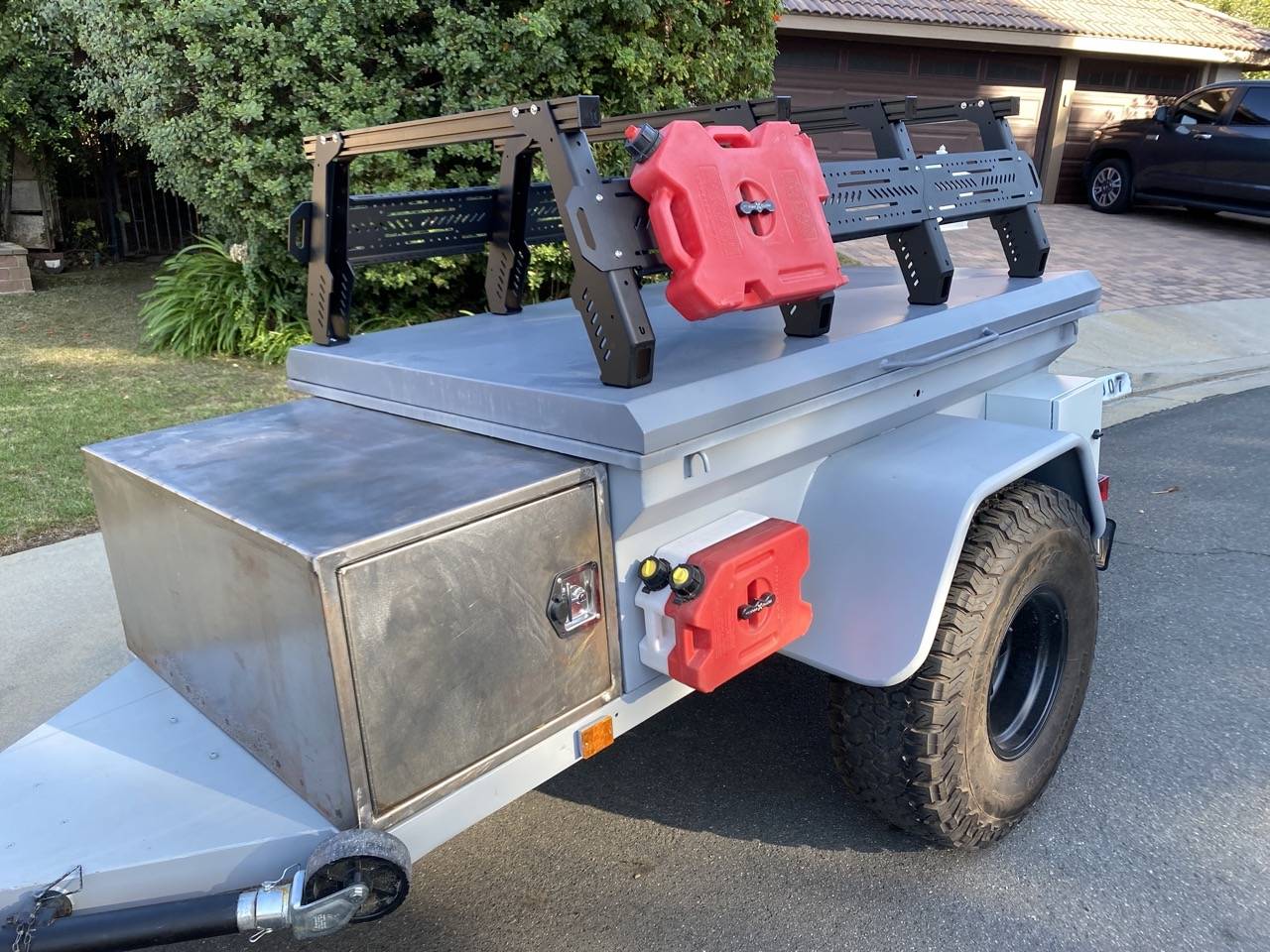

I have a similar setup and came to the same conclusion. After looking at Patriot, Turtleback, and a host of $30K-$45K overland trailers I decided I could build my own. I'm having a blast building it but I have to say it's a bit like remodeling a house, it will cost way more and take way longer than you think. But if you want to be away from the grid for anything over three days this is a great way to go.
Still not finished, took the RTT off the Jeep and making the brackets to mount it to the trailer:

Lots of questions on your trailer build…
-what storage box did you use on the front?
-what stabilizers are you using for the rear?
-what bed rack are you using? it looks like it’s universal which might help me with mine build.

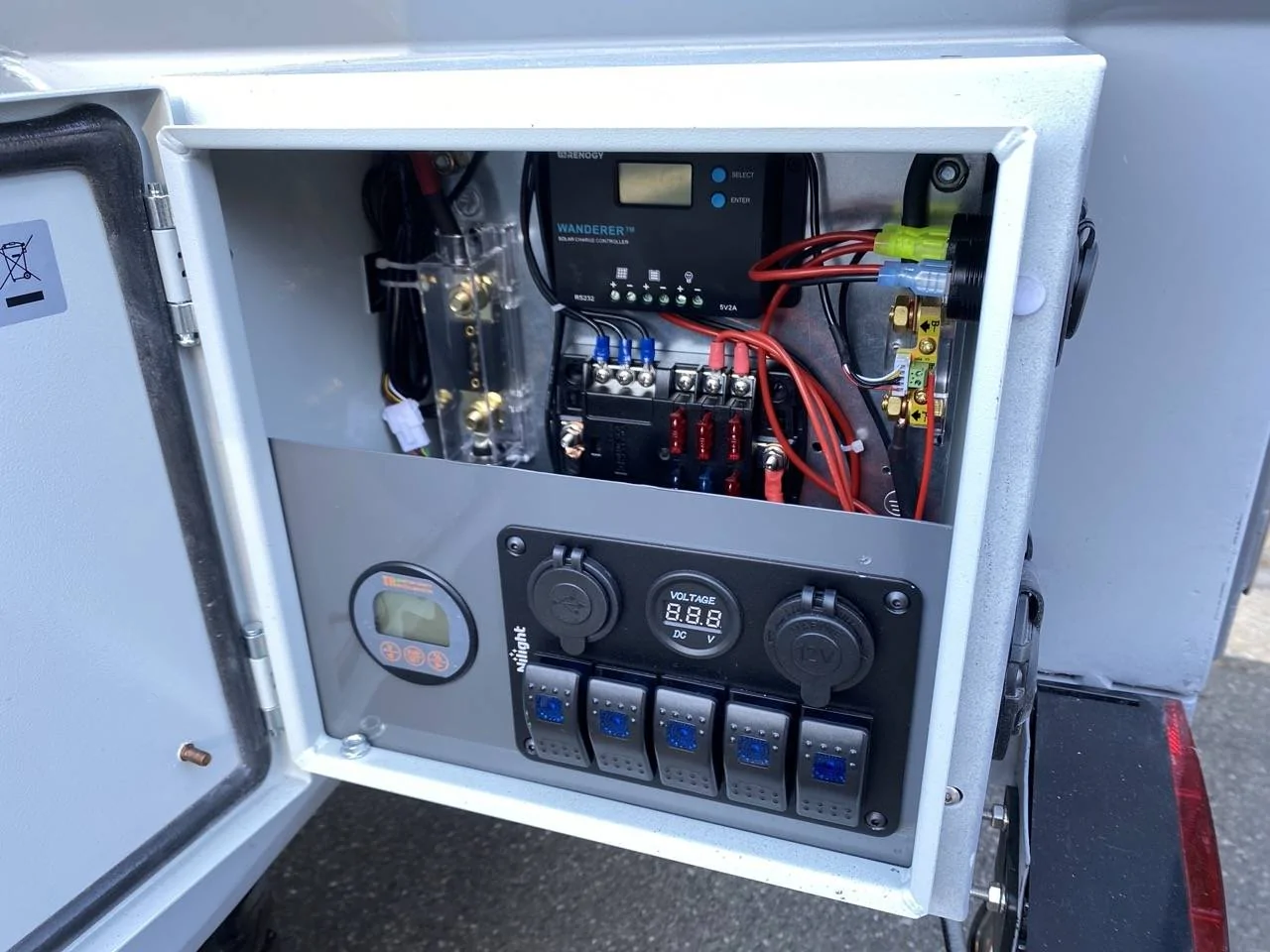

-what box are you using for the electrical panel?

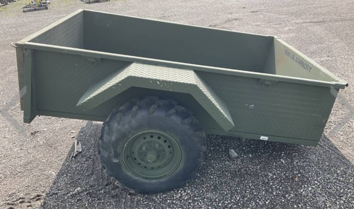

I am building a trailer as well using a military trailer I don’t have any specs on. I know from the auction I got it, that it’s from the local military base. It’s pretty light duty with mostly aluminum diamond plate and atv wheels/tires and a 1-7/8” ball.

The front storage box and fenders are custom built.
The stabilizers are from etrailer, I don't remember the model but its obvious which ones they are
The bed rack is from here: https://www.uptopoverland.com/collections/roof-racks
I originally purchase a cheap Chinese components off Amazon, spent a couple of days wiring it up, plugged it in and the fuse block went up in smoke immediately. I spent some time checking the wiring to make sure I didn't do anything stupid, when I opened up the fuse block a sodder had failed and shorted out. I replaced the components with stuff from Blue Sea, still might be Chinese but appeared to be much better quality.
