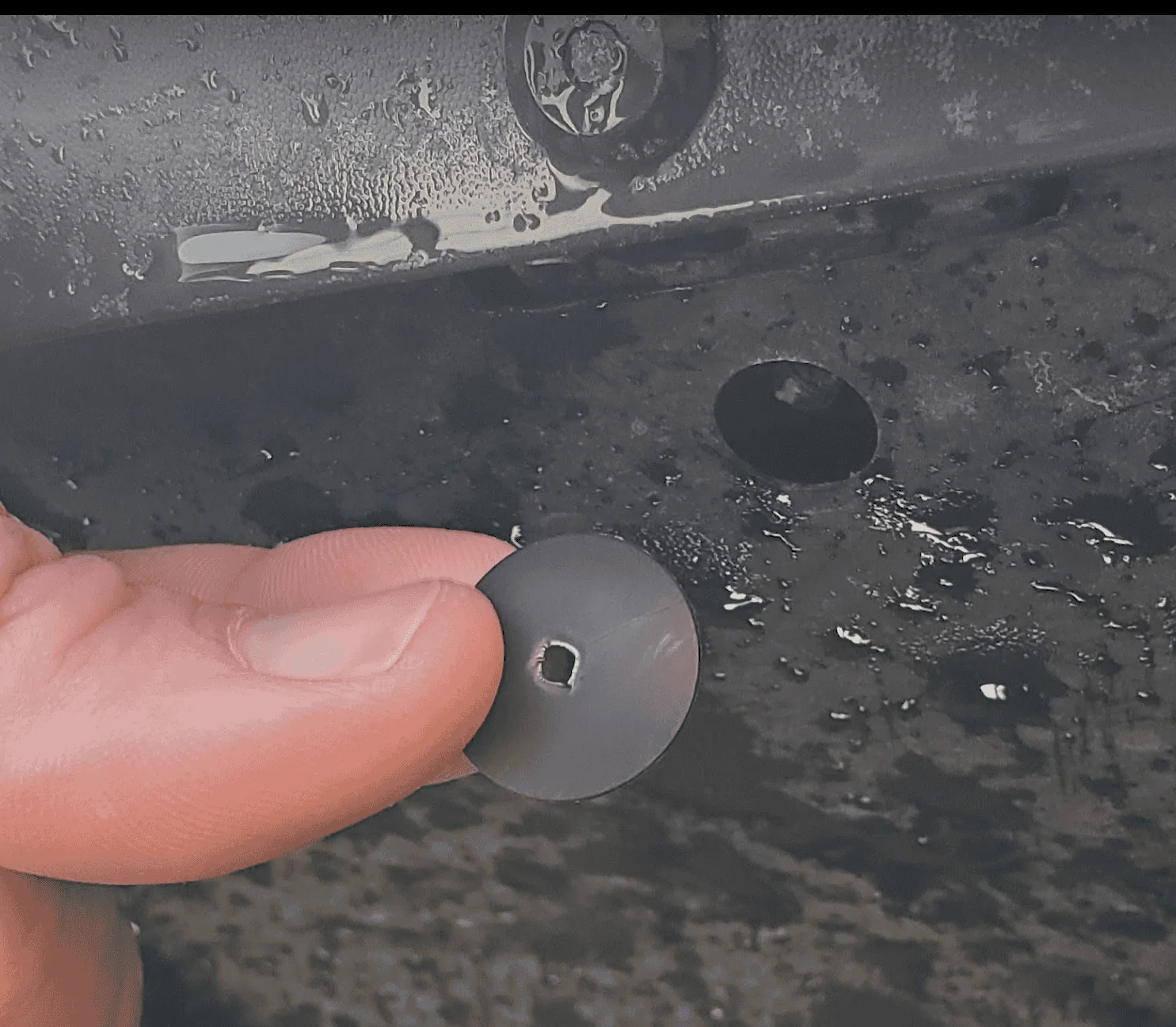

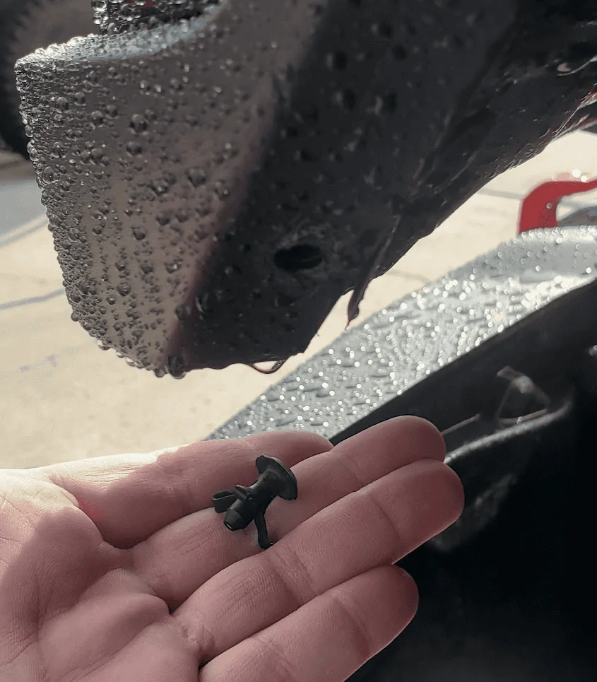

Where can I find replacement fender clips like these? I need them for a 2021 JLURxR. All the ones I have found are for other things, not these. The first one is at the front end of the fender. It is different because it has a larger "tree'. The 2nd image are the ones that attach the inner fender along the outside fender line. On both sides they broke when I had to pull the fender and liners.

The christmas trees are fender liner clips, and the flat ones are fender to body.
