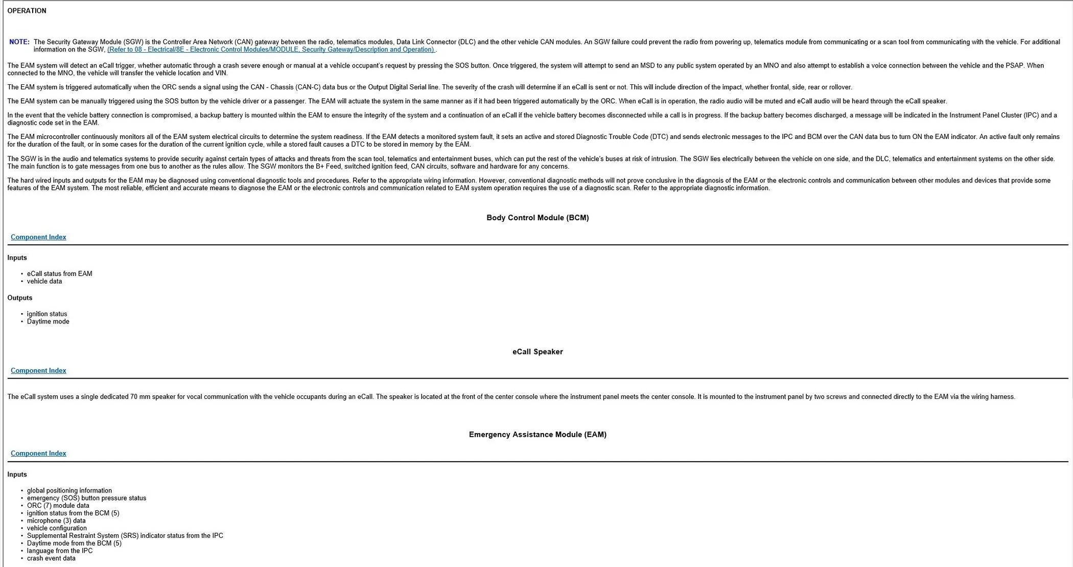

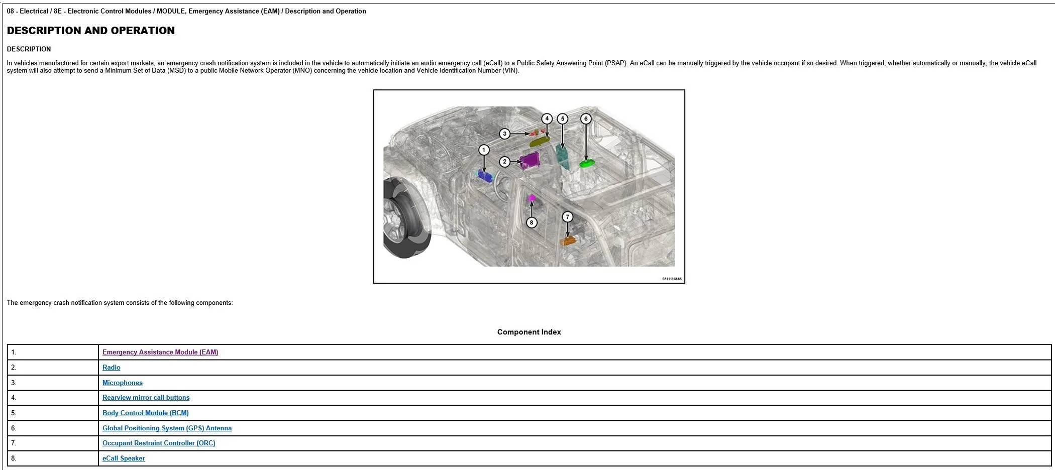

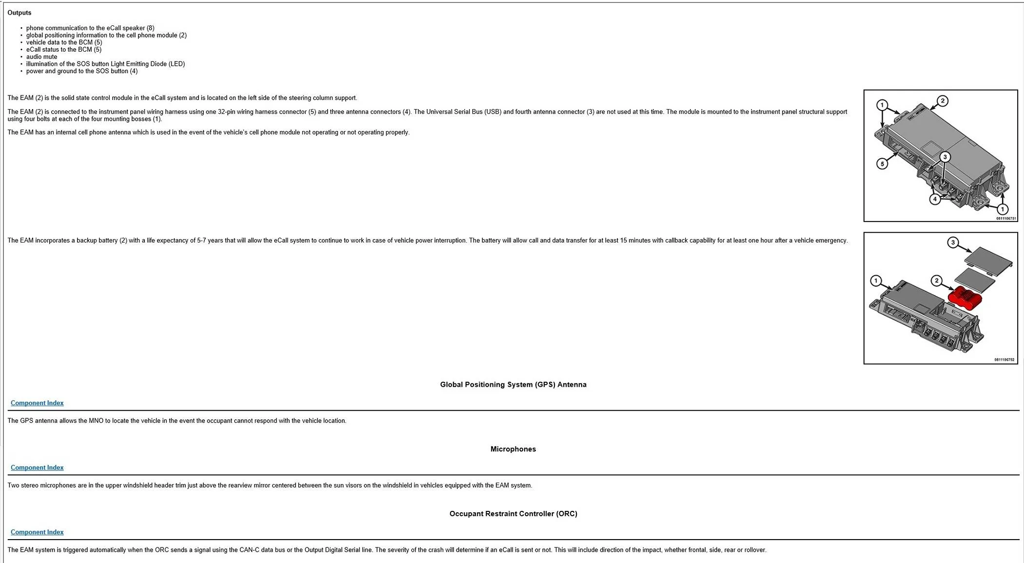

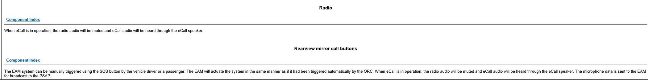

This is from my 2018 Service Manual
Jeep Wrangler JL SOS emergency button deactivation Jeep Emerg Assist Module1
Jeep Wrangler JL SOS emergency button deactivation Jeep Emerg Assist Module2
Jeep Wrangler JL SOS emergency button deactivation Jeep Emerg Assist Module3
Jeep Wrangler JL SOS emergency button deactivation Jeep Emerg Assist Module4
