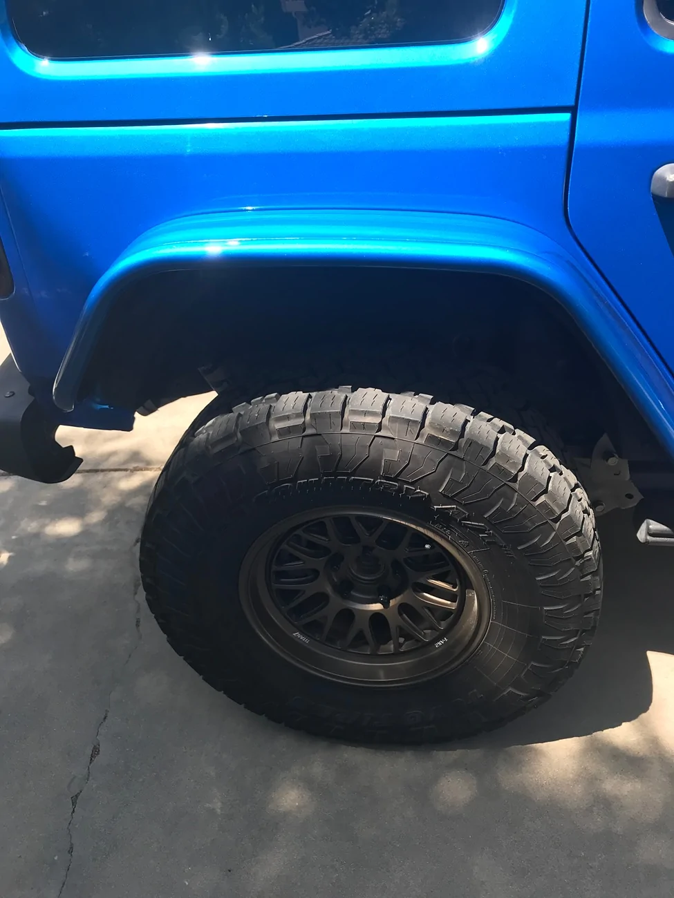

all but gave away the 33’s for $100 apiece and got 35’s because I don’t need no stinking 37’s
Jeep Wrangler JL Somebody talk me down from the ledge! IMG_2111
