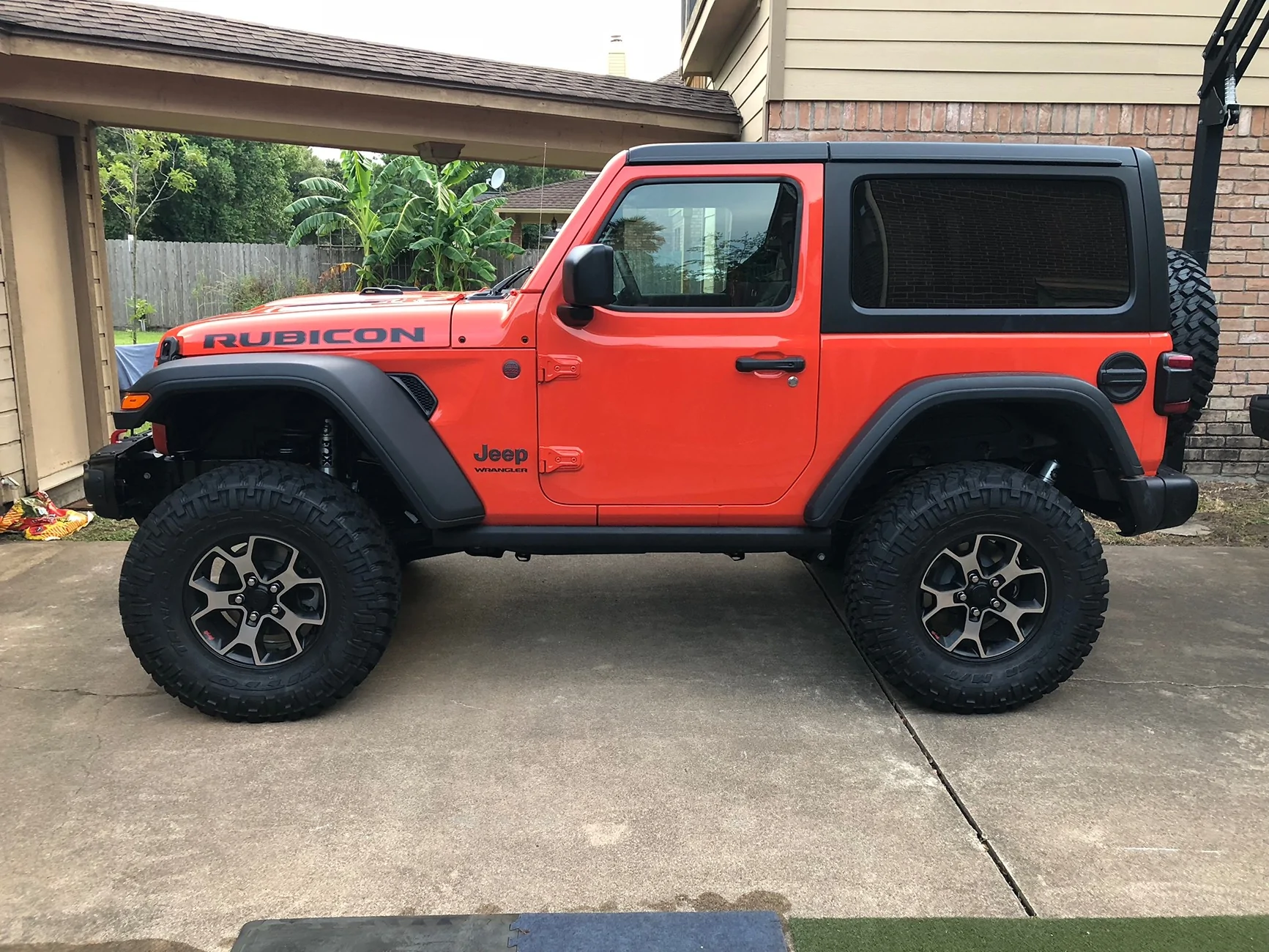

2018 JLR with 2" Mopar lift, 4.10s and 35s:
Jeep Wrangler JL Somebody talk me down from the ledge! IMG_0509

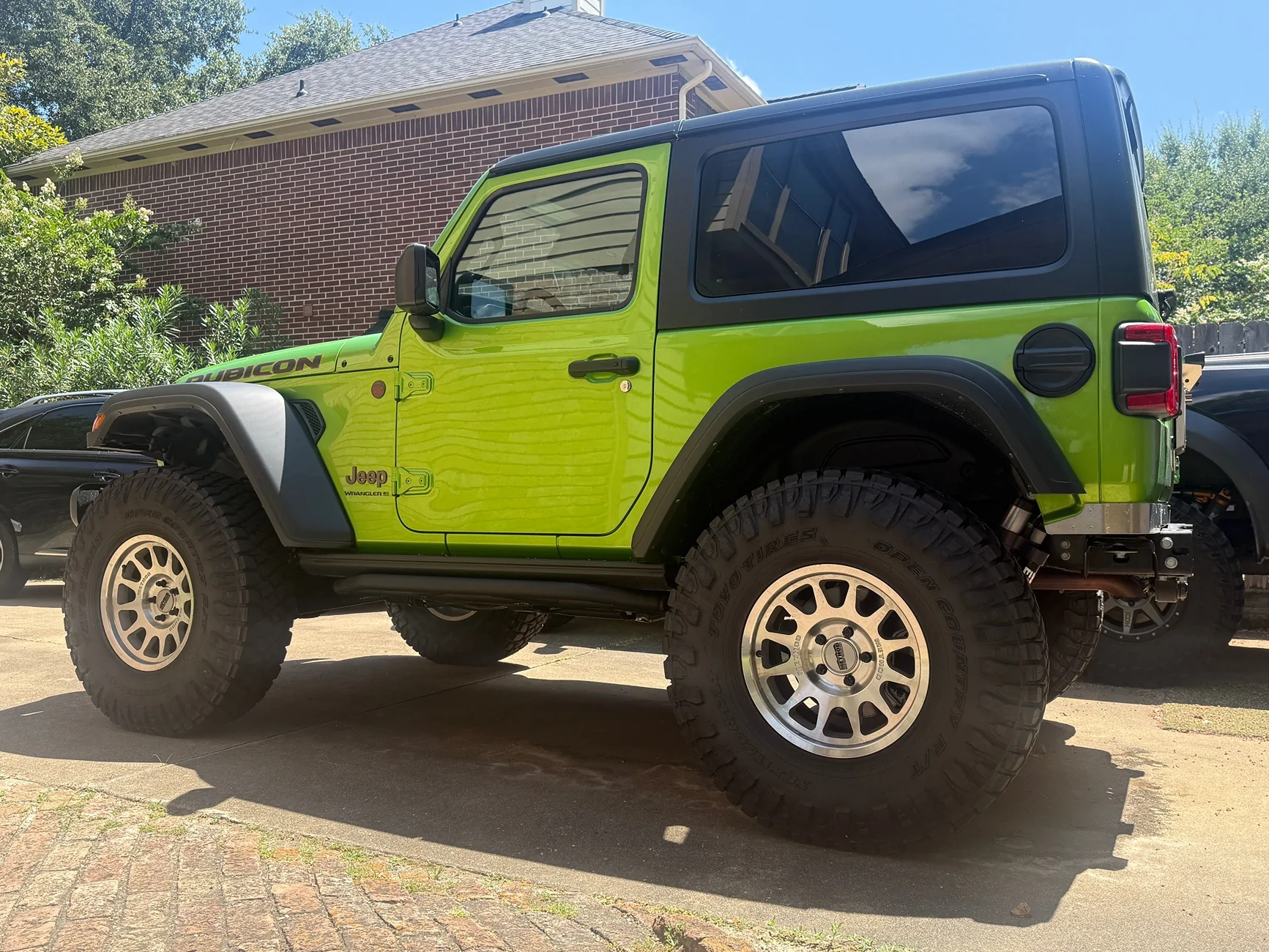

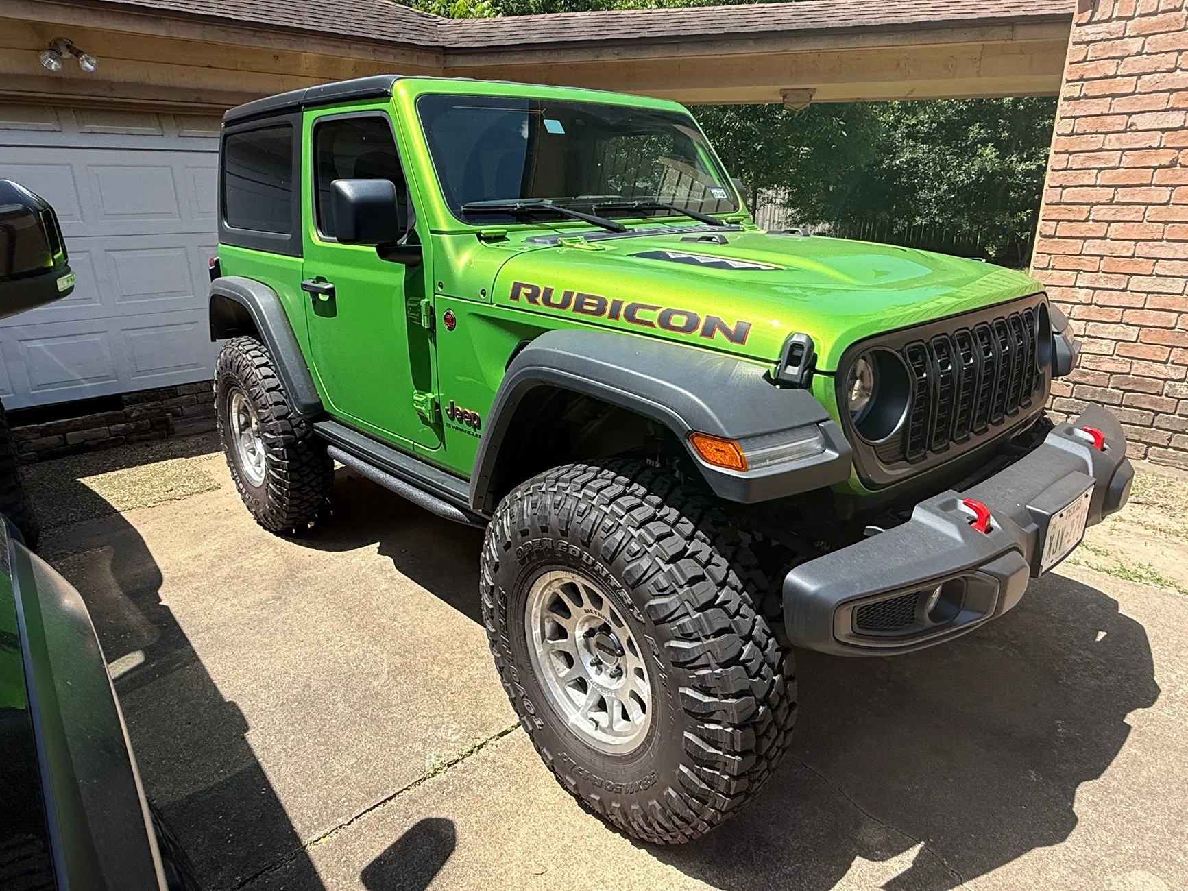

2025 JLR with 2.5" Terra-Krawler lift, 4.88s, 38s and other mods as well, a work in progress:
Jeep Wrangler JL Somebody talk me down from the ledge! IMG_0270
Jeep Wrangler JL Somebody talk me down from the ledge! IMG_0269

Maybe, in the long run. But tires are 38x11.5x17s. They only weight about 10lbs more than the 35" KM3s I previously had. Total tire/wheel weights are about 106+ lbs each (I weighed all 5). But the taller tires will still cause faster wear in the ball joints, drag link and tie rod. Everything is still tight but they are all on the list for the next upgrade. I'm not convinced I need one-tons at this point. But if it turns out I do, well, that will be addressed as well.

You are correct, sir. On the Orange 2018 above I was using 1-3/4" spacers. Spidertrax or some brand like that.
The 35" spare worked fine on both the 2018 (steel bumpers) and 2025 (plastic bumper). But when I went to the 38's on the 2025, the spare would not fit with the stock plastic bumper (if you can call it that-it's a piece of junk). That's why my rear bumper is off and the spare is in the back of the Jeep. I can't make my mind up between a spare tire carrier (with the hinge supports) or combo rear bumper/tire carrier.
