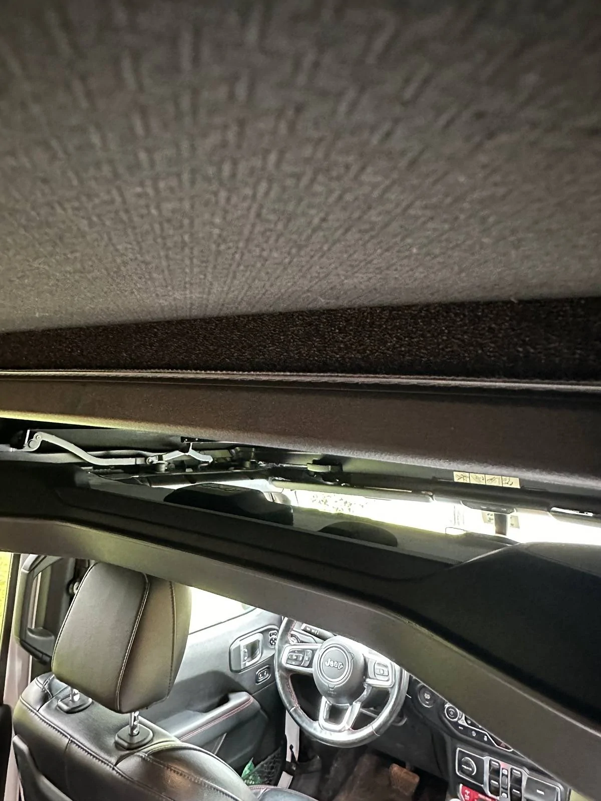

Did it work out for you? Assume you are just stuffing inside the rod pocket? Thanks for replying!
Yes, annoyed I waited so long ?
Depending on angle of wind hitting the car and speed I’ll get a slight rattle but overall it’s greatly reduced to totally eliminated. I can drive the jeep with the windows cracked or just one down and not be bothered.
So you stuffed the foam inside the channel/pocket? I'm going to go get that today.
May be hard to tell, but places across the beams where the fabric lays on top. Took a day or so for the foam to expand
