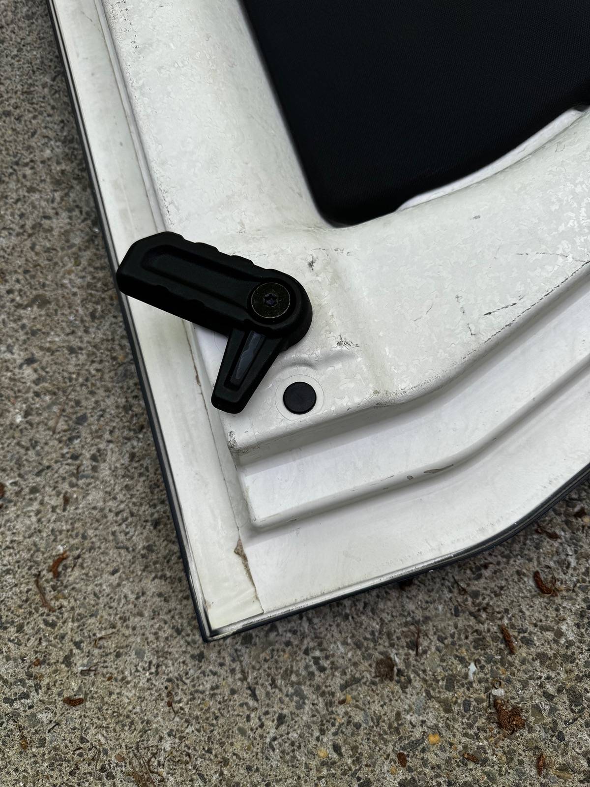

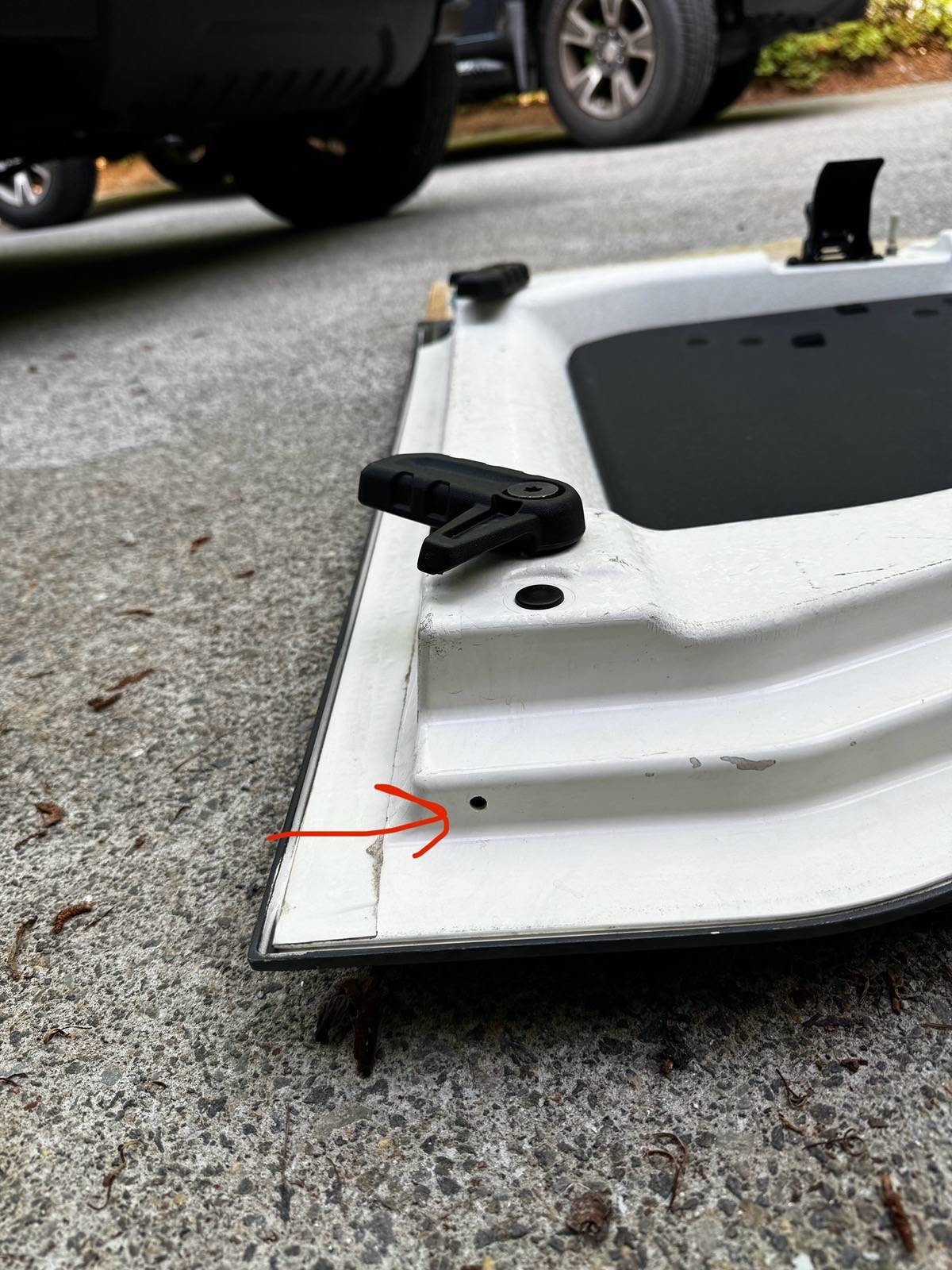

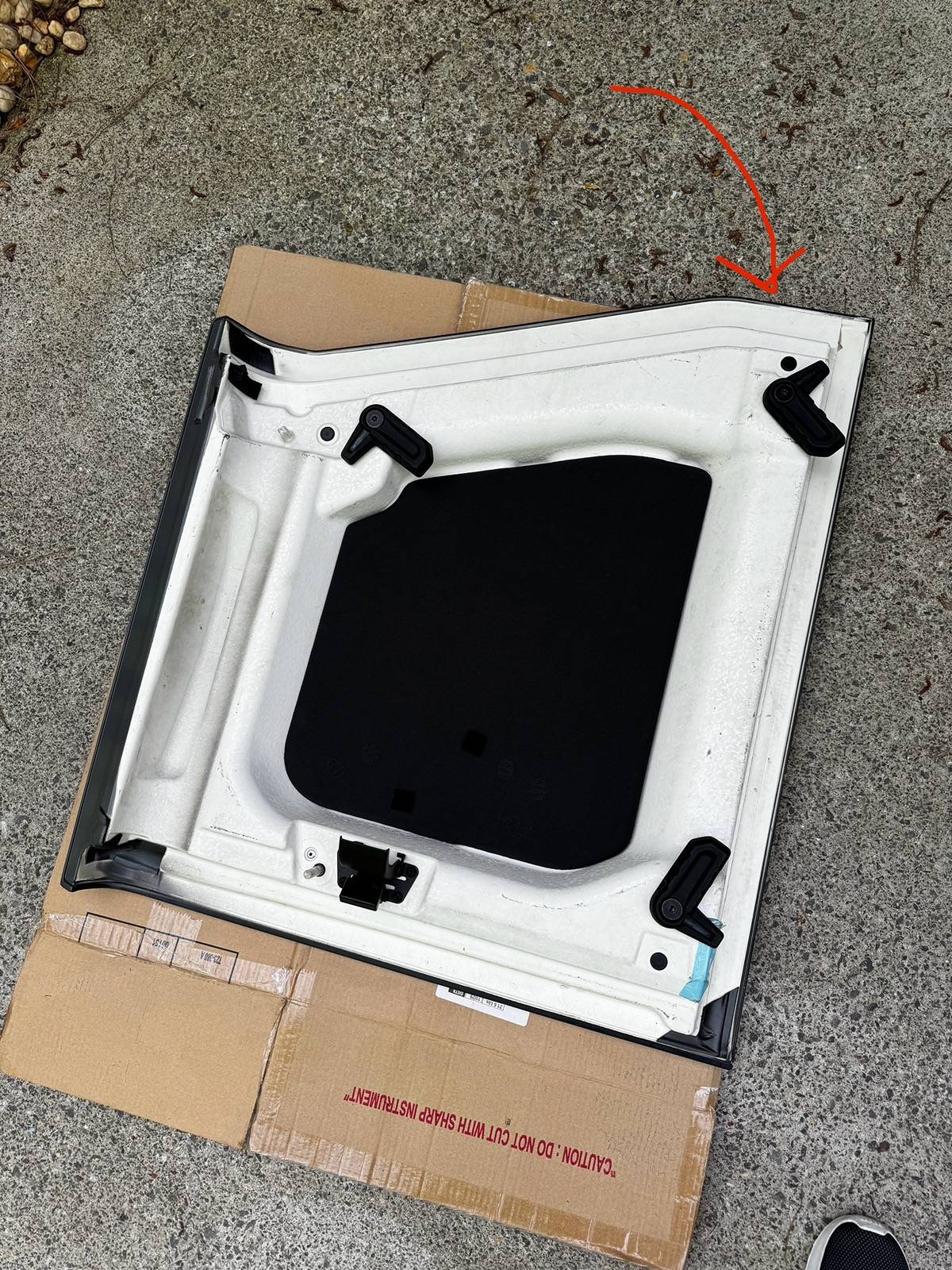

It’s pretty straight forward. I did mine on the driver side panel, but it’s the same for the passenger panel (just mirrored).
The hole is located in the back, towards the center of the panel as shown. You can use this to both fill up and drain the panel. It’s in a great position to drain as it’s the lowest point on the panel which guarantees a complete drain
The hole is quite small so a bit of patience is required to fill up the panel. Alternatively, you could pry open one of the black push pins, which reveal a slightly larger hole which made filling it easier. Just make sure to use a proper pry tool to avoid damaging the surrounding finish. I also recommend going around the plastic pin with a knife to loosen it from the panel.
Once halfway filled, you can slosh it around and drain it using the side hole. That’s all there is to it. Best wishes with your freedom flush!
Apologies for the out of order pictures, I don’t know how to fix it ?
