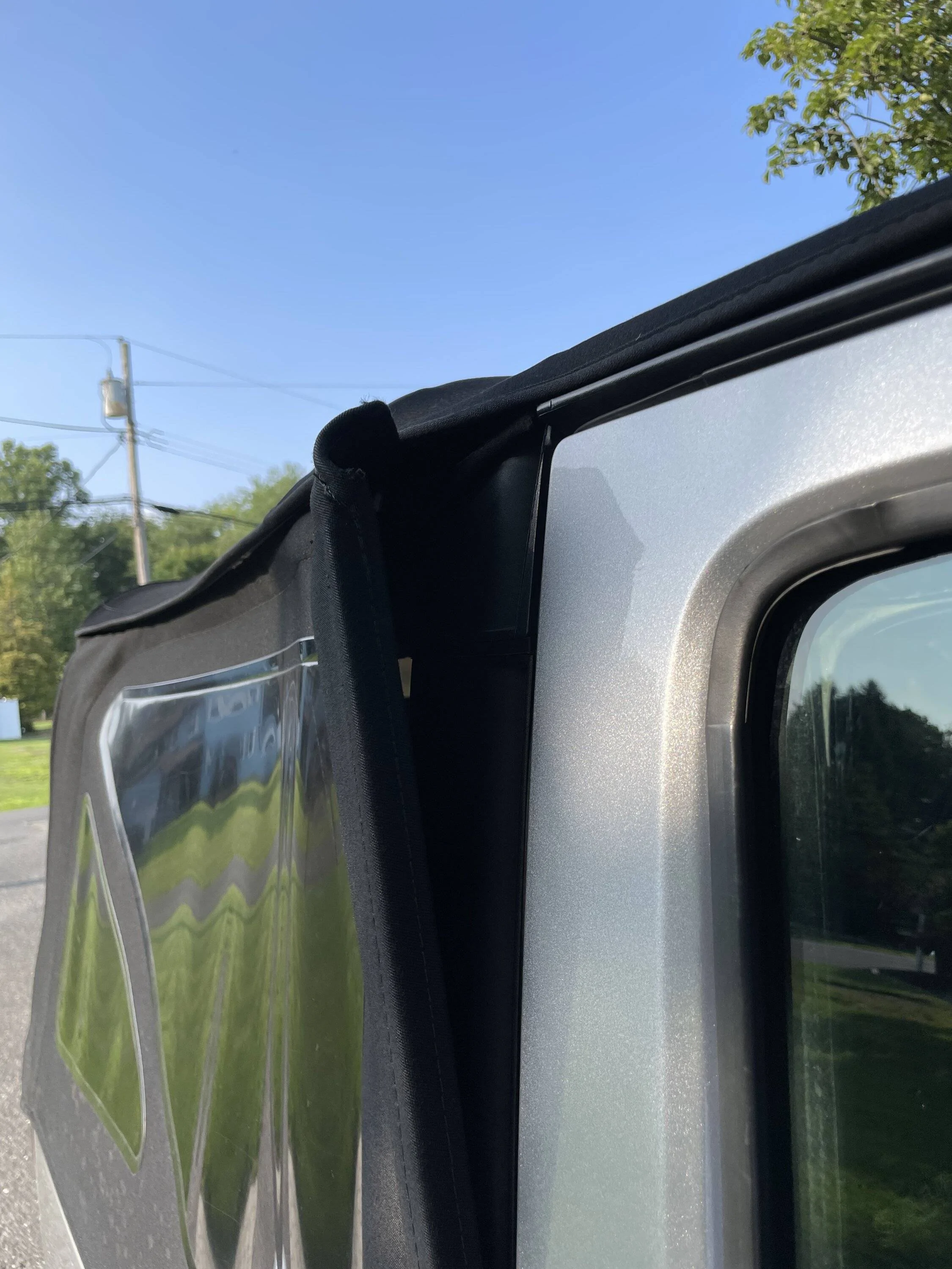

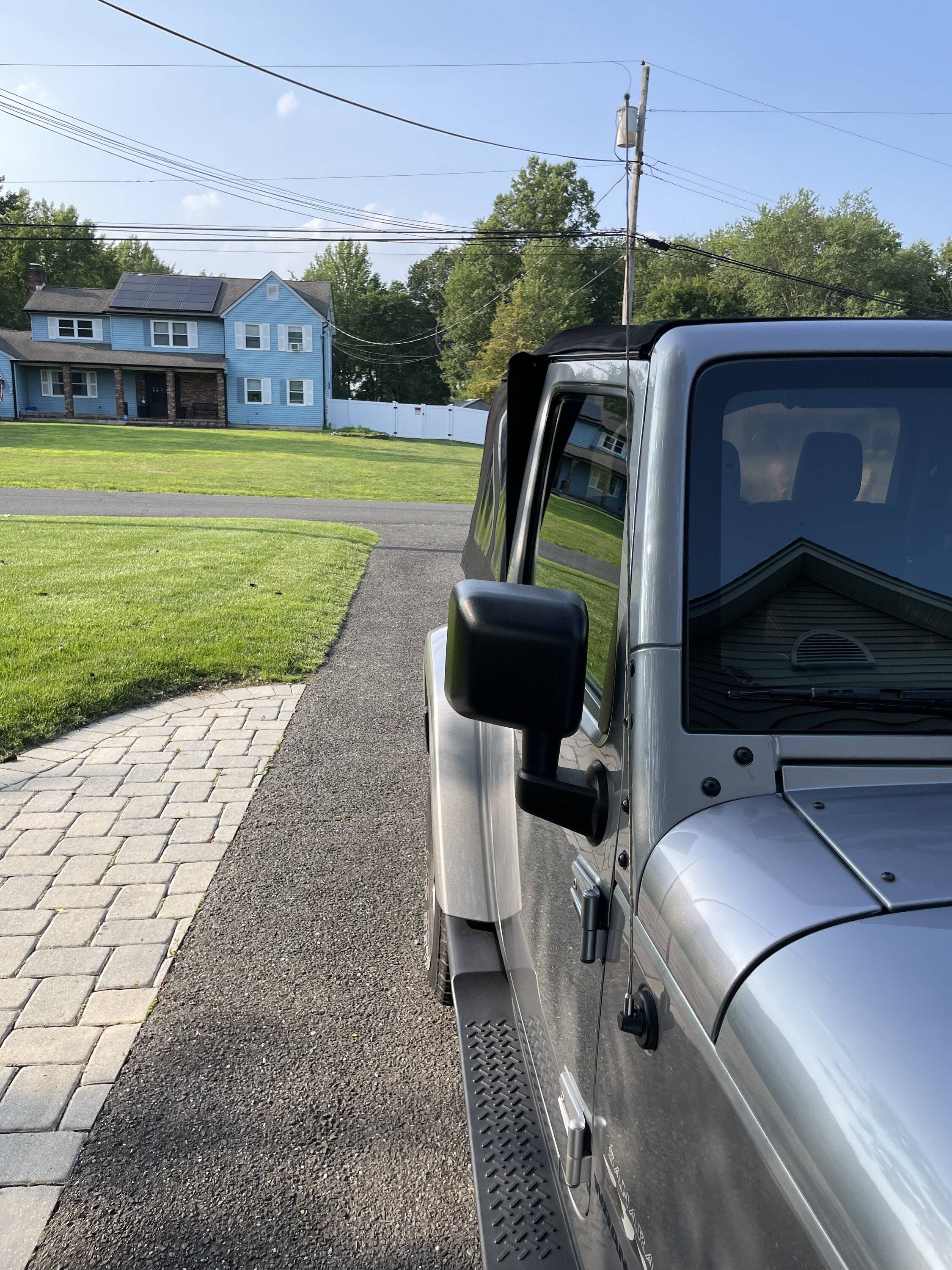

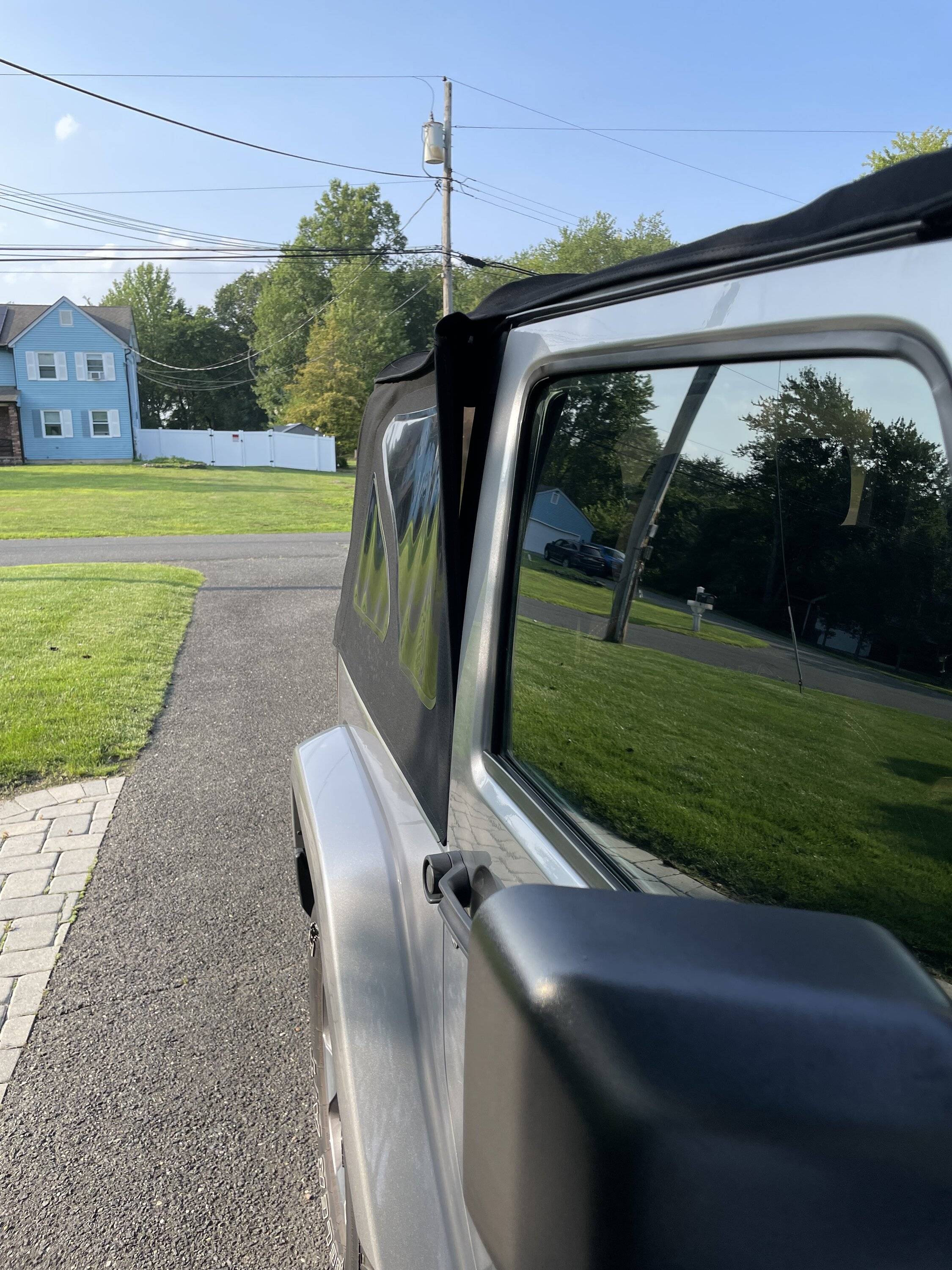

I have a 2016 jeep wrangler with a soft top roof. The part of the roof that slips into the ridges on either side of the door never seems to stay flush. I always tuck it in, but after every drive, the wind Kicks the edge of the cover back so that a little flap is hanging out. Very annoying. Has anyone else see this problem? Any ideas how to fix?

The window isn't in the plastic door channel correctly. The front edge basically needs to make a 180* turn to get tucked in properly.
Also, tuck that front part in before you zip it.
