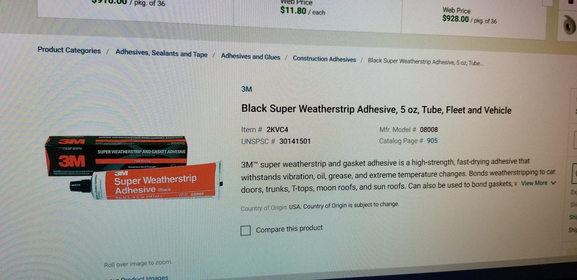

For small hole - fill it in with black weather strip adhesive.
Its flexible and blends in.
Align tip of the tube with a hole, holding from underside, with slight tension (push up) so hole puckers up. Squize a bit out so adhesive comes thru the hole and pull tube back down.
Wipe off any overage with your finger
