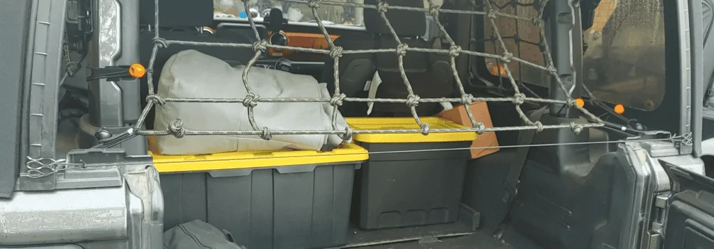

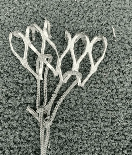

I took a couple of small pieces of expanded metal (it was what I had on hand at the time) and bent them to form a hook. I attached them together with a piece of nylon cord. I set the cord tight enough to hold the side windows in place.
Jeep Wrangler JL soft top corner post 1682616919162
To install the kit, I slide it in from the top of the back wind channels after removing the back window. I then push it down to the bottom of the channel. I typically have the tailgate piece in place and will put the rope inside the channel to help secure it.
Jeep Wrangler JL soft top corner post 1682616955039
Have run this set up on the highway at speed and around town. The rope keeps the side windows in place as if the back window was in place.

that looks like it might be worth trying. easy enough to make, and easy enough to put in place when you need it.
