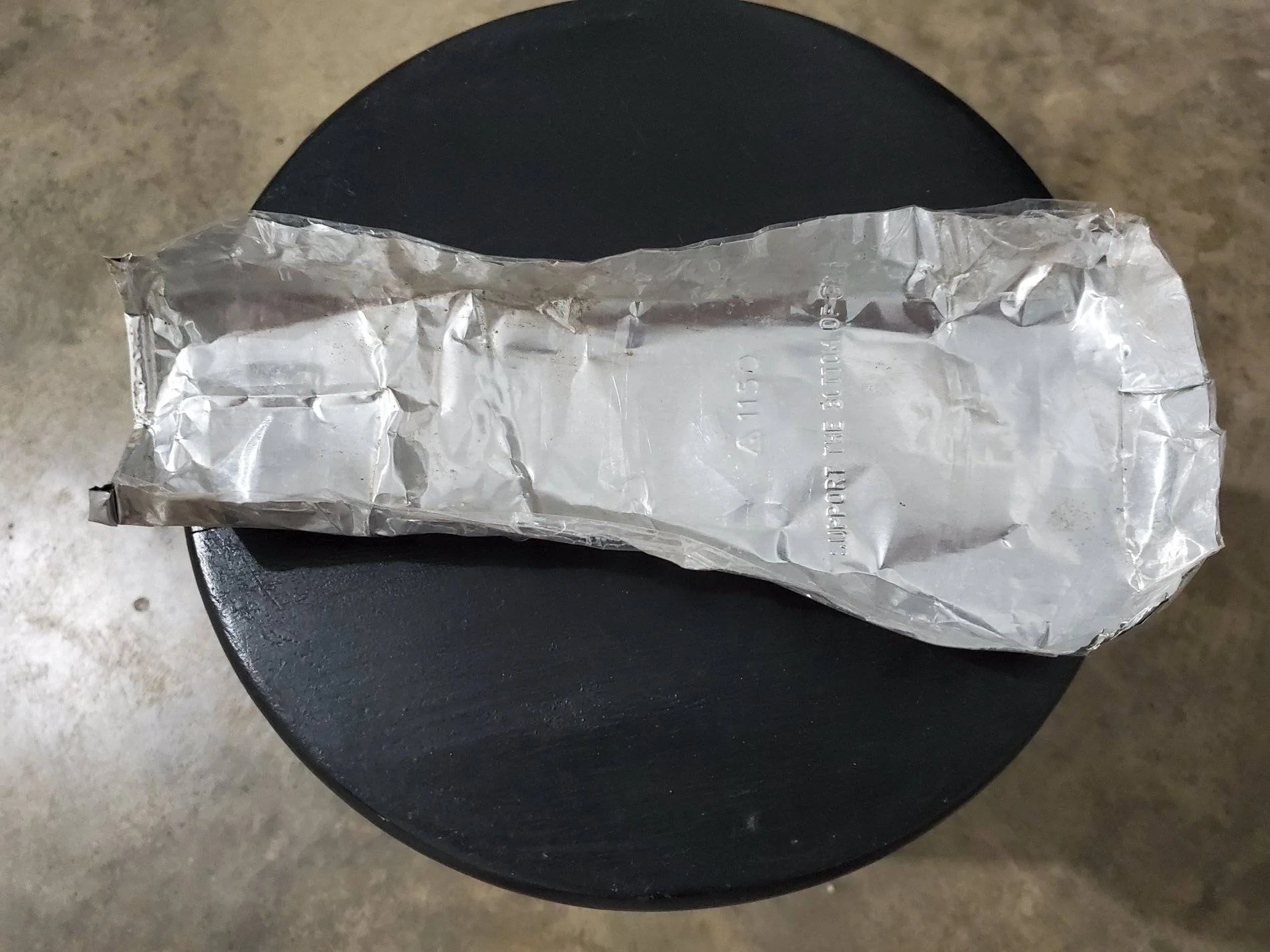

I do lots of diff & transfer case fluid changes each year. ...on my own JL and on JL's, JT's and JK's whose owner's pay me to do the deed for them.
With the issue you experienced, in mind,(It happens) I do not pull the skid plate. I can do the deed without pulling the skid plate, without making a mess and in less time..
See the pic below....You place this between the drain hole and the skid plate.... you pull the plug and the fluid runs along it, and then into the drain pan. Again. no big mess on the skid plate and no pulling the skid plate.
This is an aluminum foil pan you get at the dollar store, etc.. You just cut the shape and fold up the edges. It's about say 16" long and about 4-5 inches wide. Easily cleaned when you get done so you have for next time...
