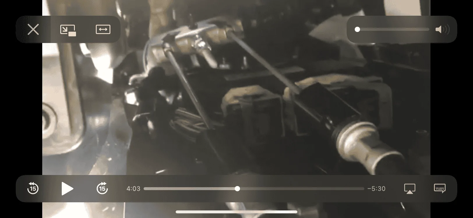

Jeep Wrangler JL Snapped Hand break B4DE487B-C9CD-42CC-895B-5708912286ED
Here’s a crappy screengrab I still had. The 2 cables come up through the floor into the center console and connect to a bracket. One can slip out of the bracket and cause you to lose tension.

Watch the video that the person above me posted! It's a very easy fix if you follow this video. One note: there are two t-15 screws on the top inside of center console lid that he forgets to tell you to take out.
My right-side cable slipped out of the housing twice since I have owned it. Bought a $2.99 deep 10mm socket. from Harbor Freight. It took me 45 minutes to fix it the first time, and 30 minutes the second time (I didn't tighten the nut enough the first time). Most of the time is getting the bolts out of the console. Loosening the nut, re-seating the cable, and tightening the nut takes only a minute). Take a lesson from my experience and error towards over-tightening!

OK. This is an update
Spent the past 2 months without a break, everyday saying I will do it tomorrow ?
Anyway, I just attached it today, the procedure took no more than 30 minutes following the video instructions
Both cable were deattached. Wasn't able to attach it initially, so I needed to loosen the screw (about 4-5 full turns)
Everything is going fine now
