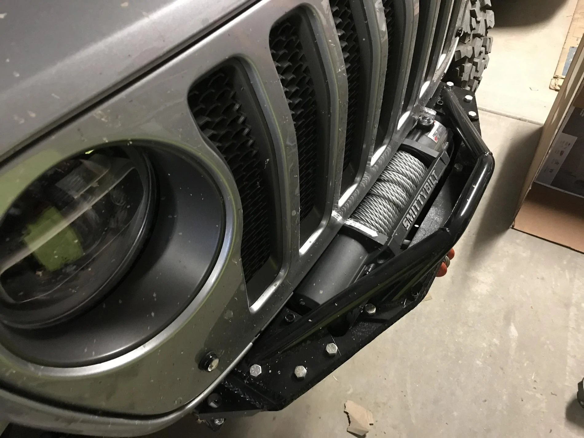

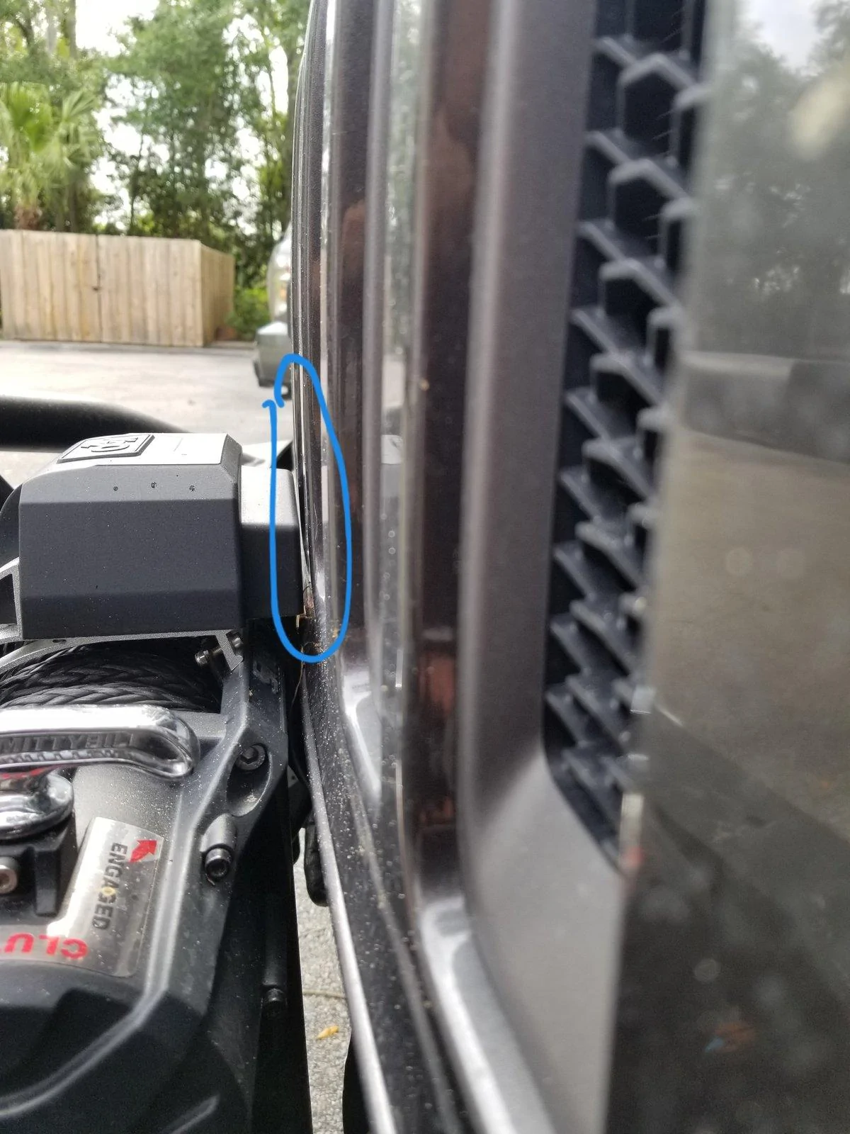

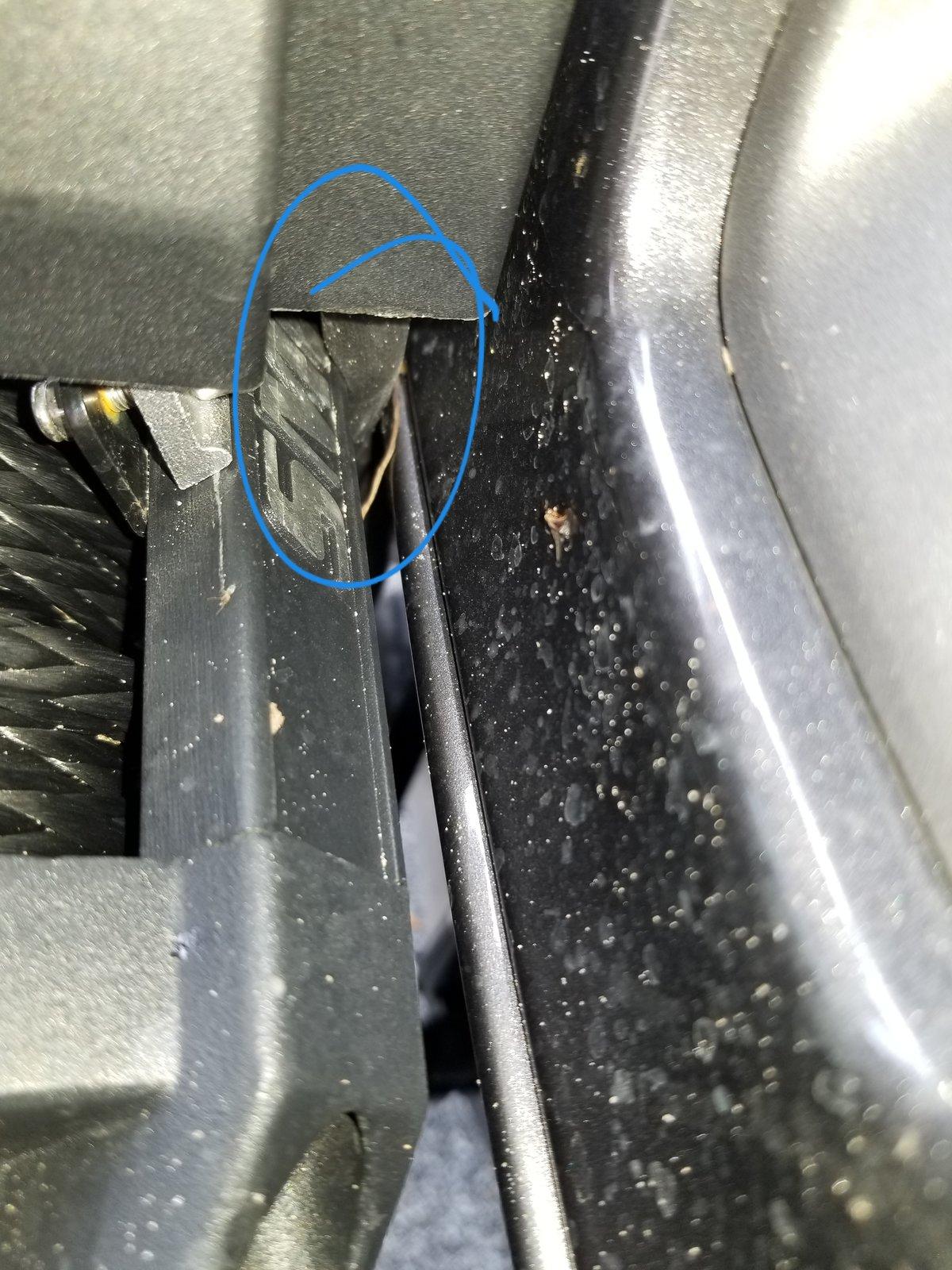

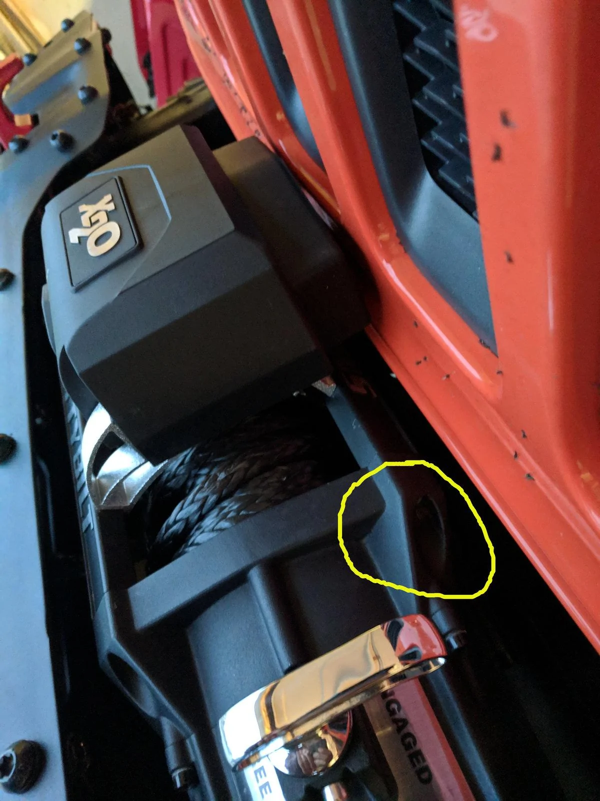

I have mounted mine to the side on a temporary bracket until I make a better one... I'm using the new Rusty's winch plate which has a forward angle to it. I chose this plate specifically because it also allowed my to mount a Draw-Tite front hitch receiver below the bumper, but the X2O power cables get pinched against the front grille.

Does the Maximus 3 plate "relocate" the winch? The built in mount is not moveable. its all one big welded piece with the bumper
I believe the winch plate mounts the winch lower and maybe a little forward in the factory bumper which may explain why my wiring is just below the grill and I dont have rubbing issues with the control box because it sits a little more forward in the opening.
I can compare once my wife gets her one piece bumper (hopefully today or tomorrow) and I mount the same winch to see if I have the same problem with hers as you and others are as well.

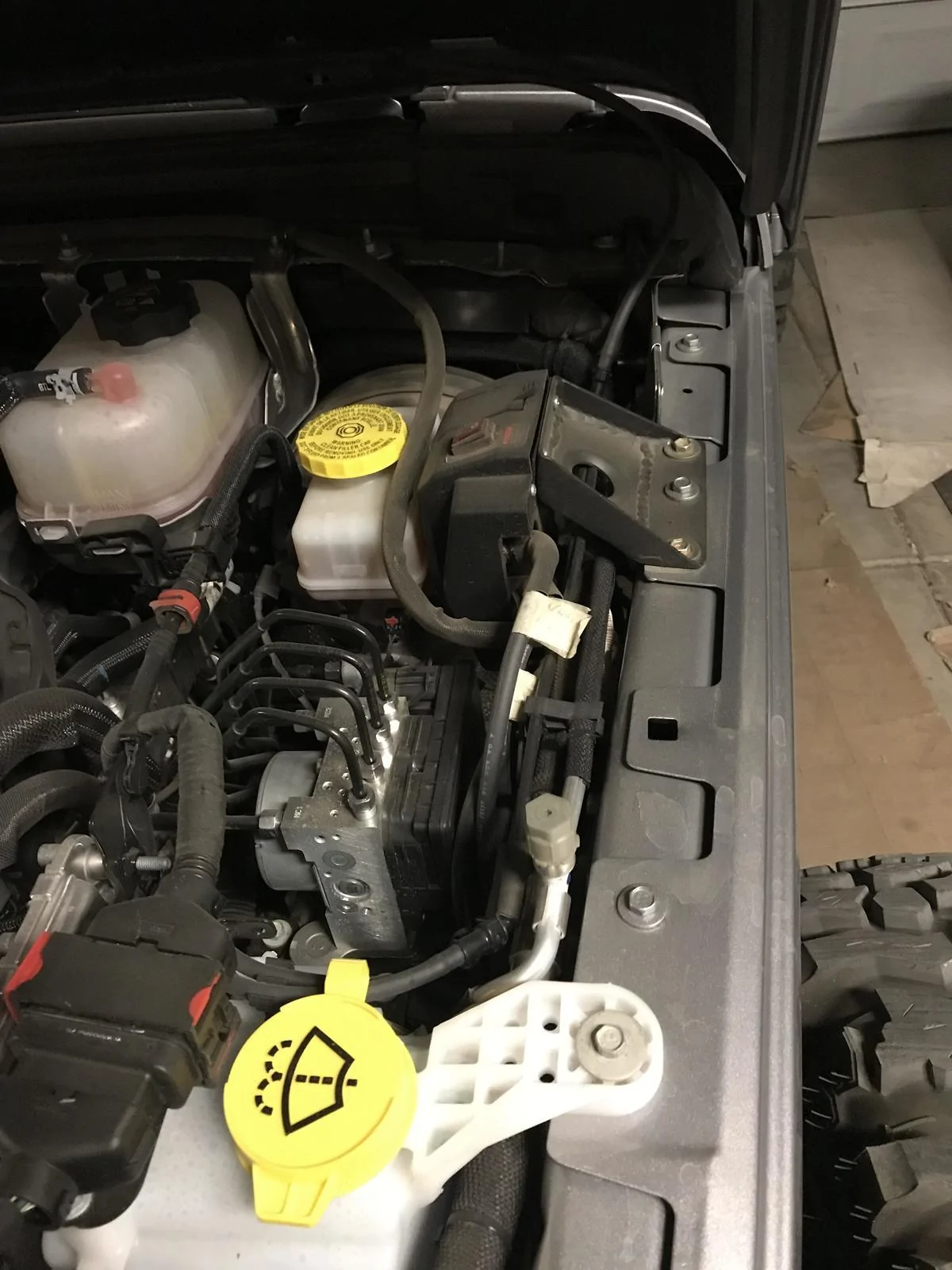

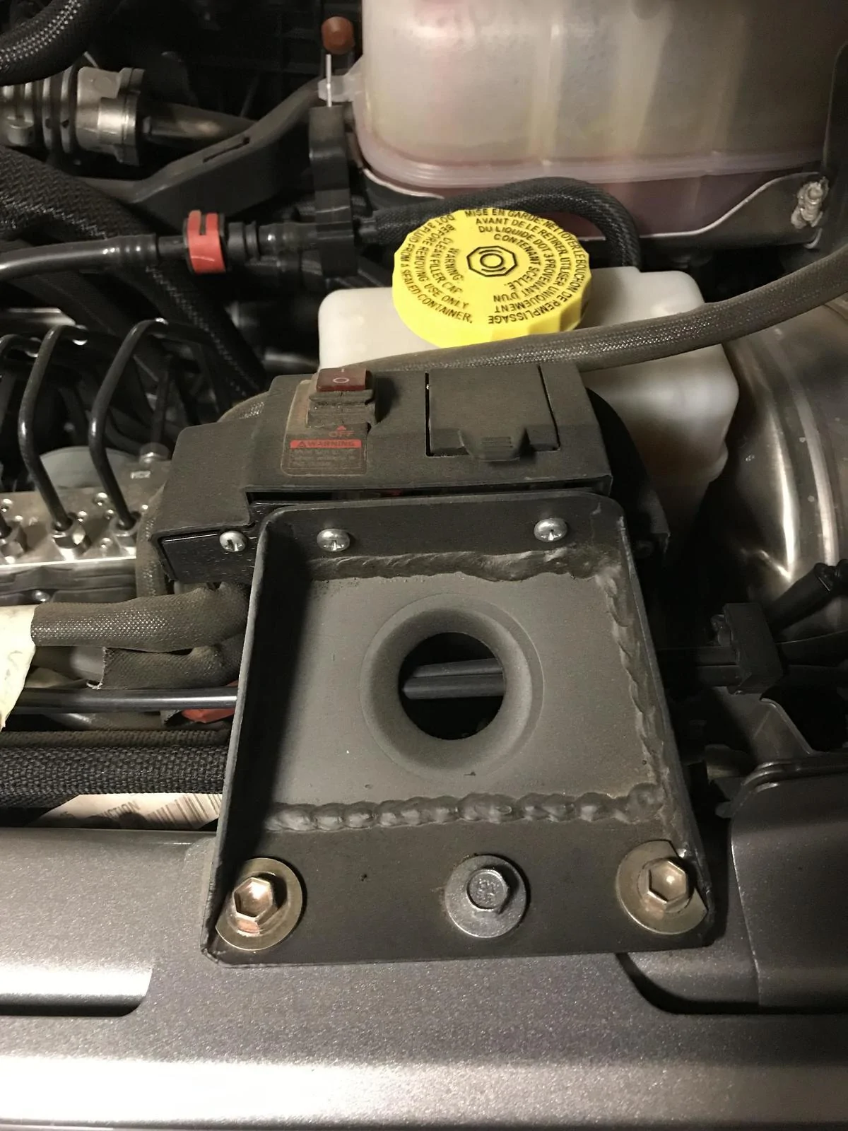

Not sure why people mount them on the winch anyway...that's the beauty of the non-integrated solenoid. Mine's mounted under the hood next to the brake booster.
Mind sharing pictures of your setup? Thanks.
