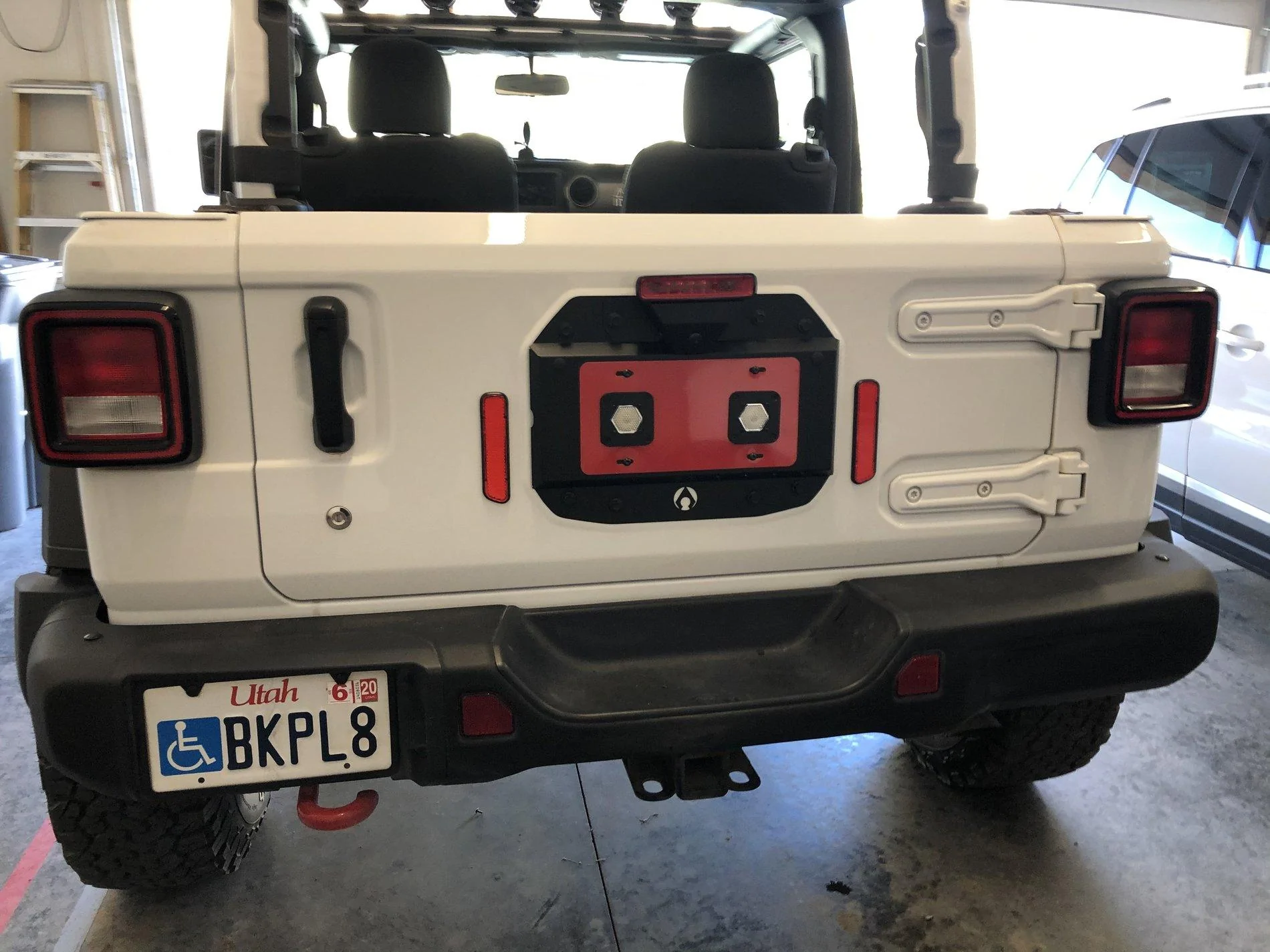

I just did a spare tire delete and mounted two S1 scenes. Got light now1
Jeep Wrangler JL Small Pods As Reverse Lights 46AB0D6E-F440-4553-977C-AC07ACC01648
no downside - do it

Looks nice, man. Did you wire them to the reverse light circuit or to a separate switch?
