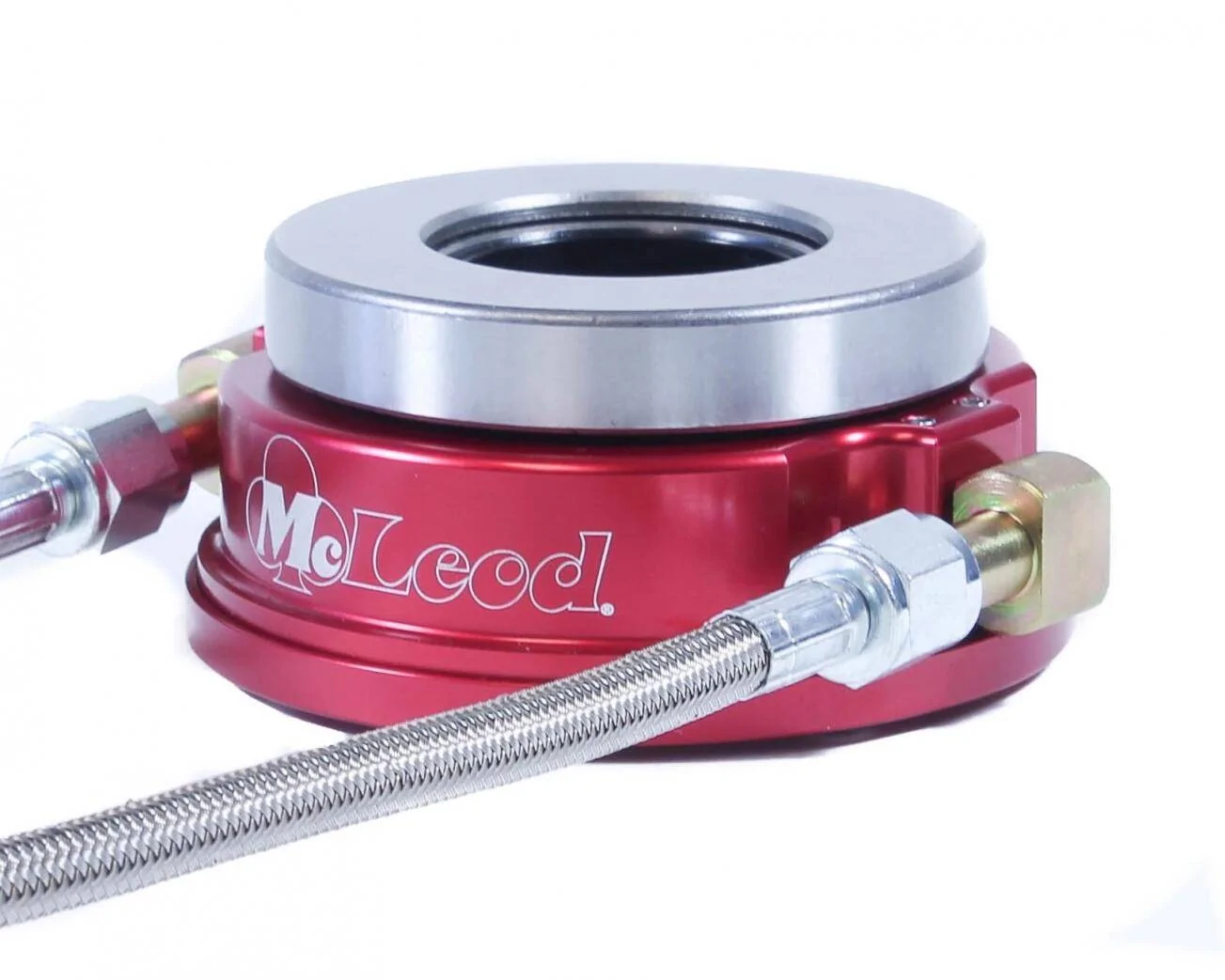

There is only one .............But, It does not work with self adjusting clutches . Its McLeod Racing Clutches, they utilize a similar 11" clutch like ACT..................Maybe ACT could Chime in if it could work with their clutch assembly.
https://www.mcleodracing.com/1400-series-bearing/p105
The McLeod bearing doesn't work with the ACT or OEM setup because they designed it to work with their JK flywheel and pressure plate, which they now offer for the JL/JT. The stack up height of the JK flywheel/clutch is shorter than the JL/JT so the bearing will be too tall to work with the ACT or OEM parts.
