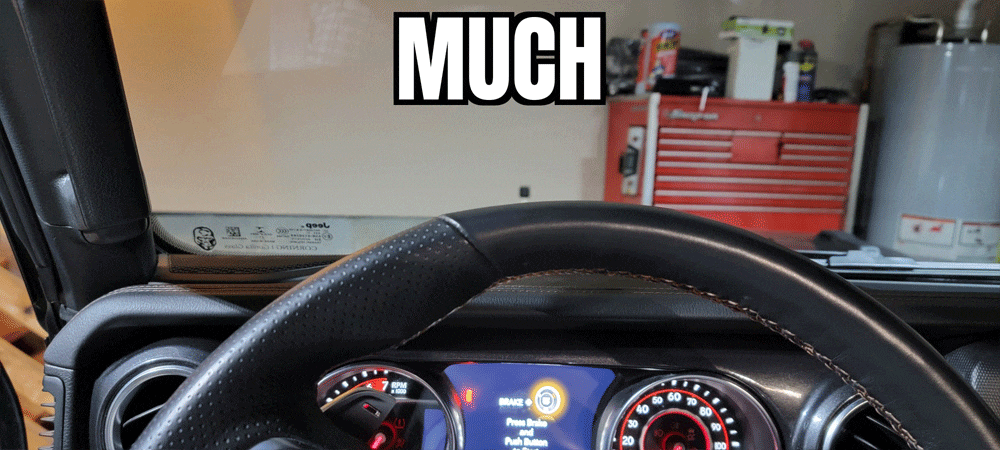

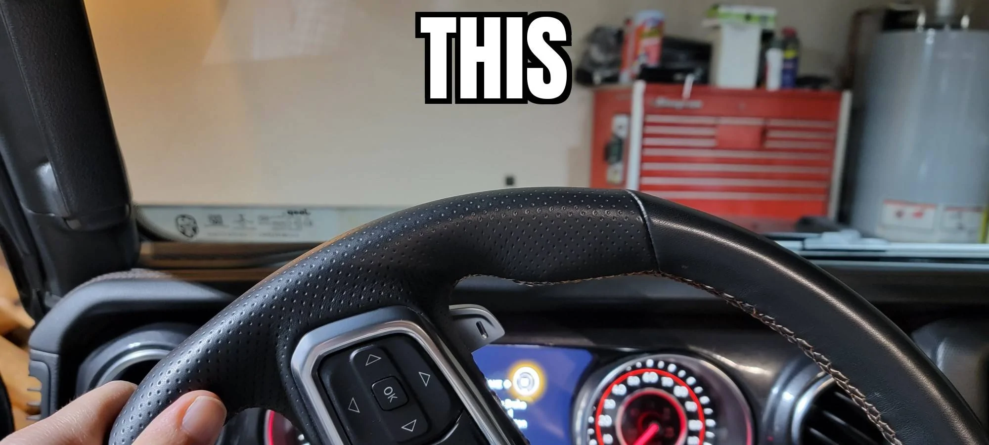

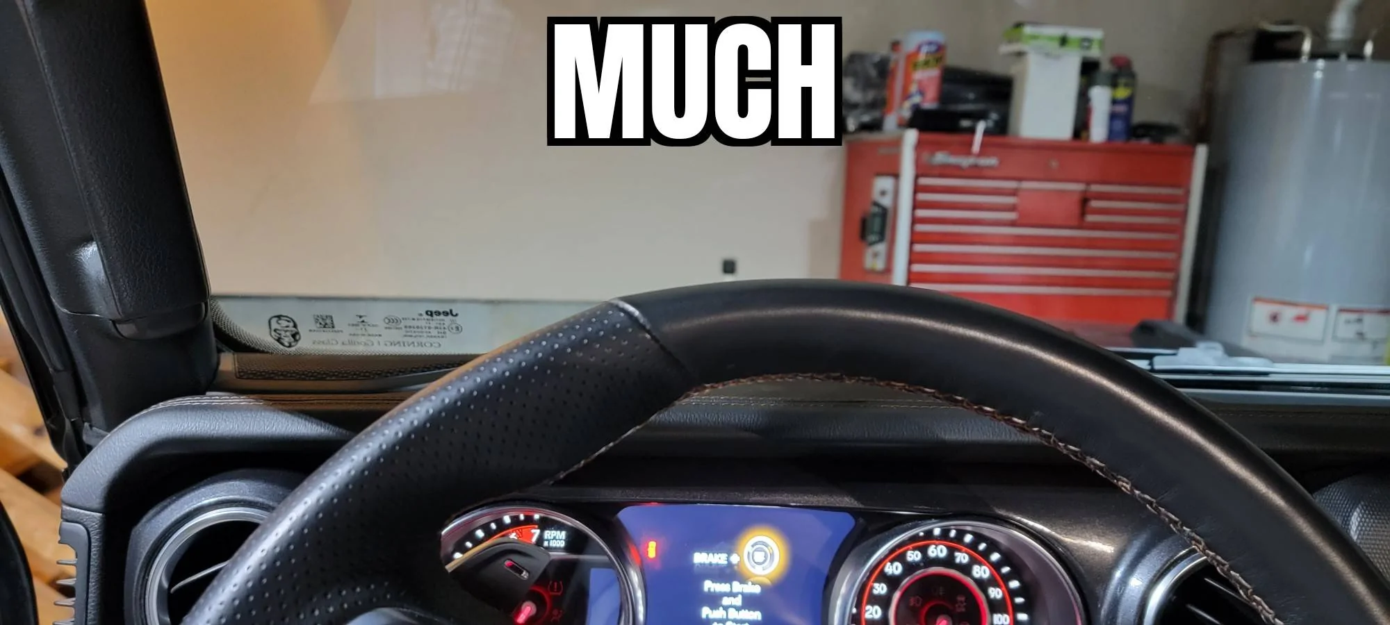

Maybe I don't know what to expect. What is a typical amount of slack, please?
Define slack. The dead spot in the center where caster should pull you forward but it doesn't?
Or the amount of steering input needed to make a steering change?
Ron Texas
Jan 19, 2023
329
291
23 Rubicon
Slack is how loose the steering wheel is when the engine is off. It's the amount the wheel may be turned with minimal force.
