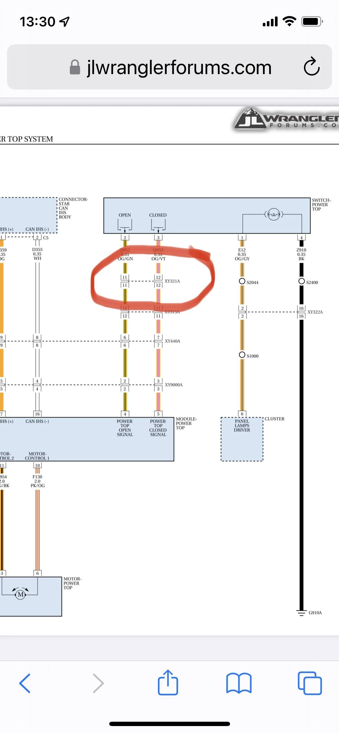

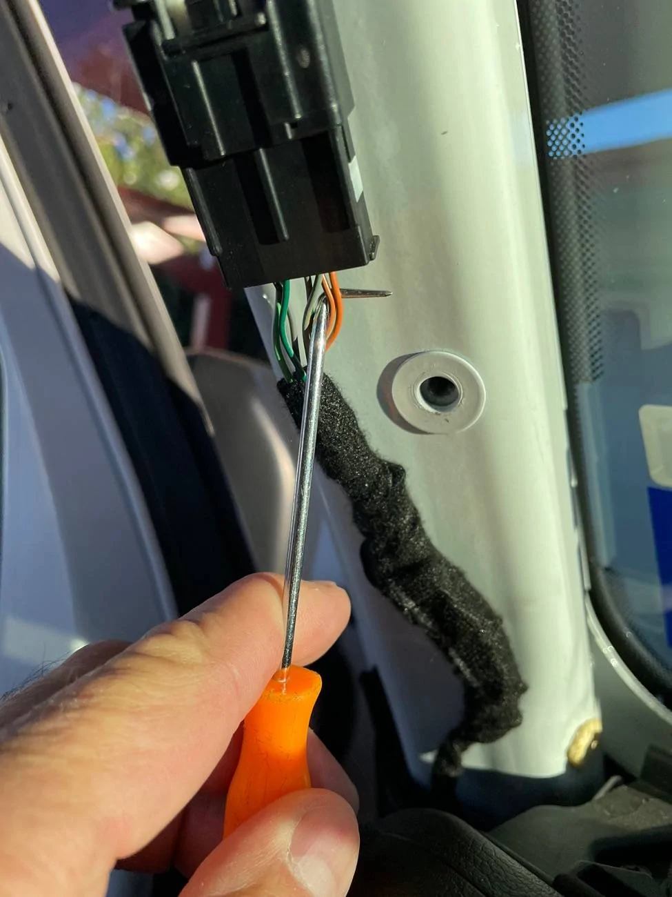

The two wires aren’t available from Jeep, you would have to change the dash harness to get them from Jeep. Not a big deal to just add the wires yourself. They run from the connector in the A pillar down to the connector in the kick panel on the drivers side.
You have to pull the grab handle and look for wires in the bottom half of the connector, cavity 11 and 12 seen here.
Link to the wire diagram.

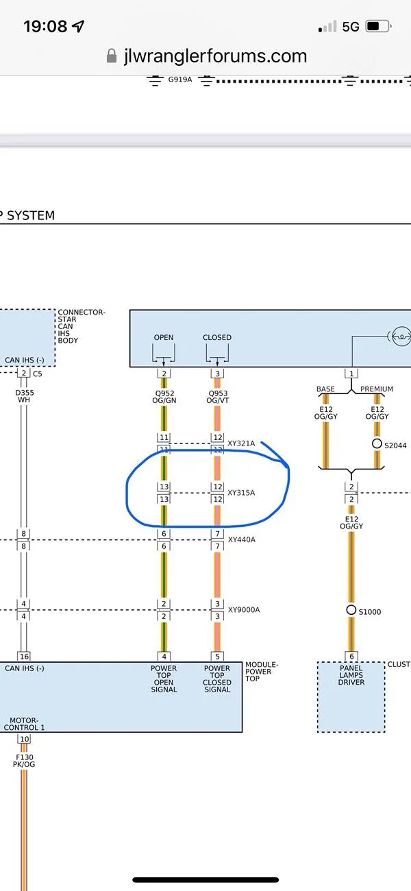

I know this thread is old but after scouring the internet, your info is the only valuable info I can find on adding the SOT. We have it on and installed along with the header/button, however, we do not have the 2 orange wires behind the grab bar. I know they need to be added and ran down to the kick panel but where exactly in the kick panel do they go to? Thank you!!

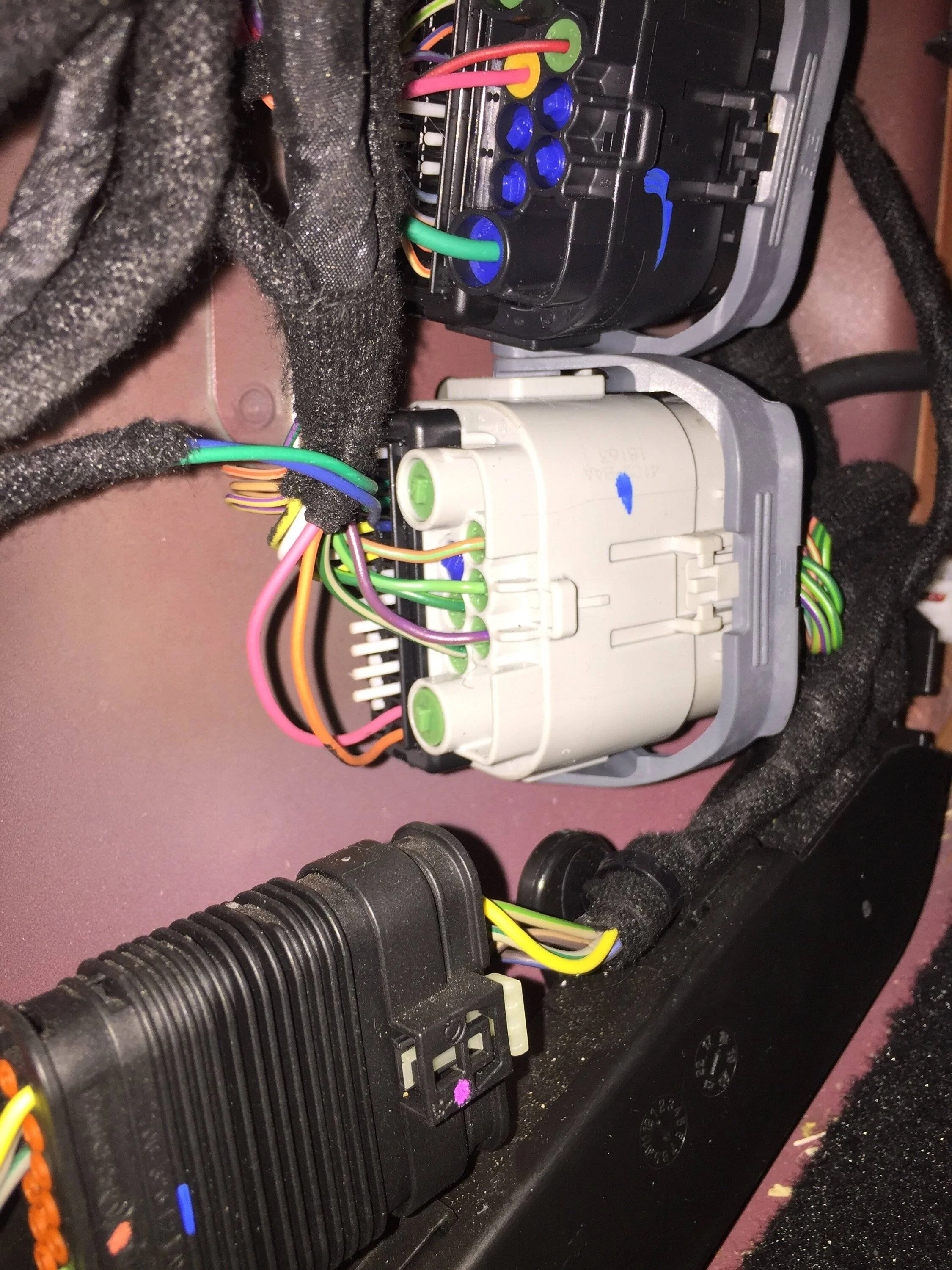

Those two wires go to the xy315a connector in the drivers kick panel.
Jeep Wrangler JL Sky one touch install 15E5DECA-9B12-4A1D-B5CB-154A23CB73E4
The white one in this picture, the blue and green wires are the ones I installed for my SOT to work. What year is your Jeep? There was a change in the wire diagram in ‘21 or ‘22. The diagram posted above is for an ‘18.

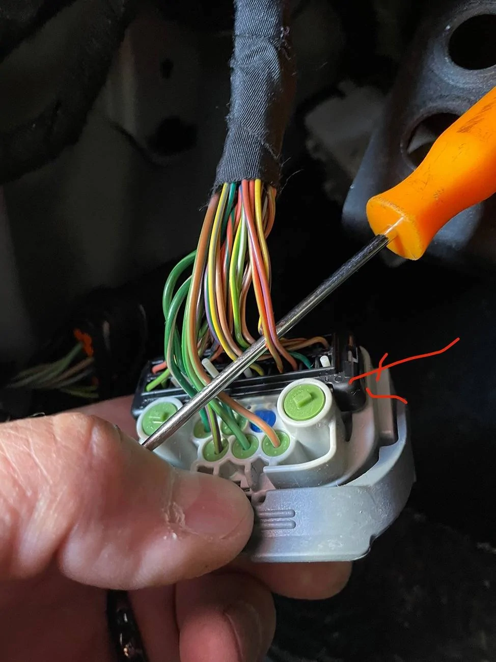

The trigger wires are in the driver’s side A pillar and the run down to the connector in the drivers kick panel.
Jeep Wrangler JL Sky one touch install IMG_4267
Jeep Wrangler JL Sky one touch install IMG_4262
Jeep Wrangler JL Sky one touch install IMG_6145
Verify you have those two wires in the lower section of that connector.

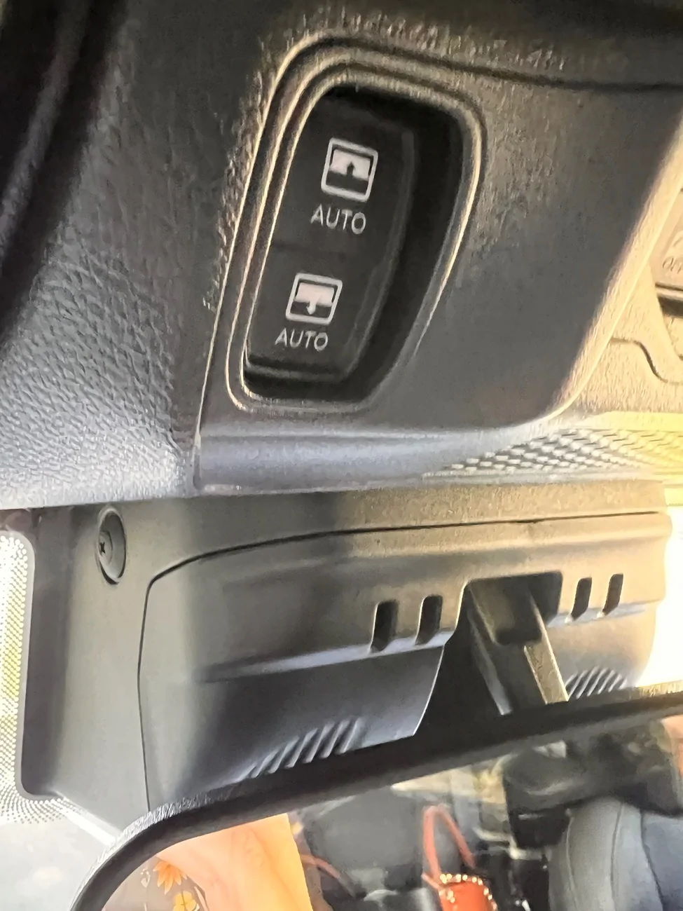

Reviving an old thread. The SOT button decided to come unclipped to its resting place. I just got the JLUR on Saturday and this happens Sunday. Brand new 2025 had 12 miles on it. How can I just reinsert this into its resting place?
Joe, that’s a weird one. I would take it back to the dealership and have them fix it under warranty.
