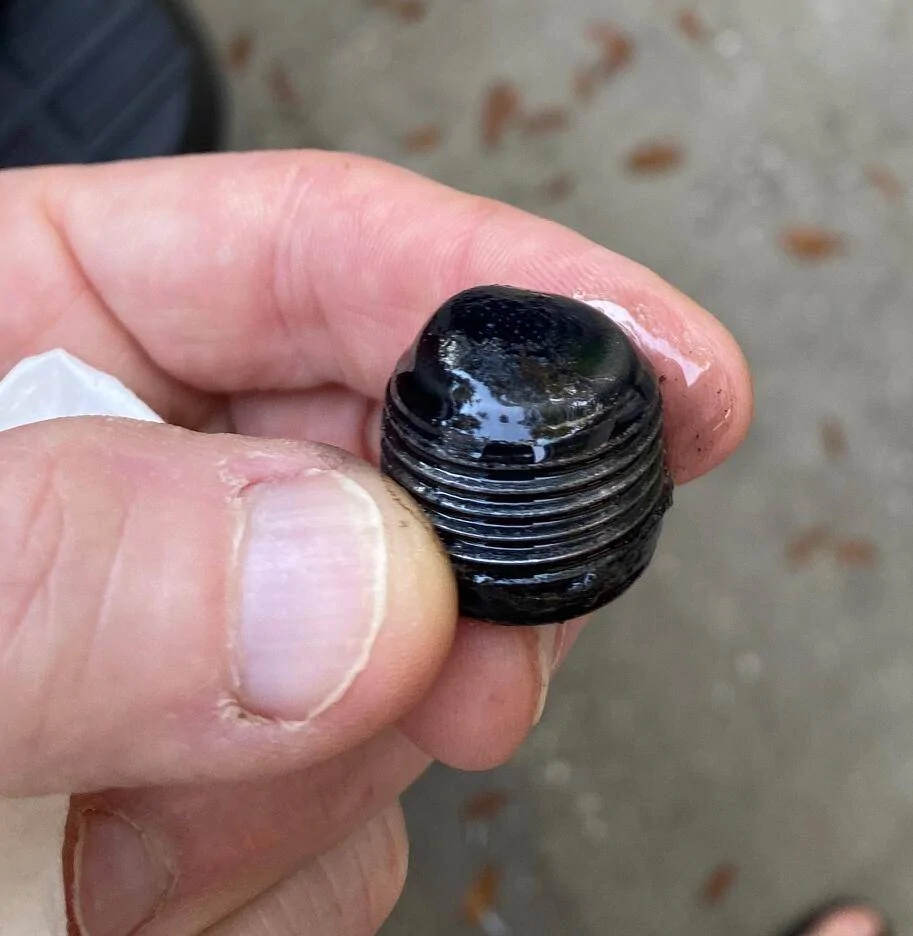

When I regeared my rear axle I had .004" backlash and the noise didn't appear till months later. I changed the diff oil last week had a little metal dust on it, but not much. This is my first diff oil change since my 500mi break-in.

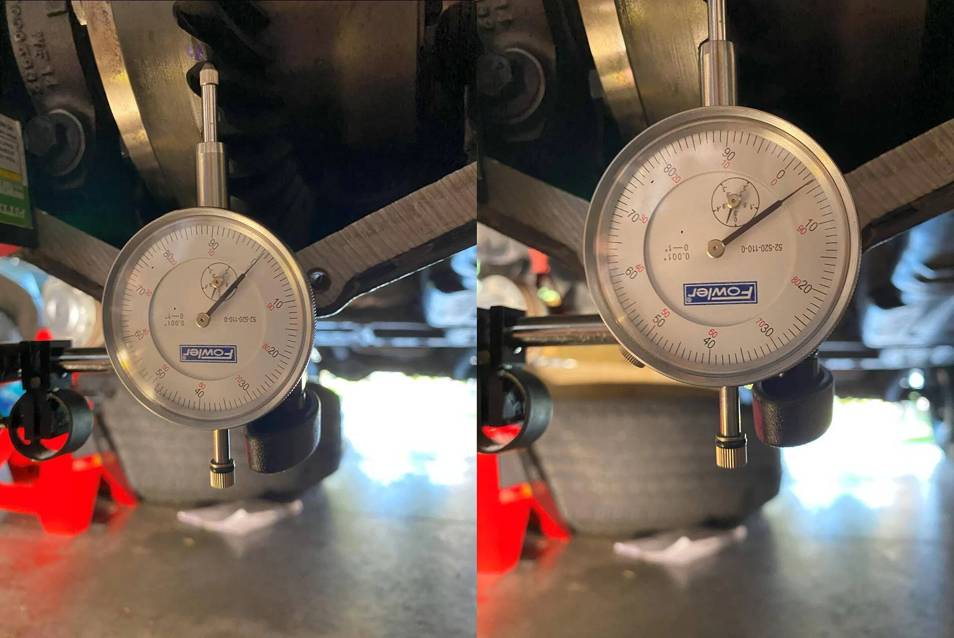

Here are my lash measurements as well as where the indicator is placed on the tooth.
Jeep Wrangler JL Shuddering sound at 70mph 1739493809854-lt

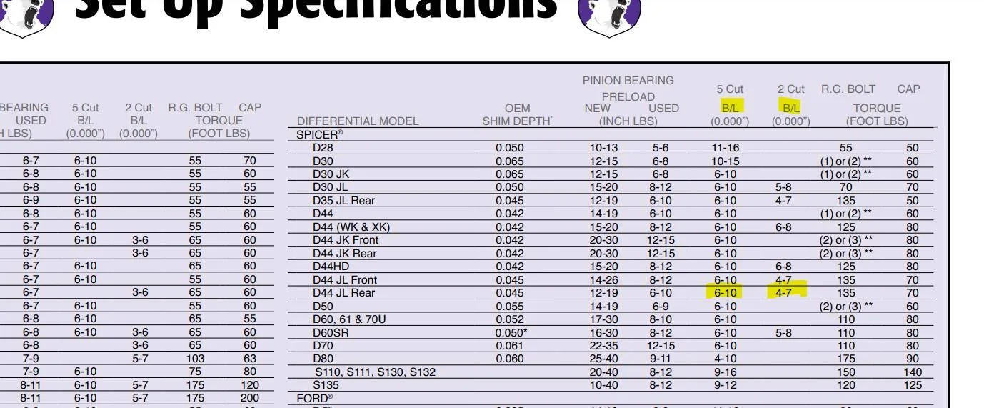

that backlash was way too tight. Should have been around .006 - .008. The amount of metal on that plug is about normal after break-in though. what does your ring and pinion pattern look like? I think you will have long term issues with backlash that tight.

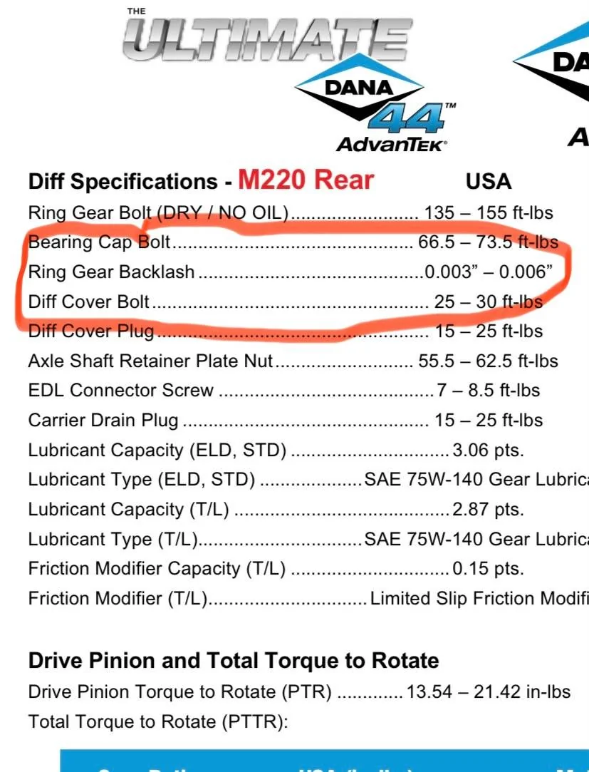

The spec is .003-.006 from the Dana rebuild sheet.

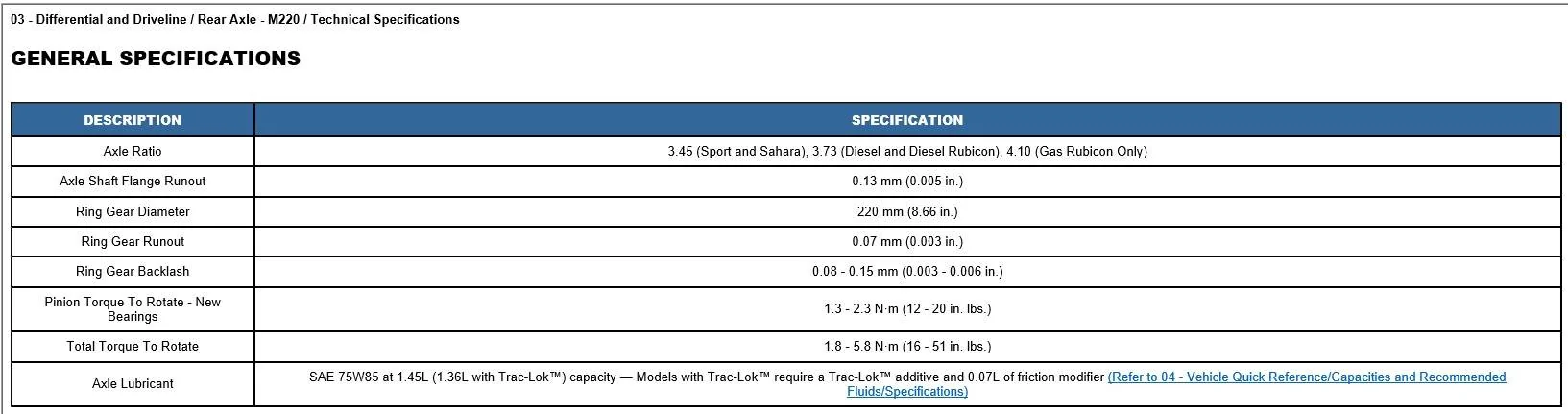

From the Tech Authority (factory OEM) Service Manual.
Jeep Wrangler JL Shuddering sound at 70mph Diff specs
depends if you used oem dana gears (2-cut) or aftermarket gears (5-cut). I assumed if you regeared, you used aftermarket? 5-cut will require a larger backlash.
I just learned something today. Thanks for that.
